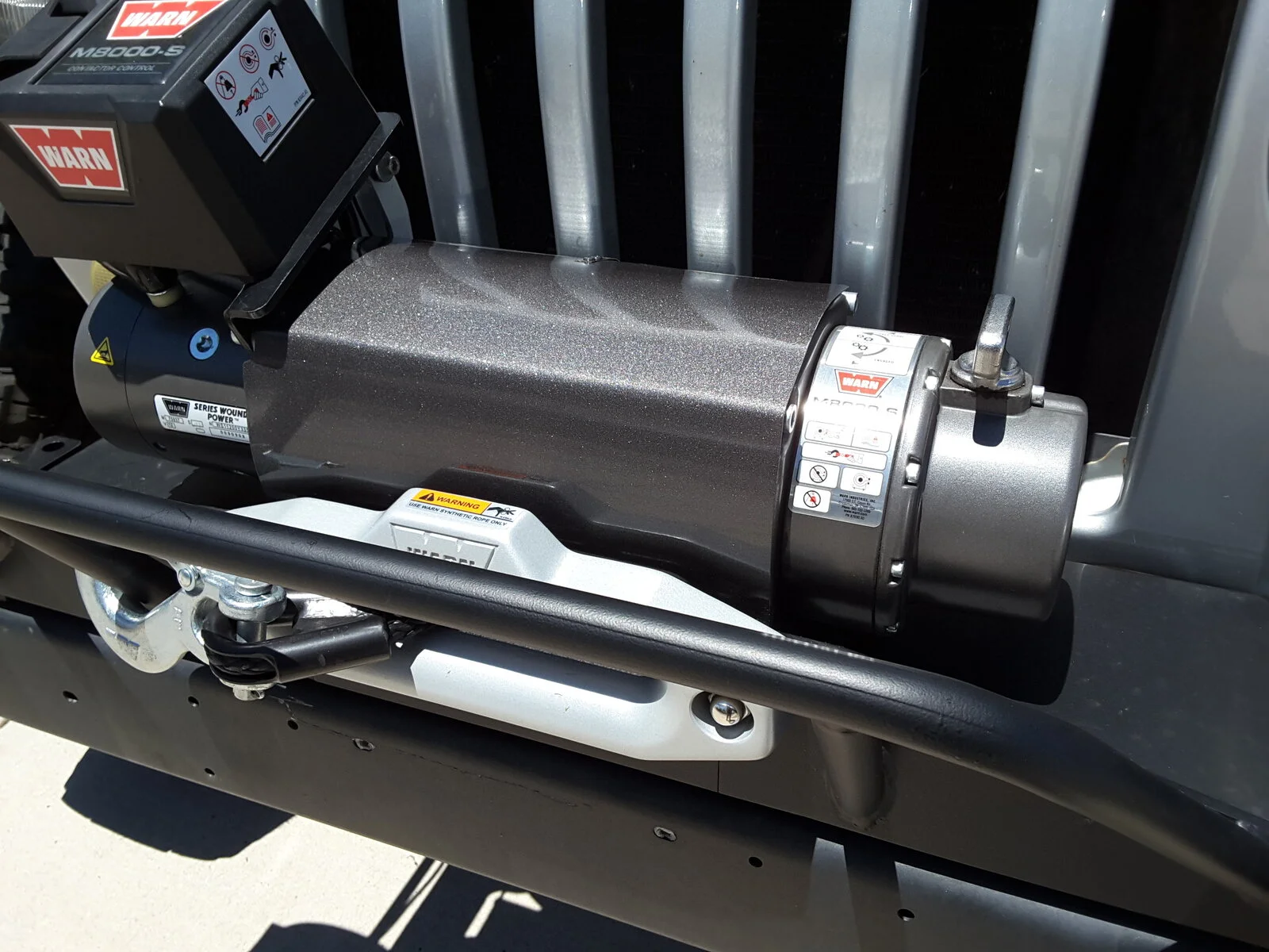

I did the same thing using light gauge steel, painted to (almost) match the winch. I've had it on for a couple of years and it has held up quite well. Keeps sunlight off the synthetic line and doesn't trap moisture. I haven't had any issues with fading on the parts that are uncovered.

Man that looks sharp. Good job!
