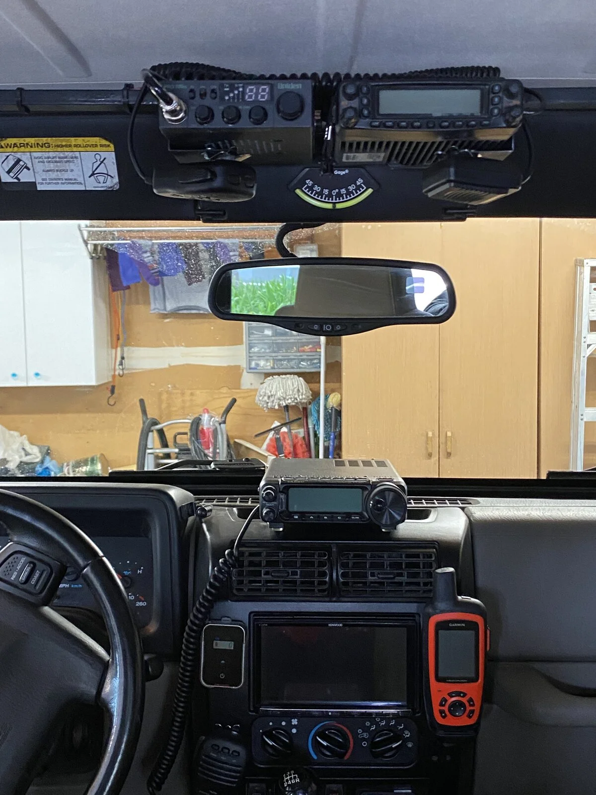

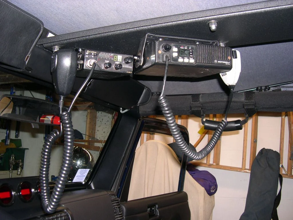

Damn. I could imagine 3 radios, yours might look worst than this:
Reactions: Blondie70 and MikeM
I have two radios installed now, but maybe you're right. To fit three I think I might need to go smaller.
For the top of the Arizona Rocky Road mounting bar I'm thinking of buying a President Bill CB (4.02 W x 3.94 D x 0.98 H) to be mounted next to a Midland MXT275 GMRS (5.25 W x 5 D x 1 H), with my spare Yaesu FT-90R dual band ham radio put back into service and centered underneath (3.9 W x 5.4 D x 1.2 H).
Its organizing the mics that will be the challenge.

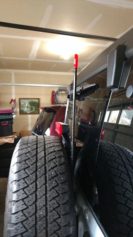

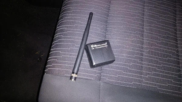

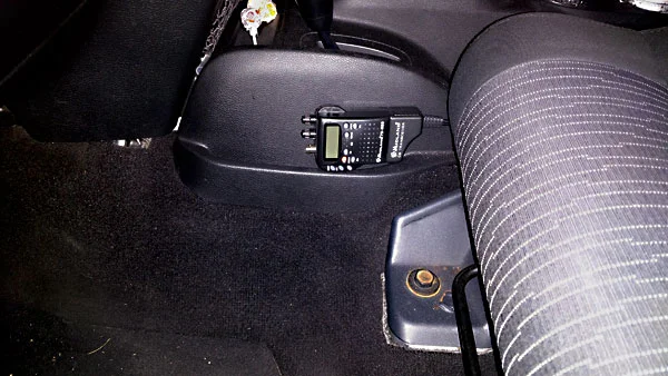

You might try this for the CB it works well for me I can not tell any difference in transmit/receive and yes that is the entire cb hooked up to a rear mount 3 foot firestick Have had almost 6 miles line of sight rx/tx. It is held in place with Velcro to the side of the emergency brake housing easy to access but out of the way,
