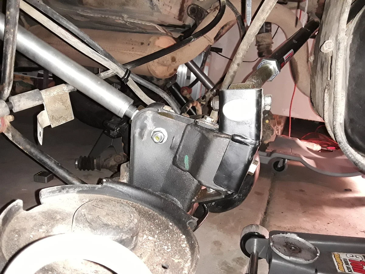

Around here we usually tell people to pull their springs out and cycle their suspension with the frame on jack stands to check the full extent of travel...but if you're just putting on a 2" lift with a stock track bar, stock length shocks and stock tire size, I'd have a hard time thinking of anything that's going to hit in front. Every lift I've ever installed though had a track bar bracket in the rear that sticks up a couple inches from the axle, and that might be worth checking. Mine is about 1/4" from the floor with 2" bump stop extensions.

Yours will be straight up from the back of the bracket, not bent forward like mine, but it does stick up a couple of inches from the stock axle bracket.

You can probably get away without the bracket, but just be aware that your rear axle will be off center a bit. Another option would be to get an adjustable TB. If you install the bracket you'll want to add 1" bumpstop extensions to the rear or the bracket could pinch the fuel pump wiring harness if the rear bottoms out.
