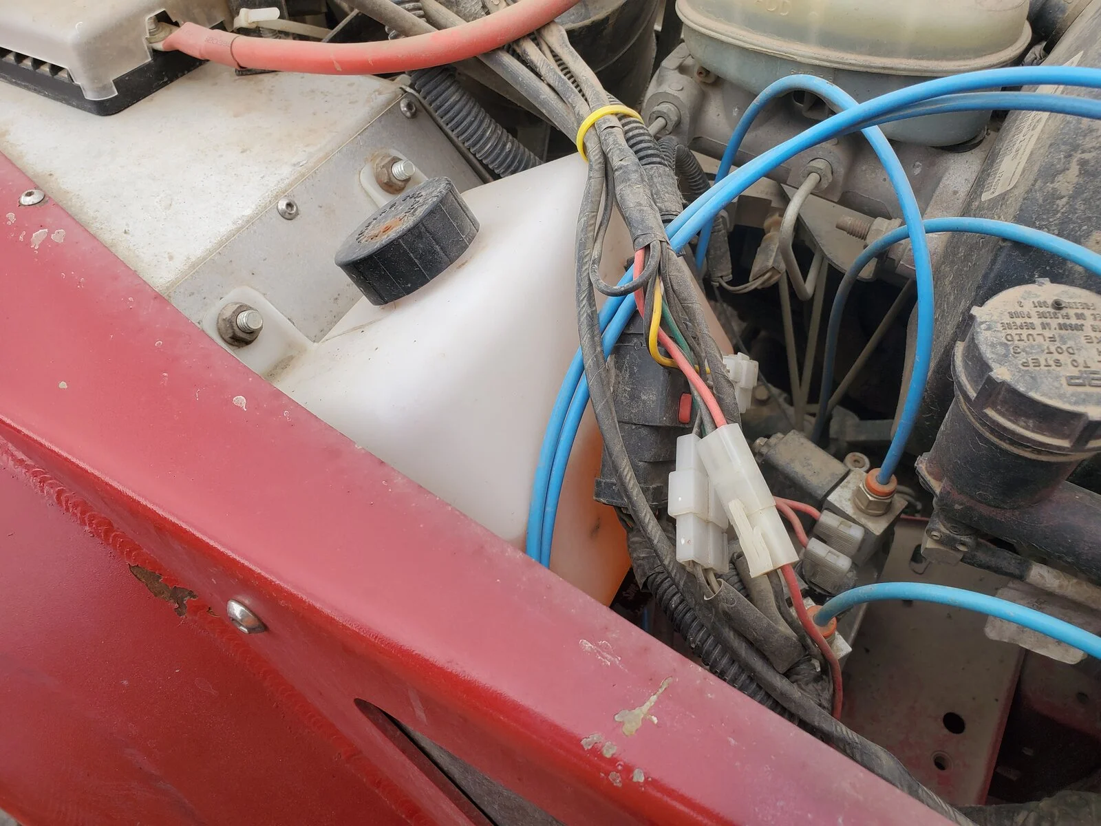

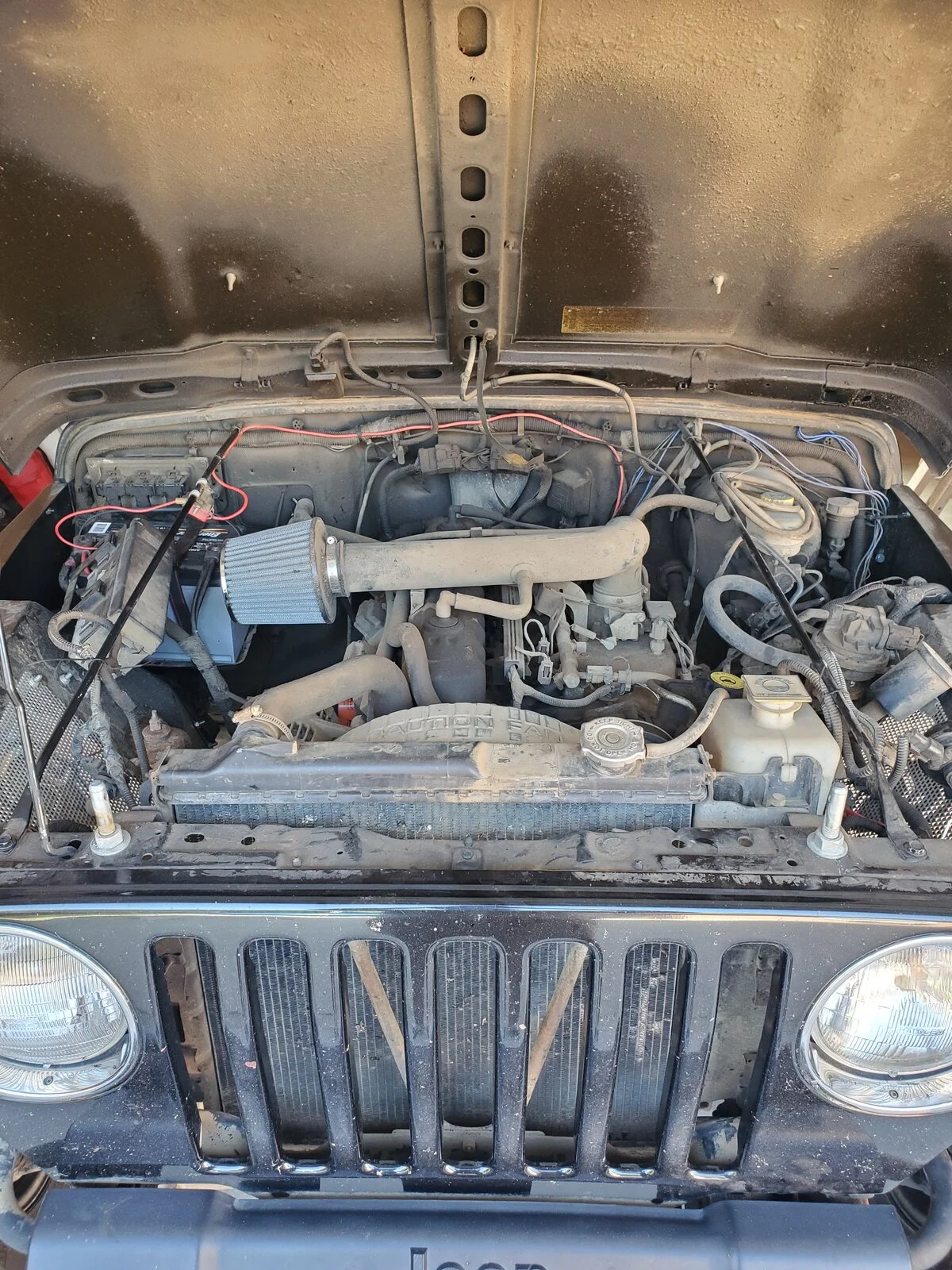

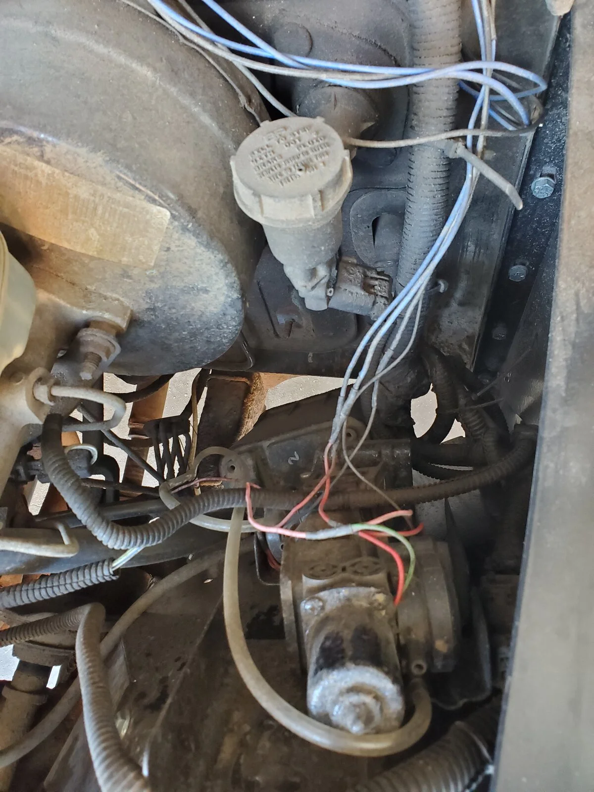

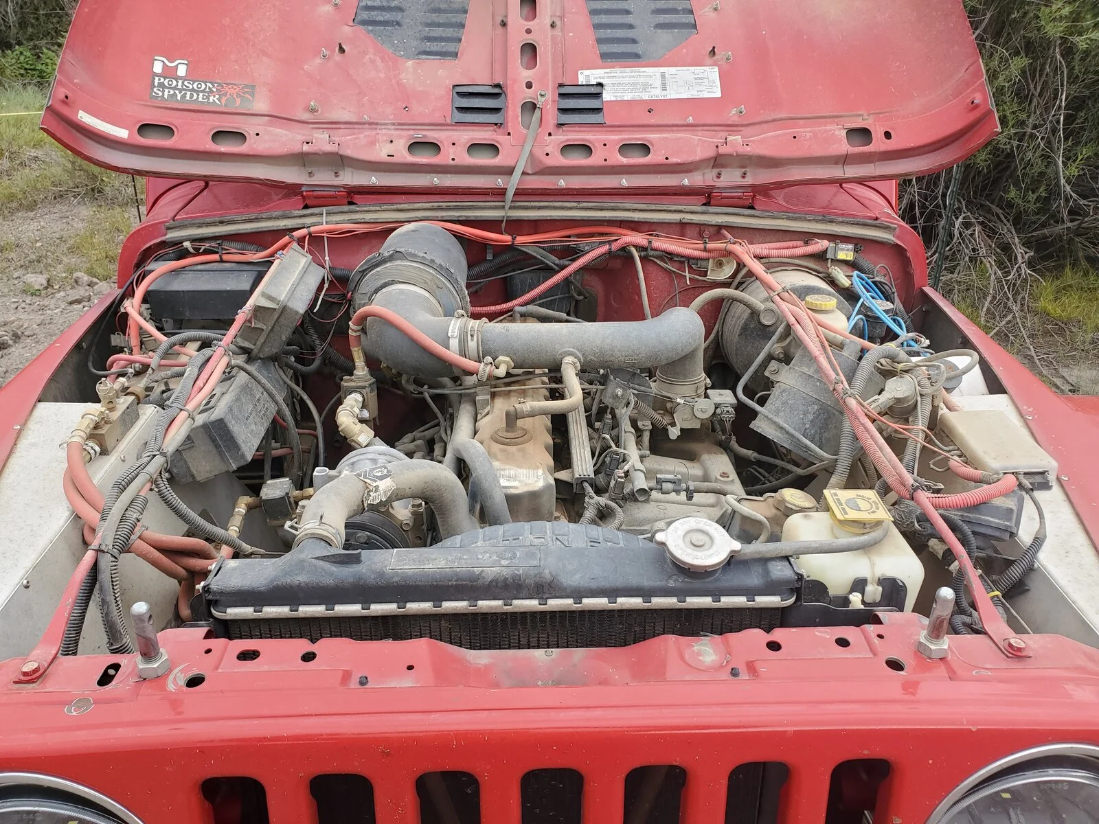

I had to opt for a much smaller washer bottle. The evap can I twisted/bent the original bracket so it would fit, same with the PDC
I don't have the PS inners but I have the JCRs. There was no way I was going to fit the stock washer bottle, still haven't replaced it. I only have rubicon locker pumps which I was able to fit on the drivers side where Tworley mounted his washer fluid bottle my big evap canister is mounted lower than them on the drivers side inner fender. It looks like the PS inners take up a lot more room under the hood than JCR but maybe this'll help.
