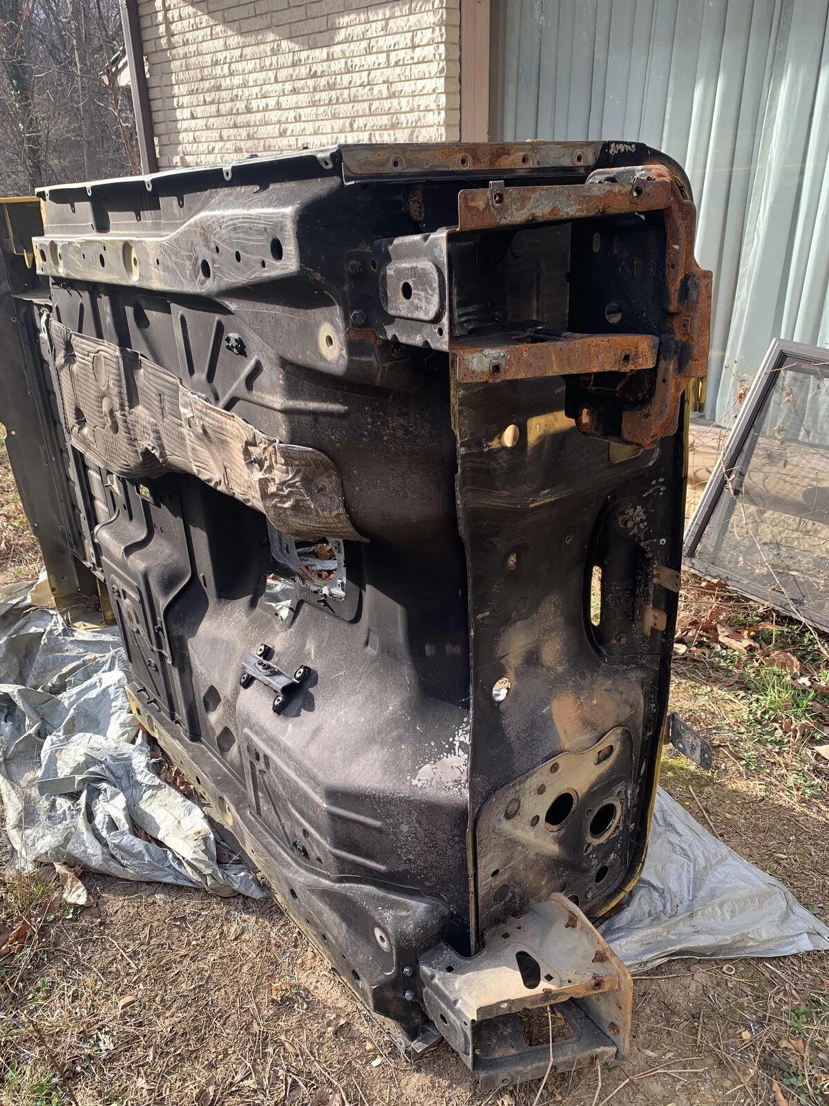

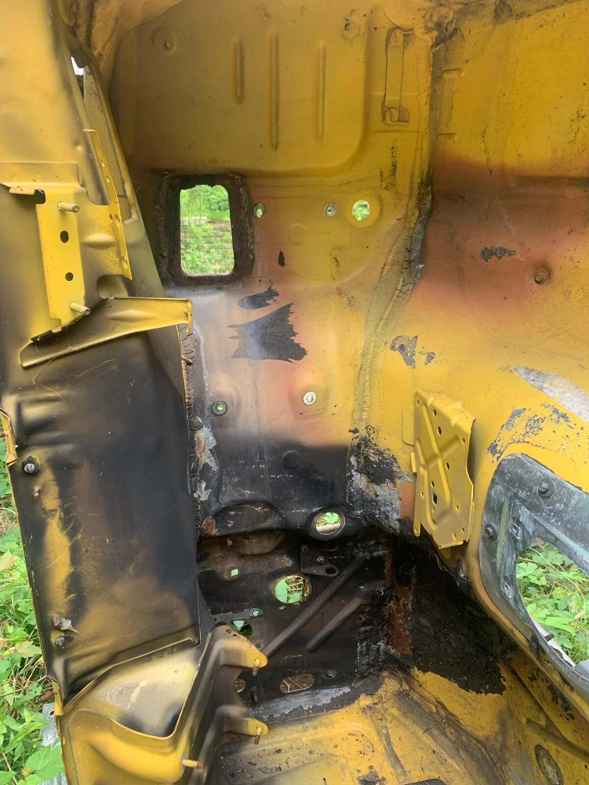

O Offline246 TJ Enthusiast Original poster Supporting Member Joined Oct 31, 2019 Messages 158 Location NorthEast Jun 29, 2023 #1 Hello - looking at a potential donor for a tub swap. Donor jeep had a fire - no real details available but I do have a couple of pictures. Any thoughts on if this is an issue?
CMBD Just shy of full retard... Supporting Member Joined Jul 1, 2021 Messages 1,173 Location CA, WA, or OK. Jun 29, 2023 #2 Doesn't look like it got super cooked. The bottom looks really clean. Whats the rest of it look like?
Irun A vicious cycle of doing, undoing, and re-doing! Supporting Member Joined Oct 31, 2019 Messages 8,415 Location Virginia Jun 29, 2023 #3 This doesn't look bad. If it had gotten hot enough to warp the tub more paint would be burned off. Reactions: TheBoogieman and Apparition
O Offline246 TJ Enthusiast Original poster Supporting Member Joined Oct 31, 2019 Messages 158 Location NorthEast Jun 29, 2023 #4 CMBD said: Doesn't look like it got super cooked. The bottom looks really clean. Whats the rest of it look like? Click to expand... The rest is super clean.
