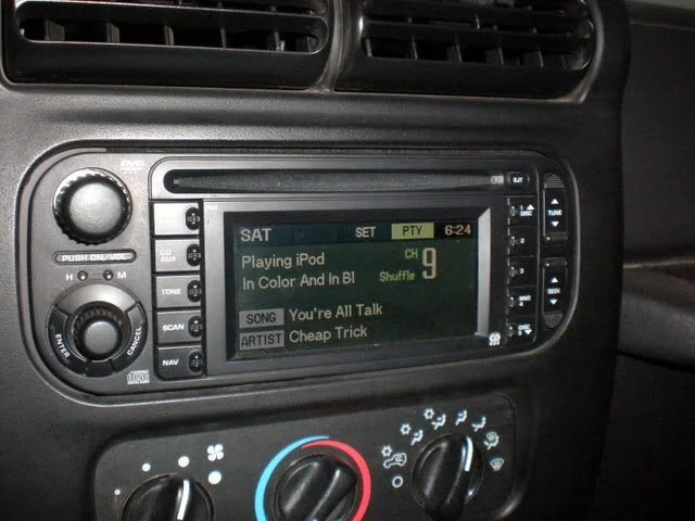

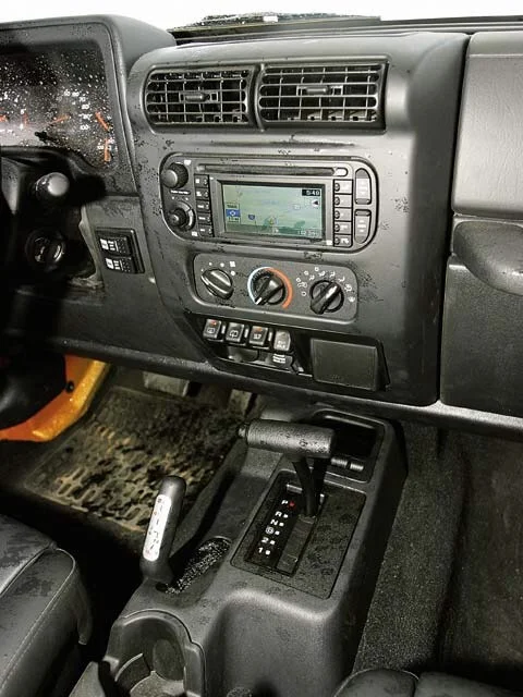

(Edit)NOTE: pictures are from google. Not my Jeep.
Wonder if the RB1 would have better specs than the other factory headunits. I will compare them agaisnt each other later when I have more time.
Unless someone else does it.
The RB1 looks so good and was in fact a factory option for the TJ and it came in the Viper too.
Going the RB1 route thought for me would equate to an upgraded radio head unit but still maintaining the factory specs for the dash which is impossible to beat IMO everything else looks cheap.

On what TJ was that ever a factory option? Really?
Had to be 03+ because im fairly certain is does not bolt into the 97-02.
But the question about which TJ had it as an option has got me looking around the internet. I could have sworn I had seen it mentioned as a factory option in a TJ in a magazine. But im looking with no fast results.
I see it as an option in the Grand Cherokees, but never the TJ. Either way, they want $1500+ for that antiquated piece of technology! Sheesh
