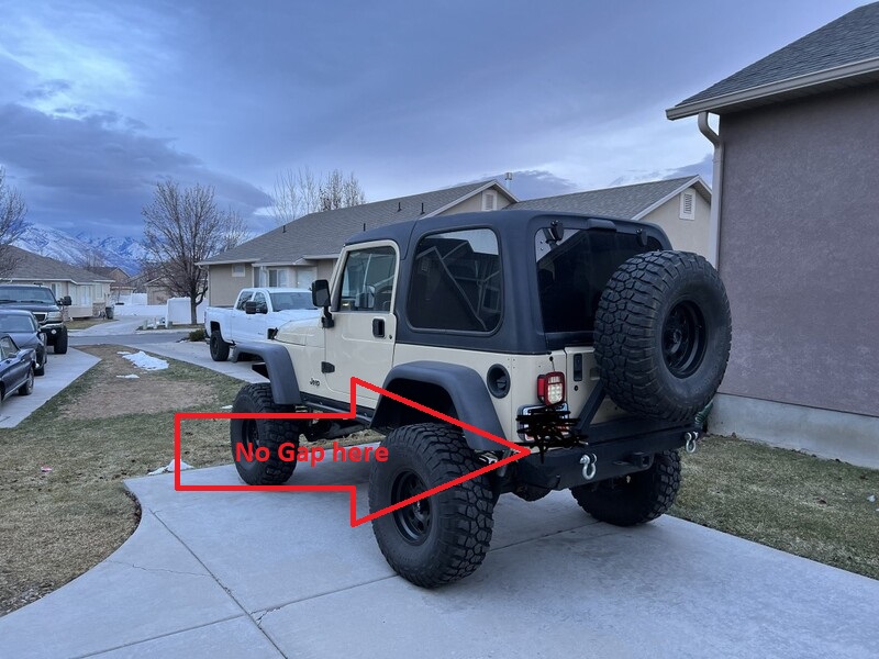

Hey guys, looking to purchase this TJ. I think it may have a body lift but I'm not quite sure. If it does, how much do you think it would cost to have a shop take it off? I'm a fan of the suspension lifts but something looks a little off and I feel like it's a body lift.
Agree, based on the space from the tub ( or lack of space) and rear bumper as mentioned looks like no.
It is a big lift from the looks of it though, not sure how much.

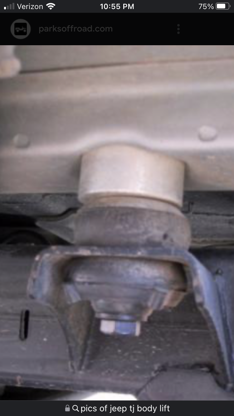

Can you get some pics from underneath or go look for yourself. Here are some pics showing body lifts for reference.
You can tell that Jeep has some type of long arm kit. Notice the lower control arms go to the front and rear skid plate.
I doubt this is a bolt on kit and probably somewhere in the 8-10" lift. Lots of modifications to get it to that point.
I bet if you can get some more pictures of the components someone more knowledgeable could figure out the brand or if it is totally custom.
The tires alone look to be 35's or even 37's.
That looks like a rubicon express suspension. Radius arm front with a panhad bar, 4 link rear with a panhard bar, full belly dropped skid which serves as the lower control arm mounts. If it’s using RE springs, it’s likely a 5 1/2”, as I believe that was the tallest kit they made. But it looks like it may be higher. Perhaps taller springs or spacers. There does not appear to be a body lift.

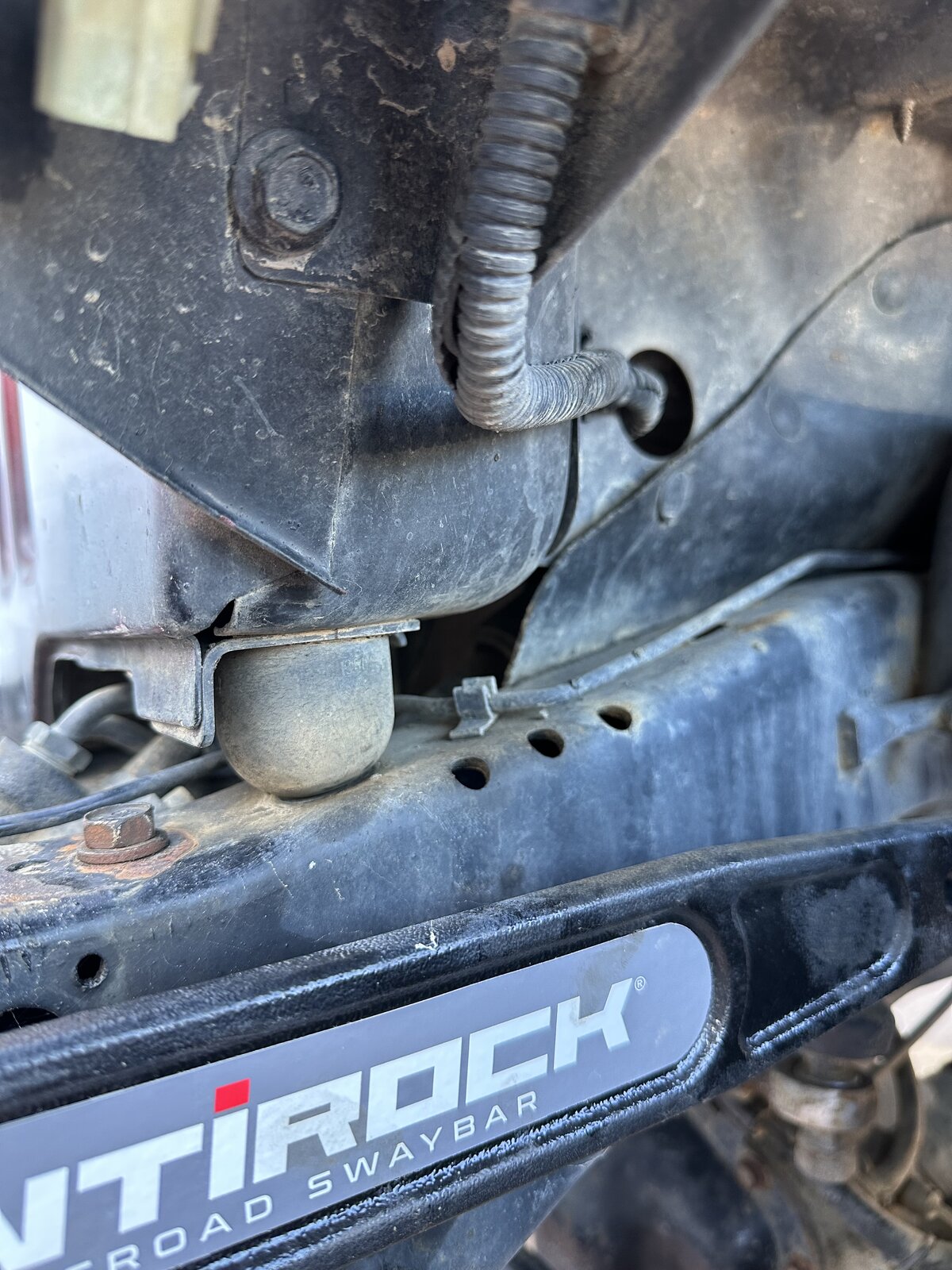

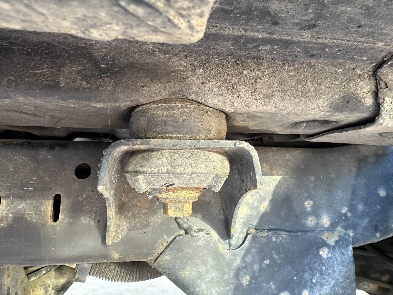

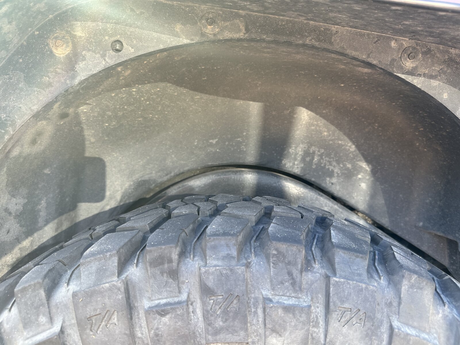

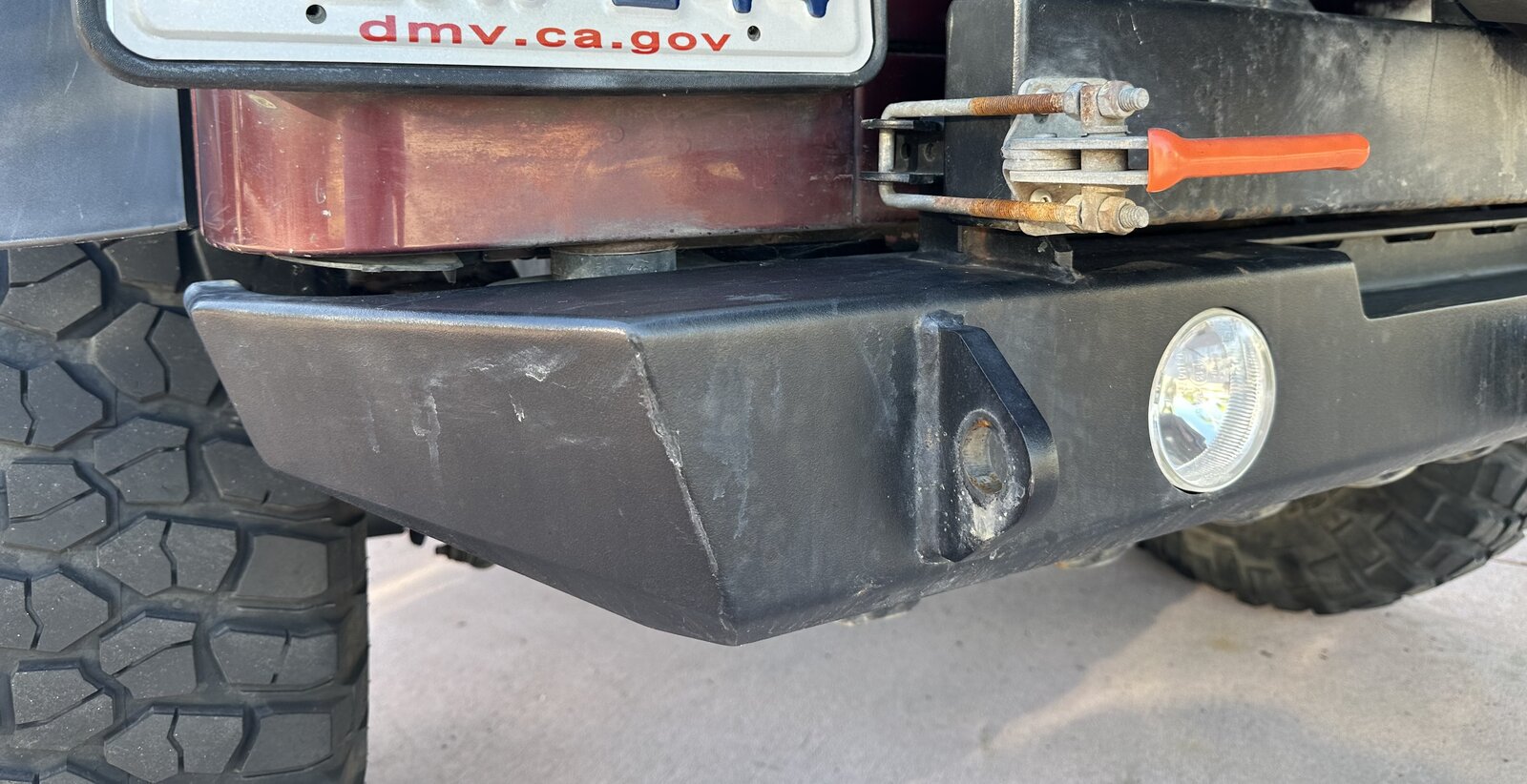

piggy backing on this thread to ask a similar question. I am currently in the process of taking off some old owners suspension and putting higher quality stuff on it. I am going with the 4 inch springs and 1 inch body lift on my Rubicon but I am second guessing myself on the body lift, I just need more eyes and confirmation. Mine doesn’t have a body lift right? The thing that is throwing me off is the frame gap from the tub in the rear wheel wells. Thanks in advance! Happy to take more photos
