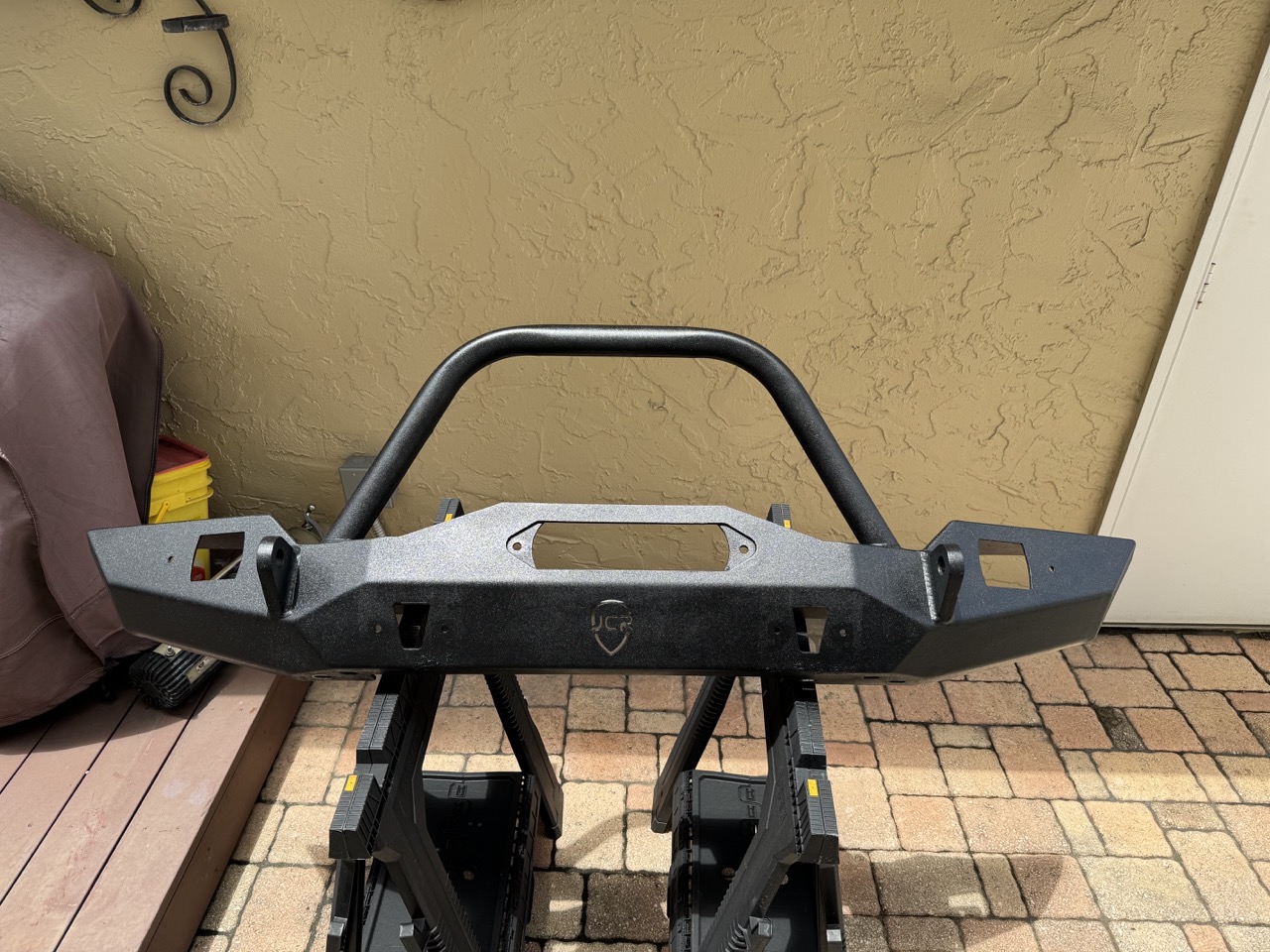

Got a fresh coat of bedliner spray paint on my JCR bumper. I don't love this bumper, its pretty big and bulky, but it's what I've got so I'll use it for now. Maybe I'll make my own at some point, or maybe I'll go with one of @Fluxor 's when budget allows.

Could have used a thicker coat, but I only had 3/4 of a can.

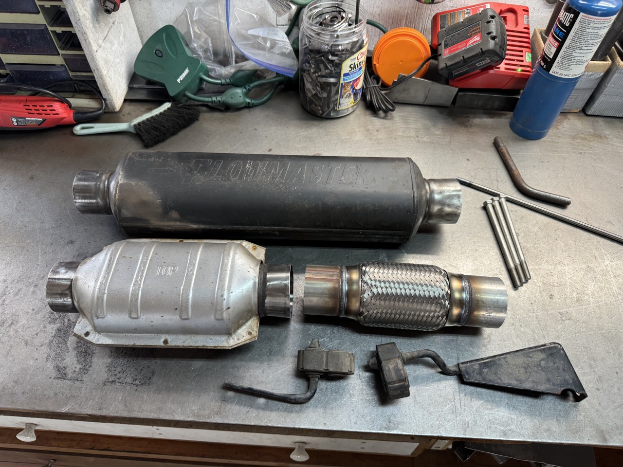

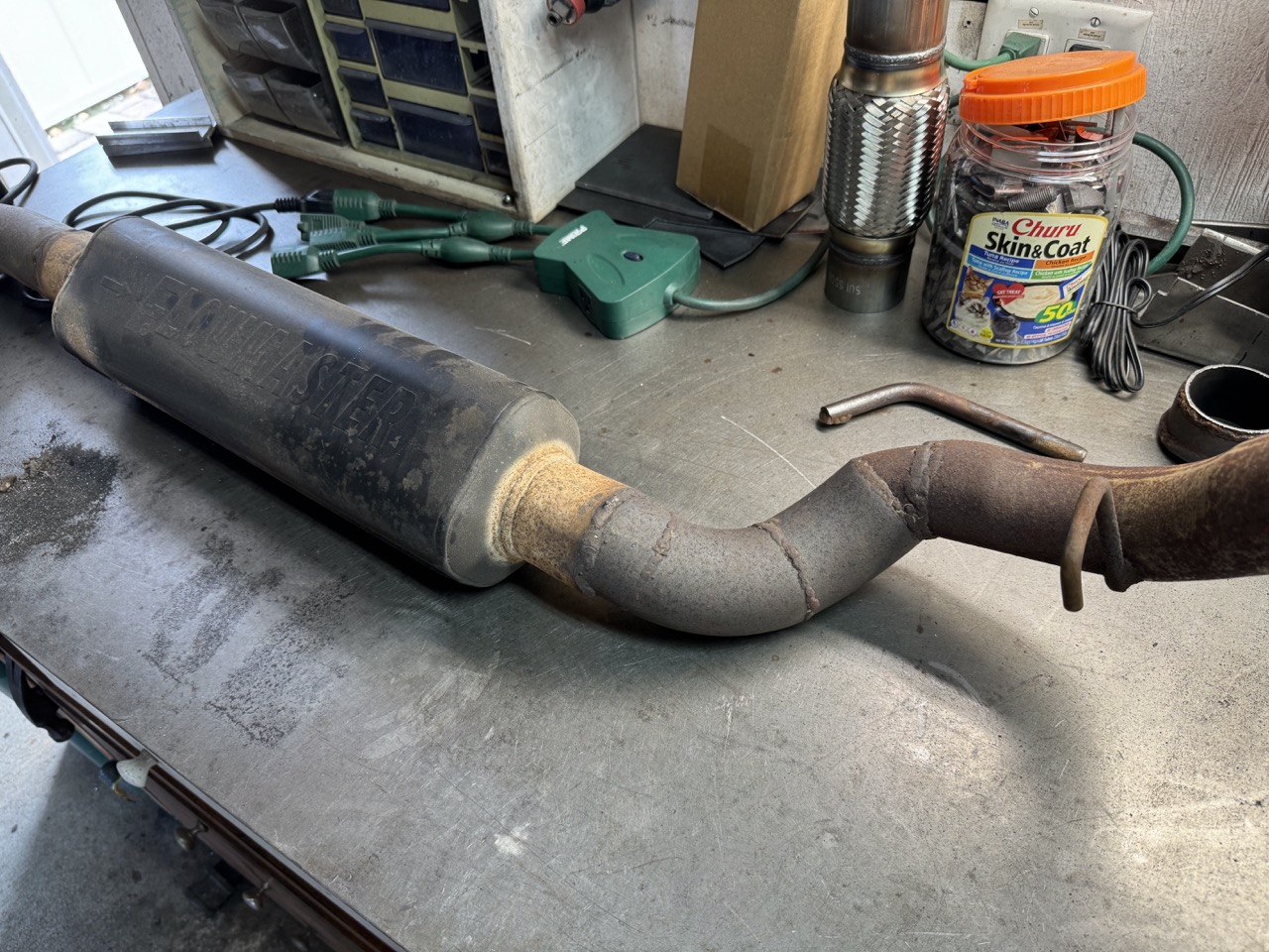

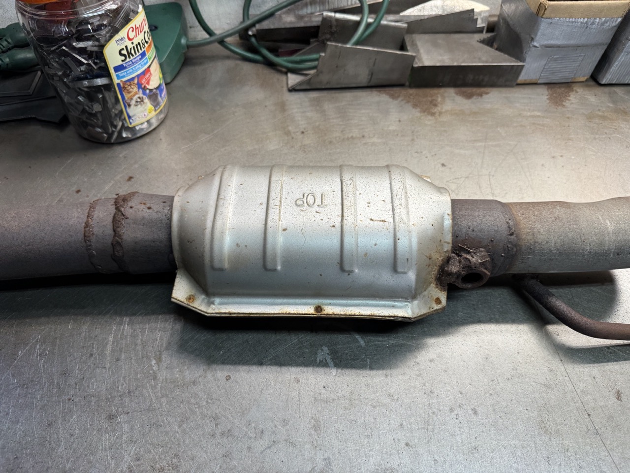

I dissected my existing exhaust to get the components I need out.

Still can't get over how much of a boogered up mess that cat install was, the shop wasn't even cheap! There was a bunch of filler wire on the inside of the cat where they put the o2 bung in too.

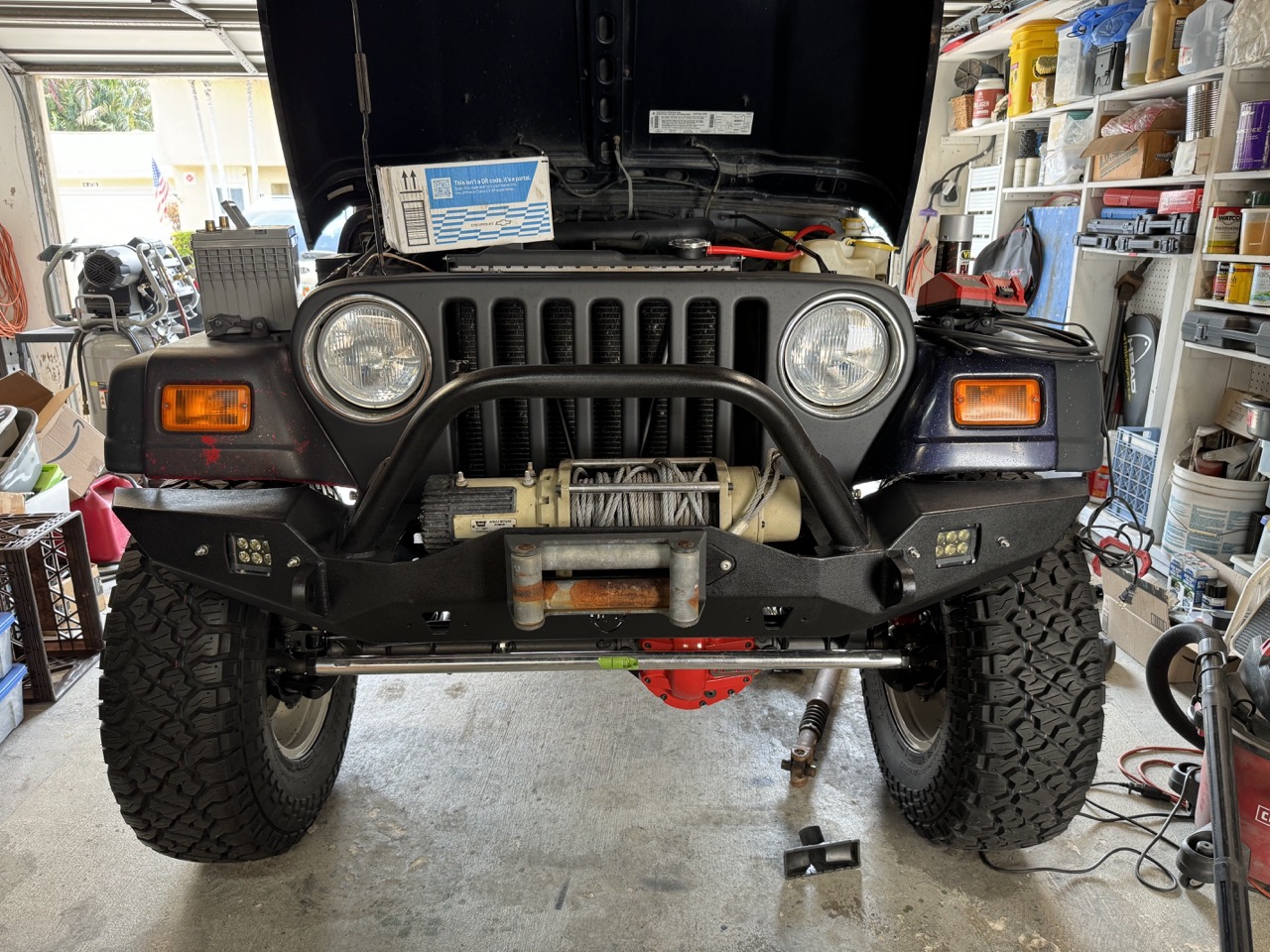

Threw the bumper on the Jeep, looks nicer than before after raising the frame up and closing the gap between it and the fenders.

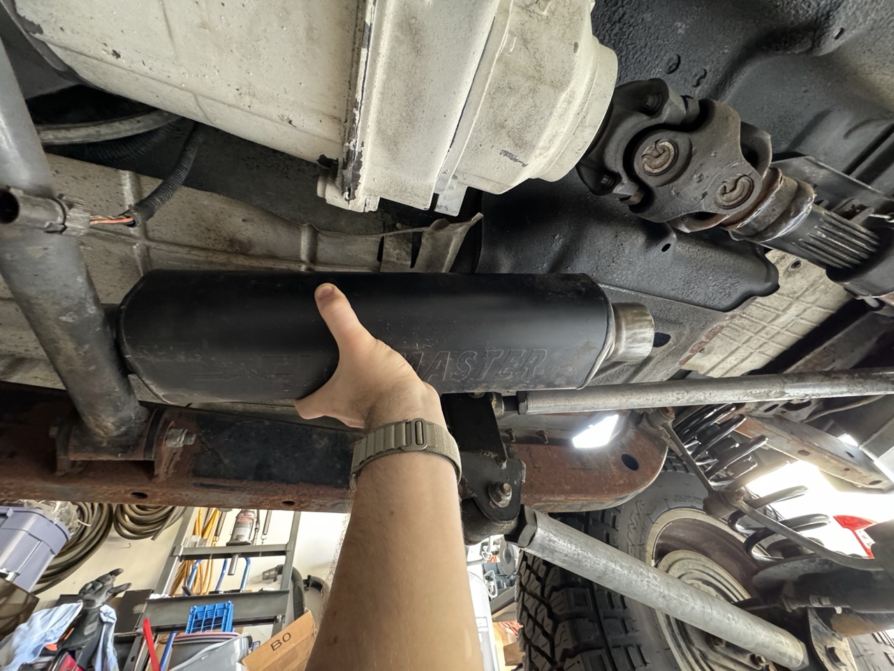

I was doing a little poking around and I think I have 3 options for locating my muffler. It's skinny, but fairly long.
First option would be to put it here where the factory cat used to live:

Next option would be to put it right after the transmission crossmember. It won't fit above the bar without basically touching the tub.
This could work, and its basically where I had it before. Because of the length, it would force me to route the exhaust up and over the rear UCA.
Nothing particularly wrong with that, but to me it makes more sense to route the exhaust between the UCA and LCA near where it mounts at the frame since those points are fixed. That could also make getting to the control arm bolts annoying though.

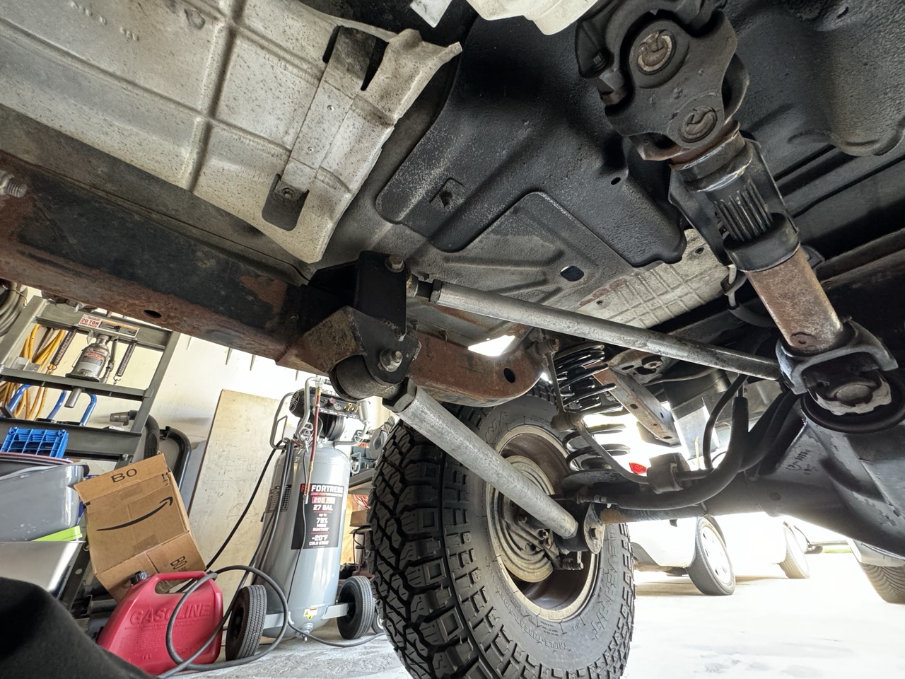

Last option would be to shoehorn it between the spring and the gas tank. This only makes sense because I'm missing a rear shock, but I am outboarding, so that would eventually be a non issue. The reason I like this is 1. I've read online (no idea if true) that the further back in the system the muffler is, the better it works, and 2. keeps the most heat away from the cab.

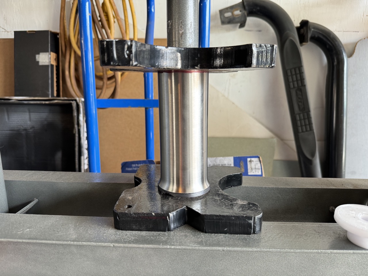

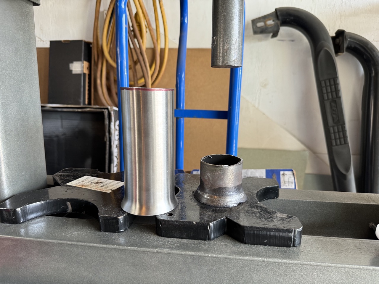

My biggest unknown was getting the flare made for the header connection. Since I got 2.5" tube instead of 2.25", I was able to just cut the flare off the old midpipe and use it as a tool in the press.
This worked surprisingly well. It's a bit less rounded than the original, but it looks like it will work just fine.
I was able to re-use the original flange as well, just had to squeeze it a bit in the vice and grind off just a little bit of material to get it to fit the tube right. Painted it as well.

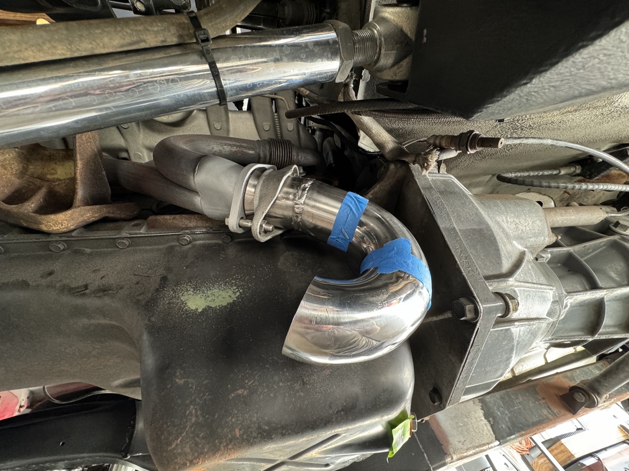

My welds are definitely not pretty. This was my first time welding stainless. In hindsight, I should have just gotten mild steel. Its a lot more difficult to work with.

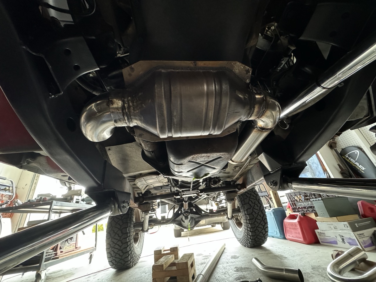

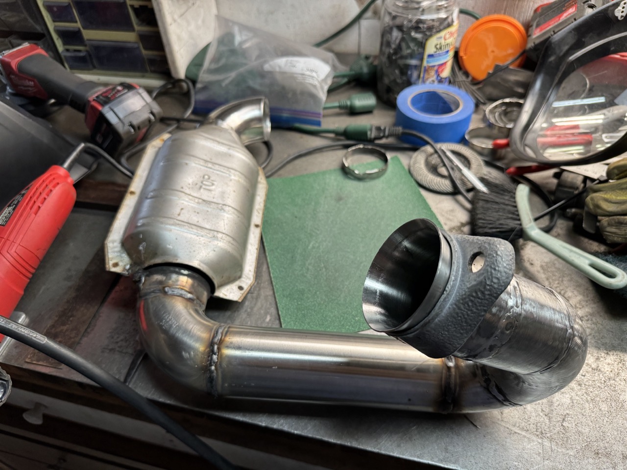

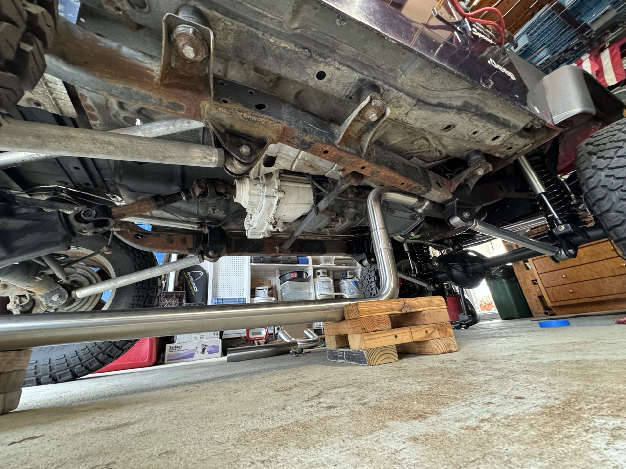

Here is the midpipe finished up. Lots of compound angles and curves so it had to come in and out a bunch of times to get it just right. As you can see, I opted to move my catalytic converter to underneath my oil pan. I'm hoping this will be ok, my rationale is that the newer TJs had cats right off the header, so this can't be any worse than that. Just trying to get heat away from the floor. If it doesn't work out, it shouldn't be that difficult to cut it out and replace it with a straight pipe.
Here it is installed. I got the pipe off the header tucked in really well so hopefully the driveshaft will clear it better than my factory one.

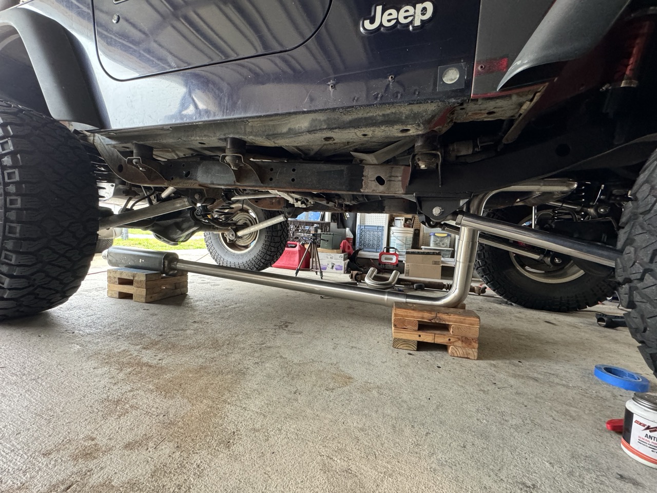

Next, I wanted to do some testing on muffler placement. First, I just slid some slip joint sections together to simulate an exhaust system, then put the muffler right at the end.

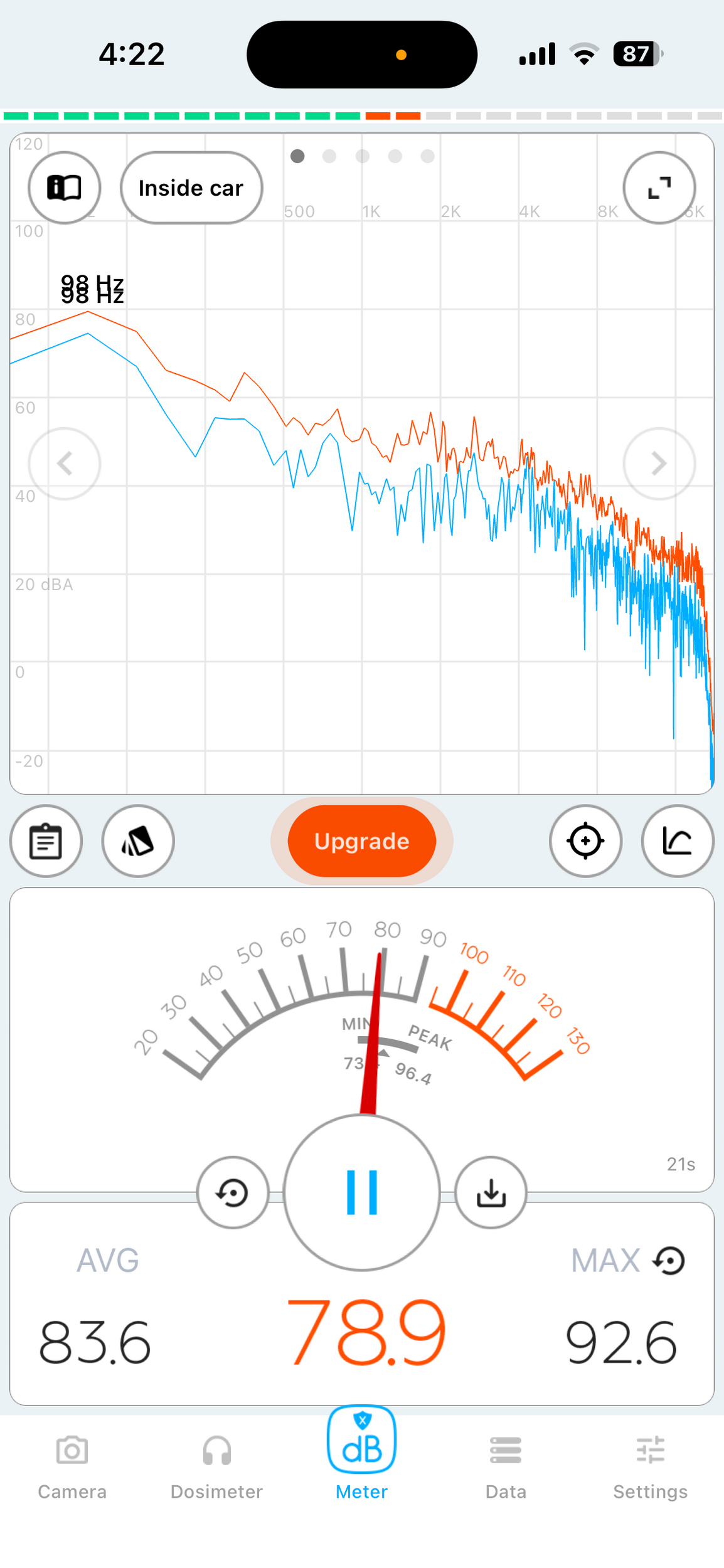

Test 1 audio results:
This was pretty uncomfortably loud actually, really resonated in your ears at idle. Not a fan.

Test 2 audio results:
This was noticeably more pleasant at idle, but was still too loud. It also had a distinct drone slightly above idle, maybe 1400 rpm or something, I didn't look.
After that, I revved the engine a few times and accidentally blew the whole system onto the ground doing that. To my surprise, though, the audio levels of an open exhaust after the cat was like almost exactly the same. It just sounded "gurglier".
Here is the audio from the open exhaust:
I don't really know what to make of this. I'm not sure if the muffler is literally doing nothing, or if the sound leaking out of the unsealed loose slip joints is invalidating the test. The muffler almost seems like a megaphone though considering the first test was loudest, or that could have just been a temperature thing.
