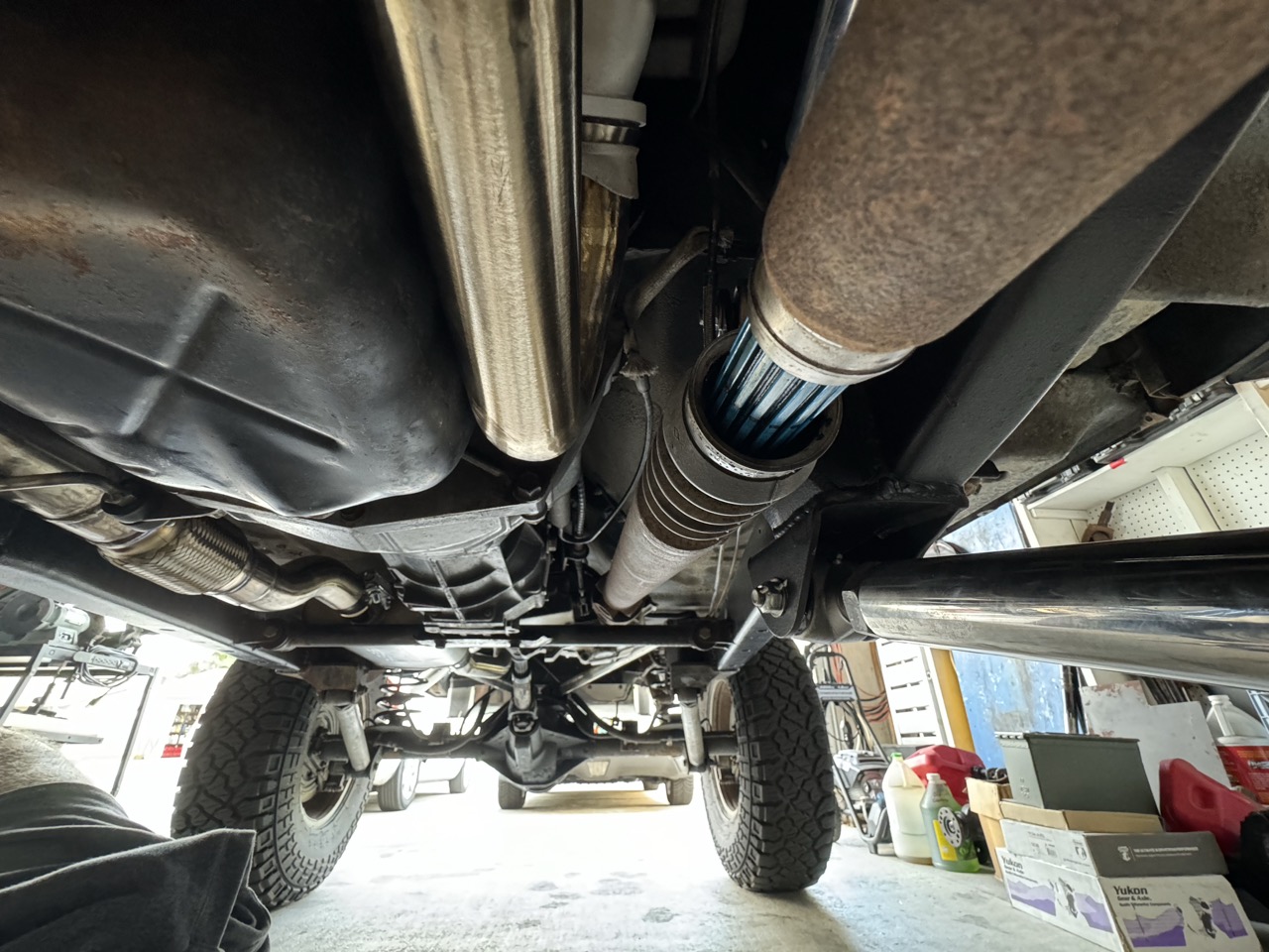

Got my exhaust all done today, glad to have that over with. That's it for the difficult jobs I think, only thing left to get it daily driveable is figure out the electric fan control.

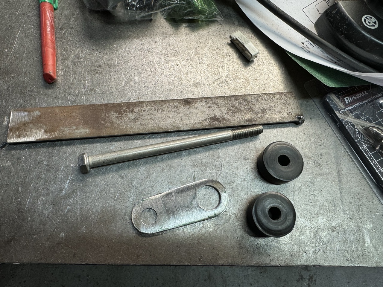

Made my own exhaust hangers out of some front upper shock bushings and a long stainless bolt. I wanted something more constrained than the factory two hole rubber hangers.

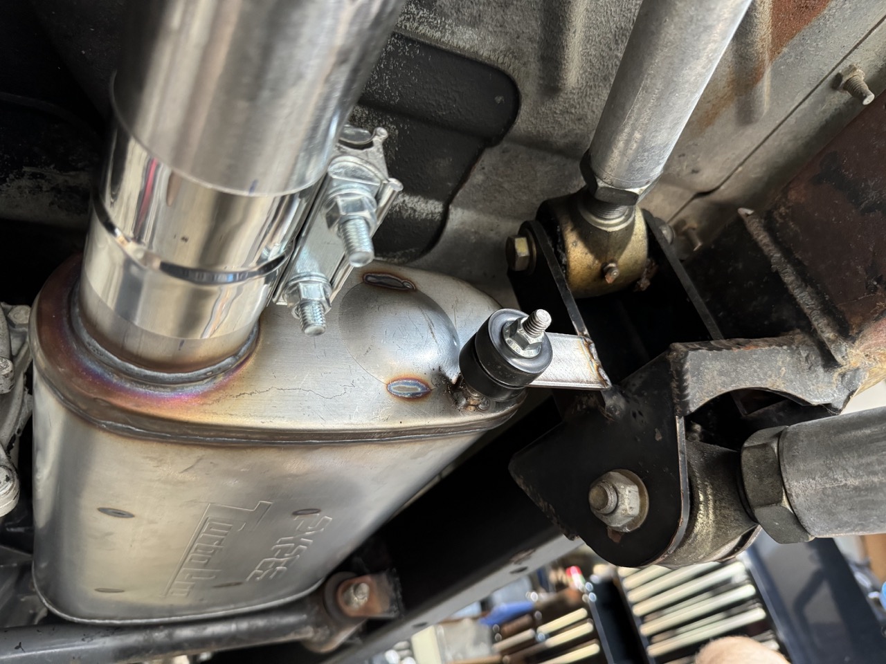

Same method for the muffler. I'm going to redo this one when I tackle the rear of the Jeep, want to make it bolt to the link bracket rather than be welded on. Makes it difficult to get the muffler in or out with it welded. It's fine for now.

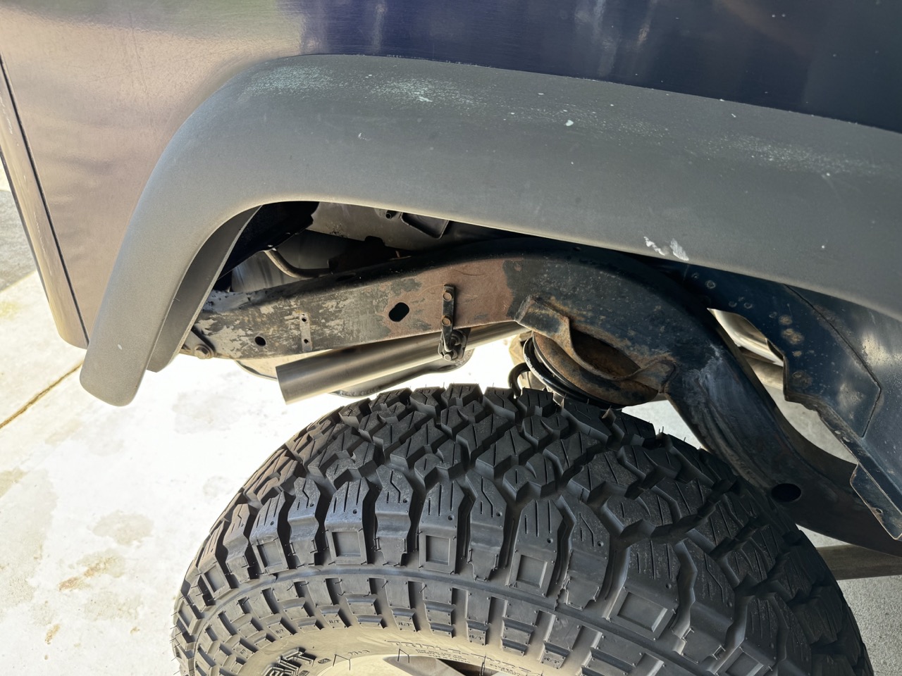

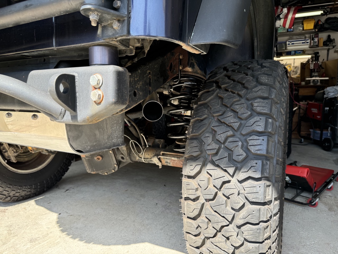

For the tailpipe, I just ran a straight tube right out the back from above the axle. Just wanted to keep it easy, it will probably need to change when the rear shock towers go in. It'll be a good test to see if this puts the pipe out of the way of rocks or if fumes get caught up in the wheel well or anything.

I ran the Jeep for a while in the garage to get everything warmed up. After about 15m of idling in my 98°F garage, with the cooling fan hotwired on low, I measured a maximum of 425°F at the cat, but a maximum of 225° on the heat shield. Idling isn't much load, but so far I like what I'm seeing. It really gets a lot of airflow at that location from the cooling fan. The engine never was able to get up to operating temp either, only got to the second notch at the gauge, temp gun said about 185 at the top of the radiator. I wonder if I have a stuck thermostat...

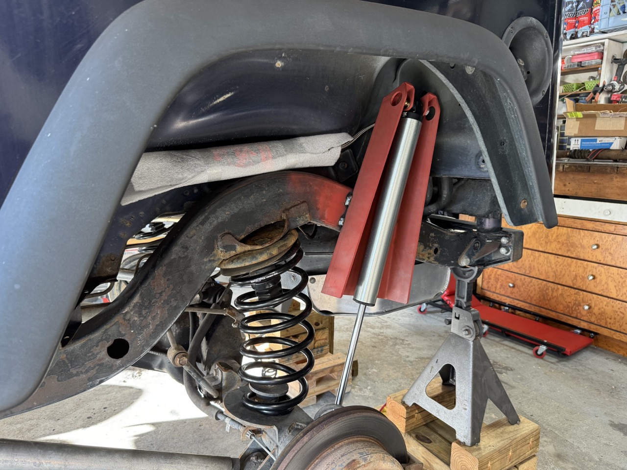

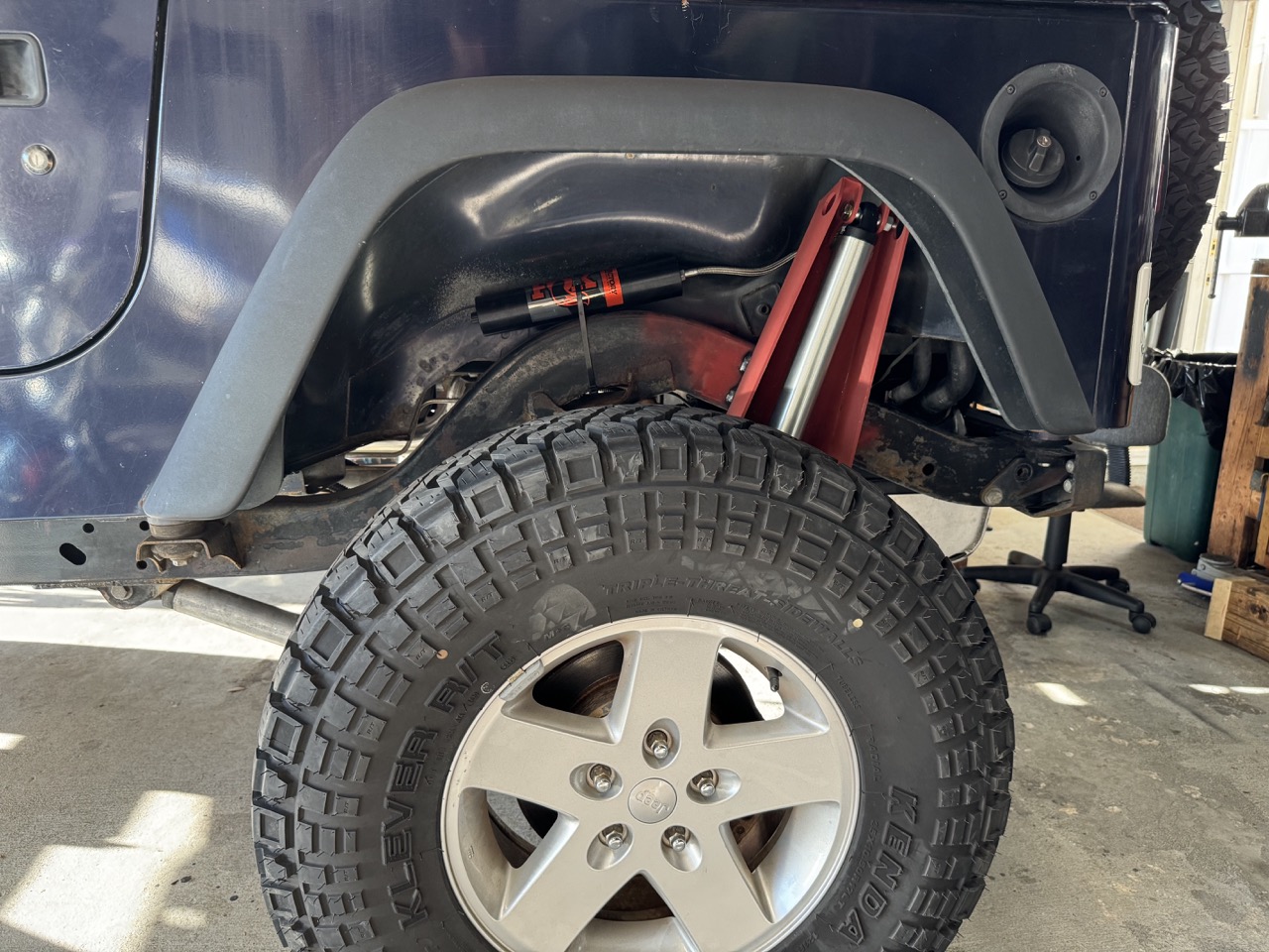

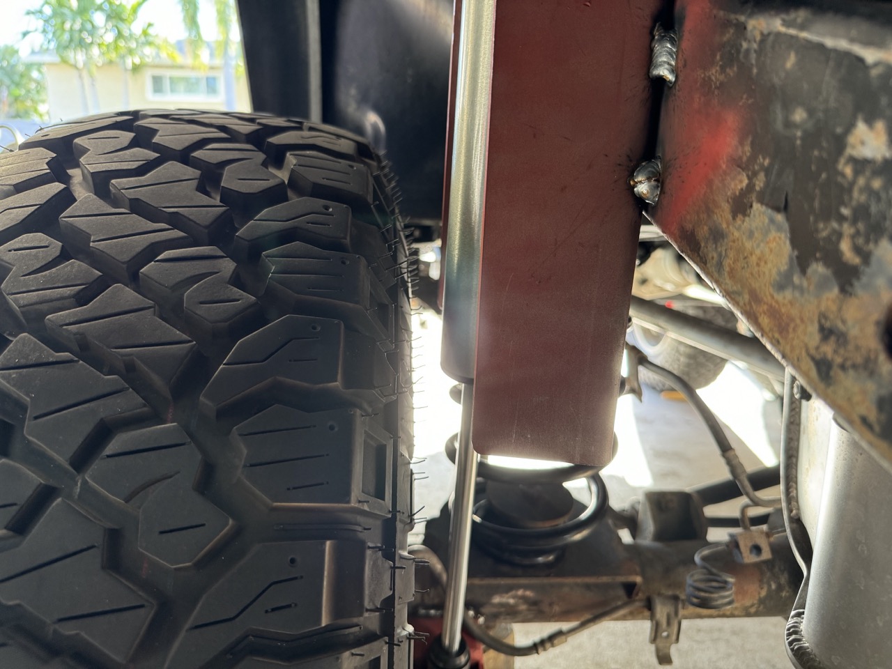

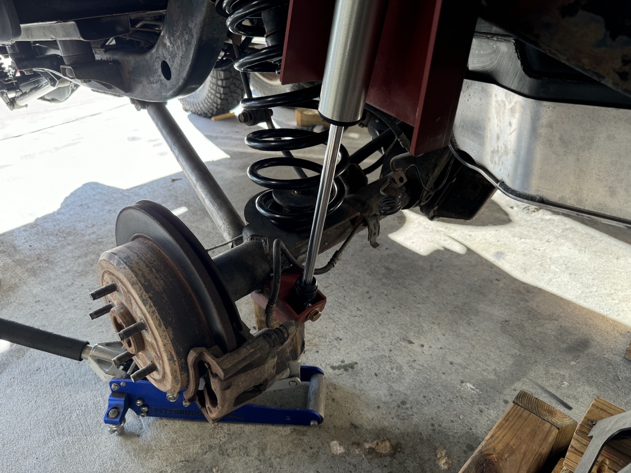

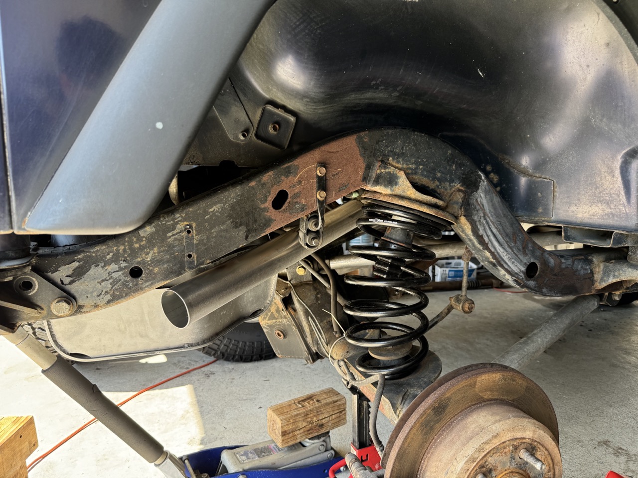

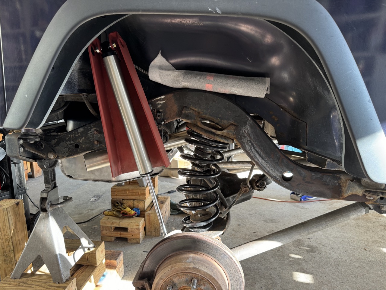

I did the world's most half assed rear shock outboarding today, in about 4 hours from idea to test drive!
I had this idea in my head that since I had the wider JK axles, I might be able to just slap the Poly Performance towers on the outside of the frame without cutting anything and get it to work, at least temporarily. I've got the sway bar/driveshaft limiting my down travel, and the sway bar limits articulation as well. Because of that, I figured I didn't need so much room between the tire and the tower. After mocking it up by clamping the tower to the frame and cycling everything, it seemed like a go!
When I said half assed, I meant it. I didn't really measure anything, its all eye-balled into place.

Had to move the exhaust hanger a little. It worked.

I'll admit it is pretty close to the tire. I do have some wheel spacers if I need them.

I should rename this thread doing it the easy way. Outboard in a day? 😝
The reason I did all this was because it was having some undesirable road manners when hitting bumps due to the rear end missing a shock. It was almost like bump steer but from the rear. I didn't really want to buy another shock since I already had the Fox 2.0s, and it's gonna be a while before I can have the Jeep down again, so I figured I should give it a shot.
After a quick test drive, I could immediately tell it was completely planted. Less body roll, way more predictable. The shocks are maybe a little too stiff at the rear, but I might just need to get some more weight back there. I did however notice a new vibration that seemed like it could be the driveshaft...

Checked the front driveshaft clearance to the exhaust as well. Plenty of space. Had to remove the dust boot to get the driveshaft to touch both yokes. At ride height, there's only about 3/4" of spline engagement, so definitely need a new front shaft.
Have you flexed it out with the tires on, Carrot? Under articulation it looks like the tire will quickly get into the shock mount - even with wheel spacers.
Reactions: Apparition
If I disconnected the sway bar and removed the springs, I'm sure I could get the tires to contact the shocks, but as it is, fully assembled, I can't get the tire closer than 1/2" from it using just the weight of the rig and a floor jack. I'm definitely going to have to take it easy offroad until I do the real outboard, but I think it will be fine for street driving, for now.

So far, I haven't encountered any issues with the rear outboard 🤞

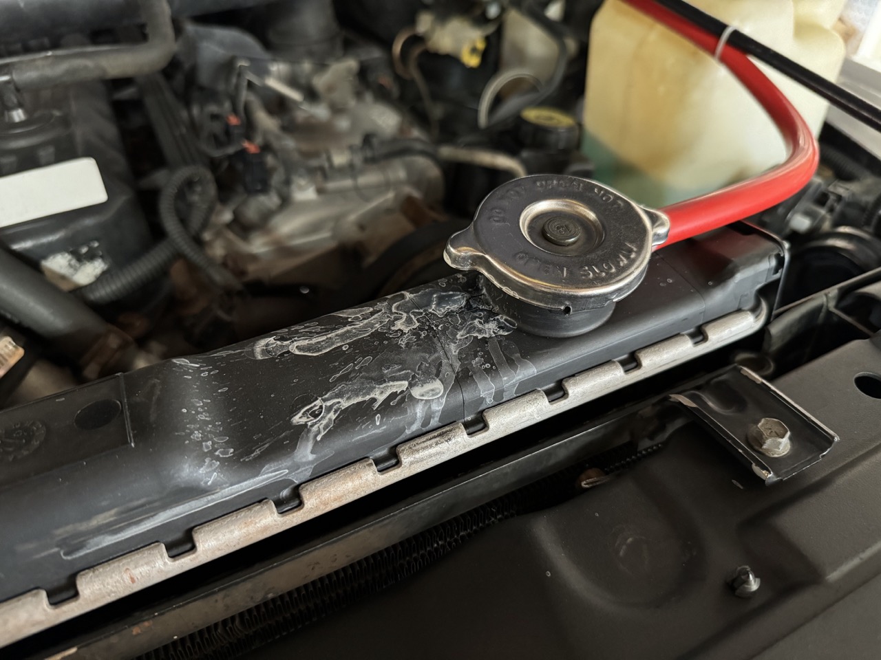

Looks like I might be needing a new radiator cap. Is Stant the go-to recommendation?

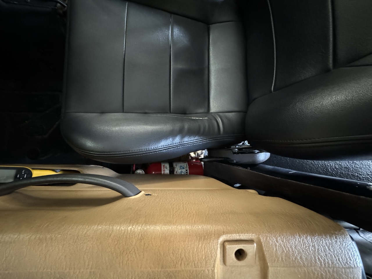

I might not bother with this, but I'm thinking of swapping my driver and passenger seat around so that I can mount them farther apart. I've got Corbeau seats that aren't designed for a TJ and the recline lever runs into the roll bar. Because of that, the seat isn't quite centered on the steering wheel. It looks like I can move it at least an inch or two before it touches the door.
I'll have to make sure the seat belt receiver doesn't get in the way of the lever though.
