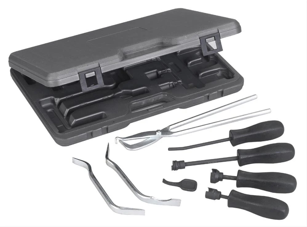

Having the right tools for the job goes a long way, too. Job-specific, don'tcha know...
I think trying to use the wrong tools is what gets a lot of people frustrated with drums. I'm guilty of doing it the hard way (screwdrivers and pliers) for many years. It was nearly a life changing moment when I was introduced to the proper tools. My blood pressure dropped back to normal and my hands quit bleeding. :LOL:
This was an Old Timer's response when I said I loathed changing drum brakes. Get the right tools and it's easy. The first time for me was rough. I did them with needle nose pliers. Next time I used vise grips, much better. If they stay in my life I'll get the tools you posted. But I'd like to swap the rear with disc brakes...
