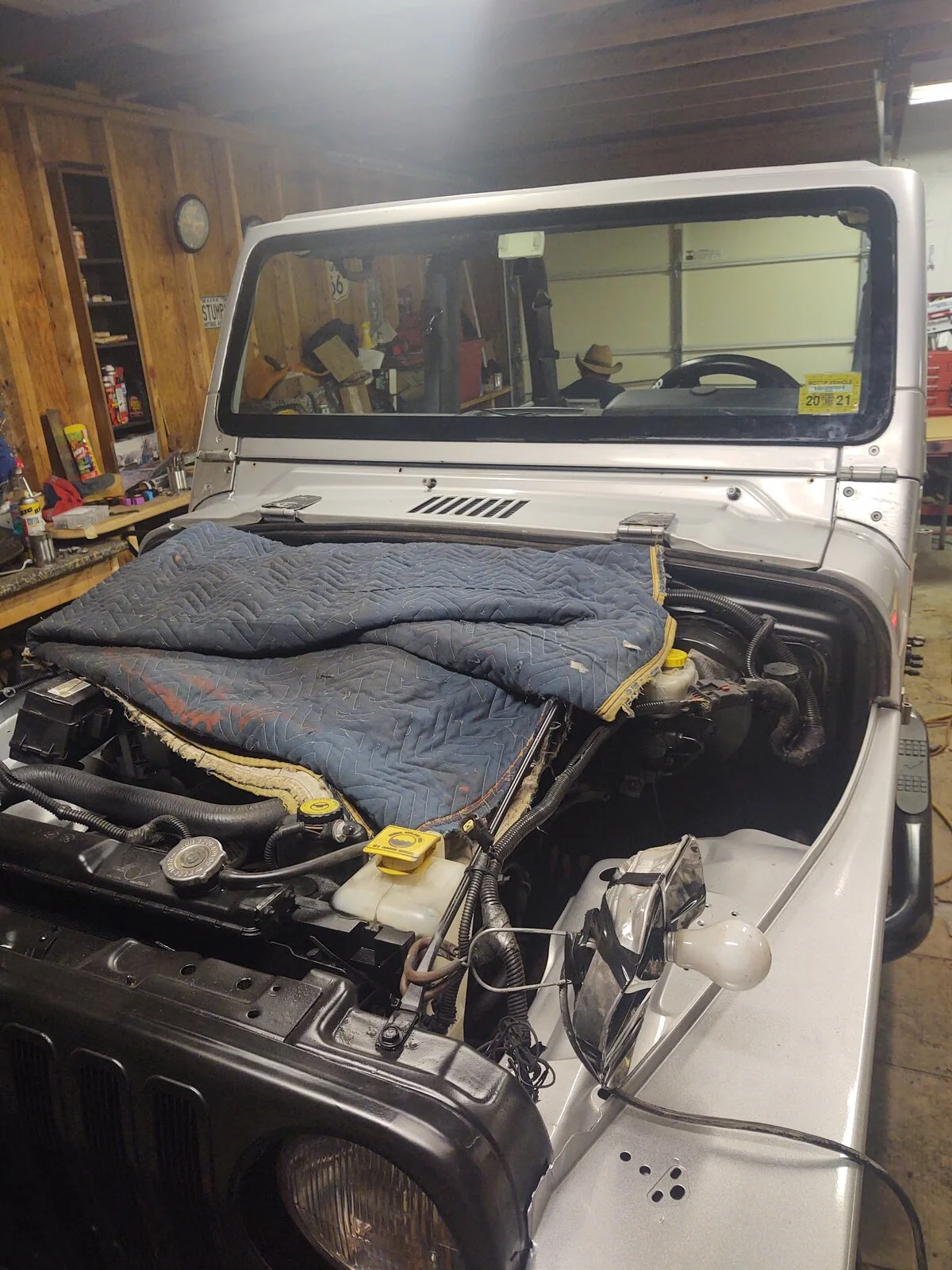

The rubber has been cleaned before the window frame is reinstalled, hinges have rubber so hopefully no rust will form from metal to metal.

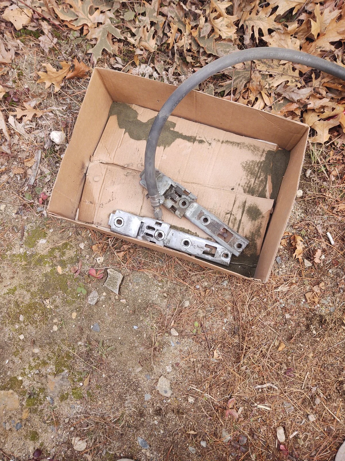

Tailgate hinges have been sandblasted, and primed. Led lights have been put into the dash cluster. The o2 NGK sensors, manifold, timing belt, water pump, spark plugs, wires, and oil have been changed plus a new battery tray has been put on.

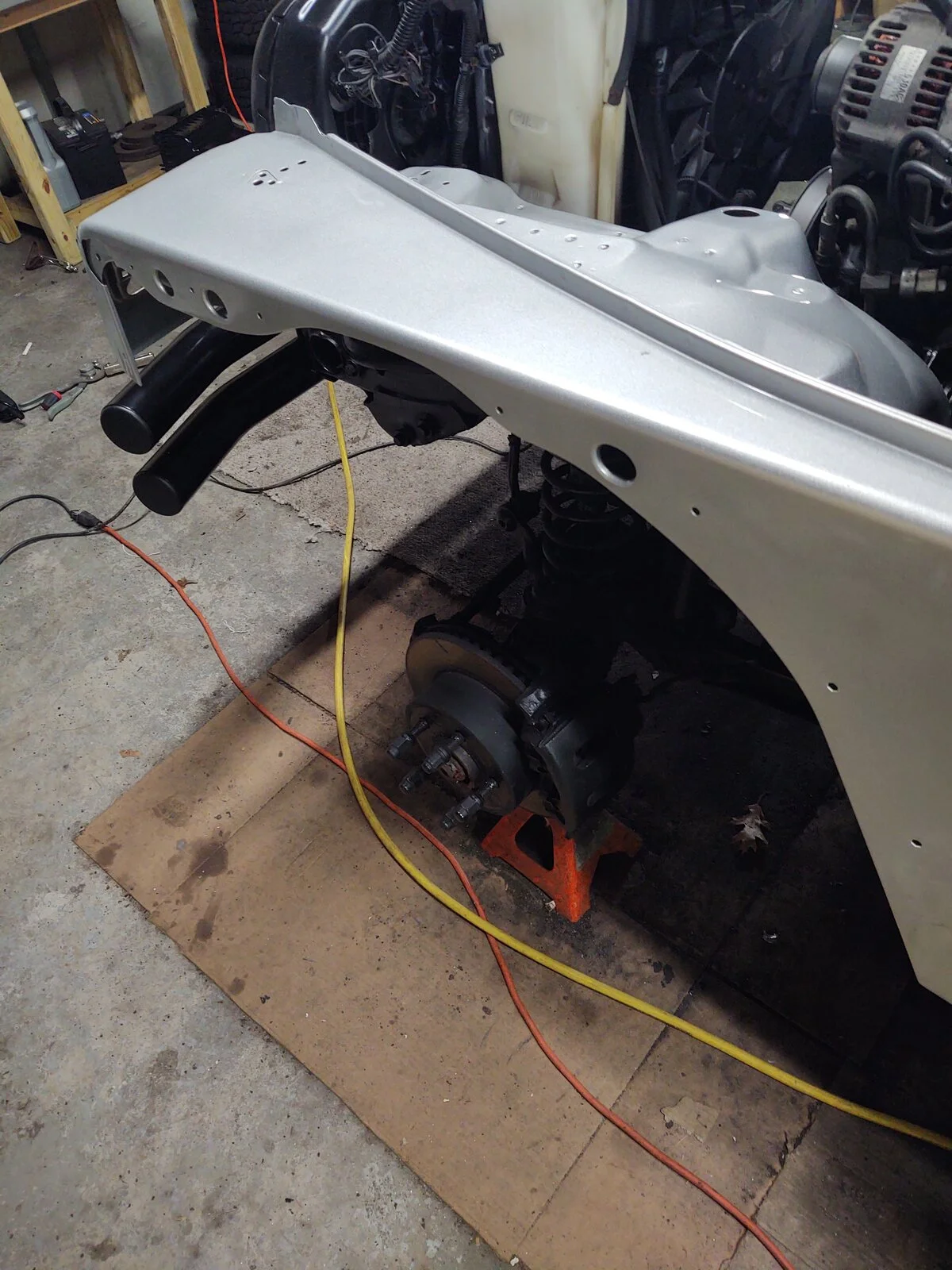

Next thing to be done is the fenders, they will finally be installed.

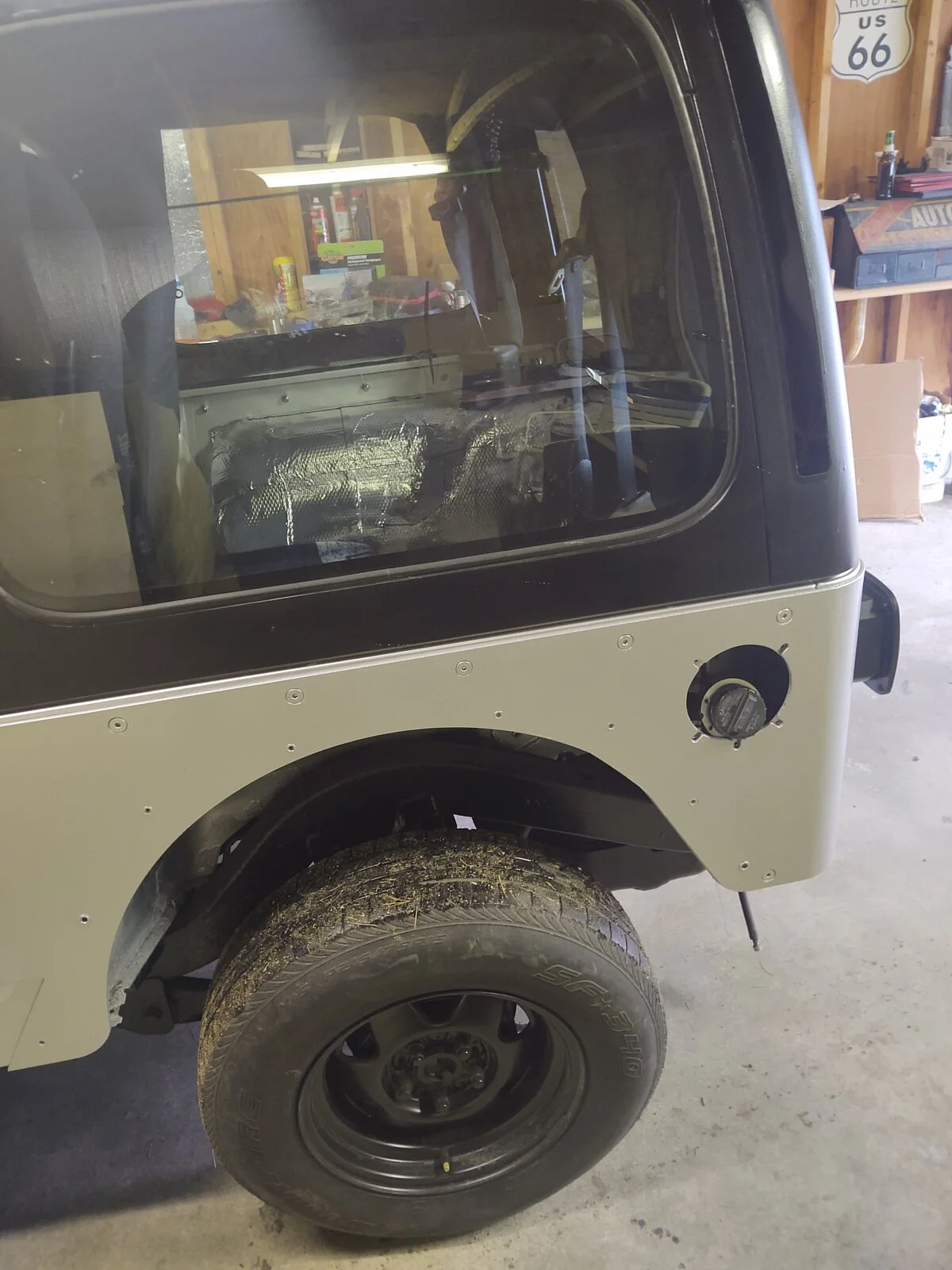

When the aluminum corner guards get put on I'm taking the Jeep to get painted. I'm thinking/ hoping it will be all done by Dec 11.

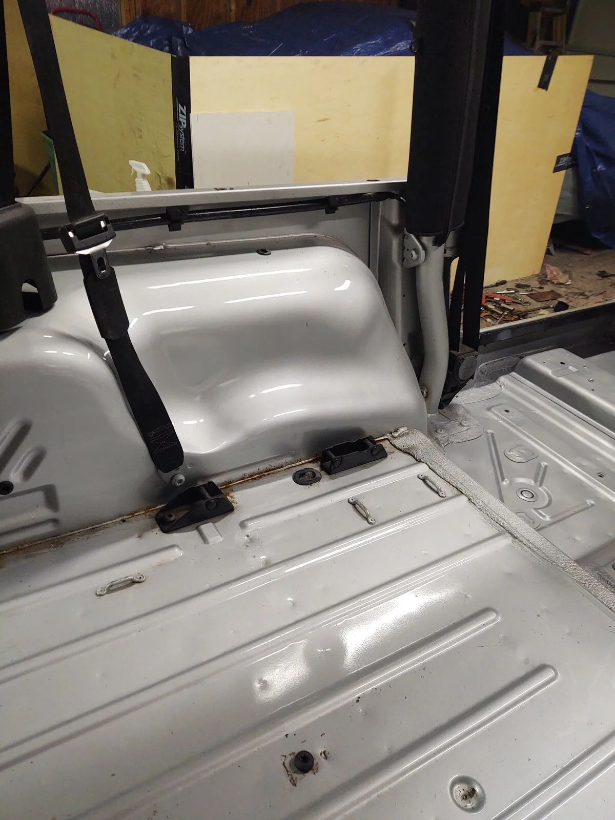

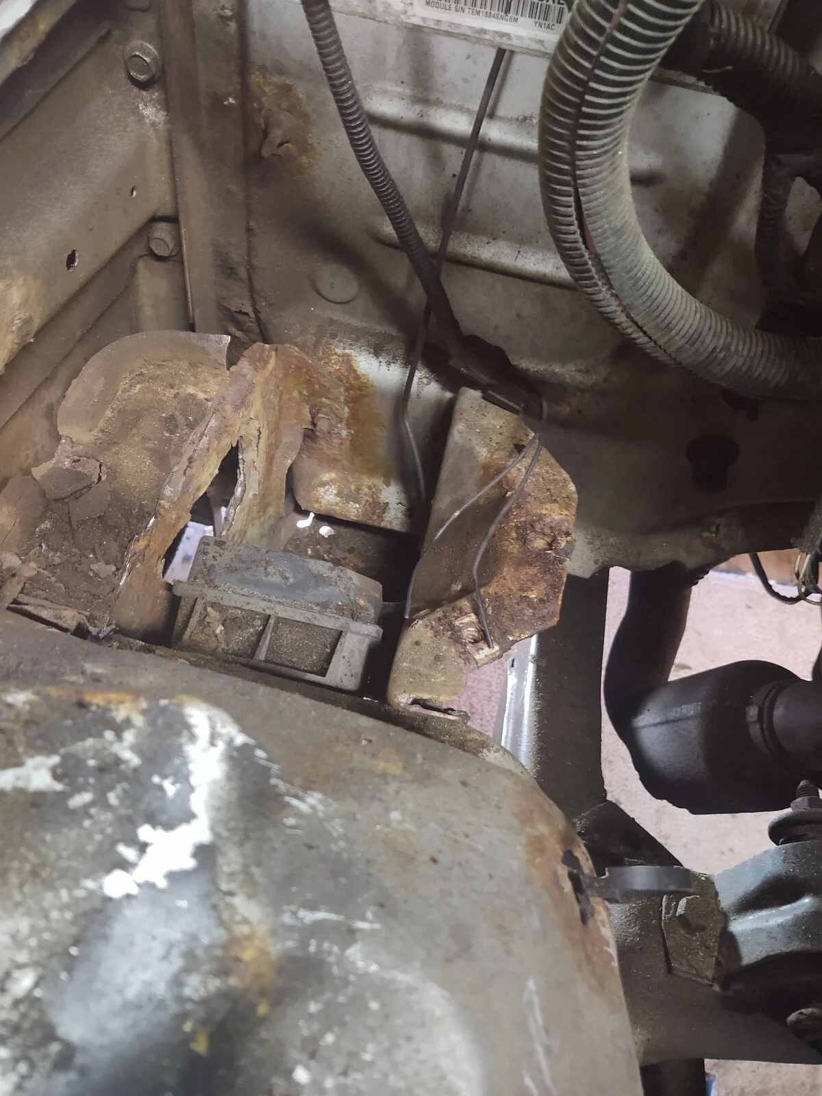

The frame has been treated, and painted. Everything that needed to be replaced, or treated/painted etc has been done. I have to say the one thing that turned out better then I ever thought it would is the windshield frame. We used a ten dollar grinder from Harbor Freight to cut the bad sections out, then mounted the replacement piece (Ebay) using JB Weld, and a lot of clamps. Then after painting it the frame looks great.

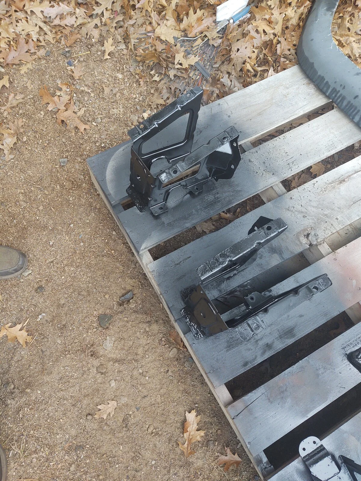

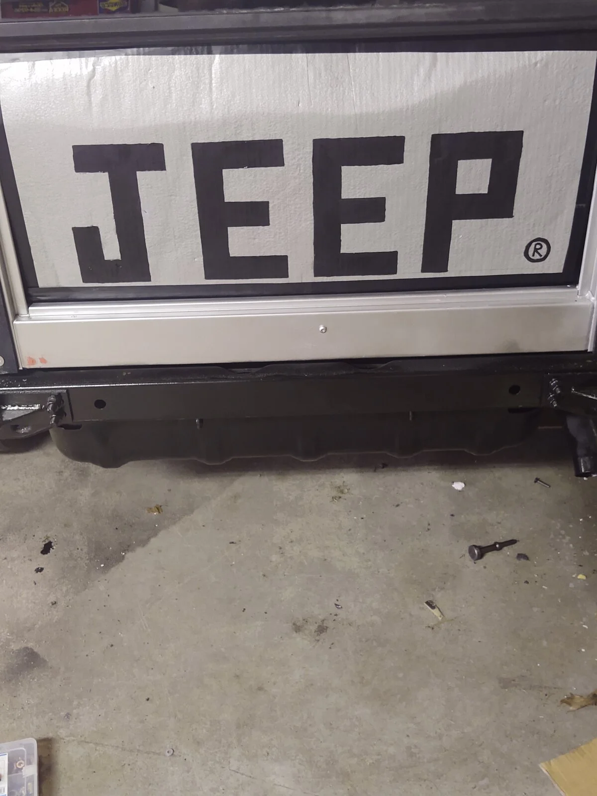

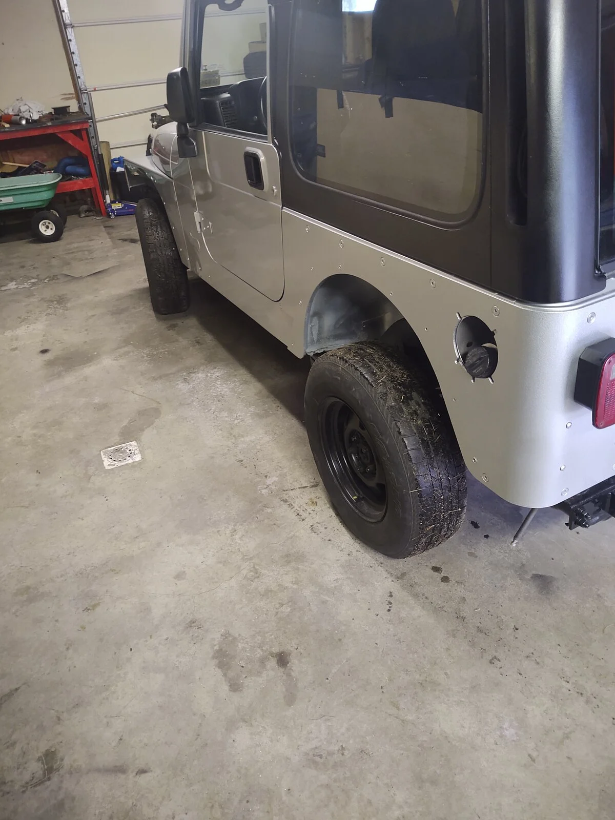

The 2001 Jeep rotted out but certain areas weren't touched at all by rust, one spot was the brackets (under the two battery trays only one holds a battery I have no idea why the other one is there) that hold the front fenders. The 2004 the frame is solid as a rock but those brackets were so rusted they crumbled taking them off. So we blasted the 2001 brackets, then painted them, the rear license plate screw hole area was rusted so we had to cut a one inch hole, then put an aluminum patch over the hole. The whole back end will be covered with the aluminum corner guards. Those two spots were the only rust we needed to cut out.

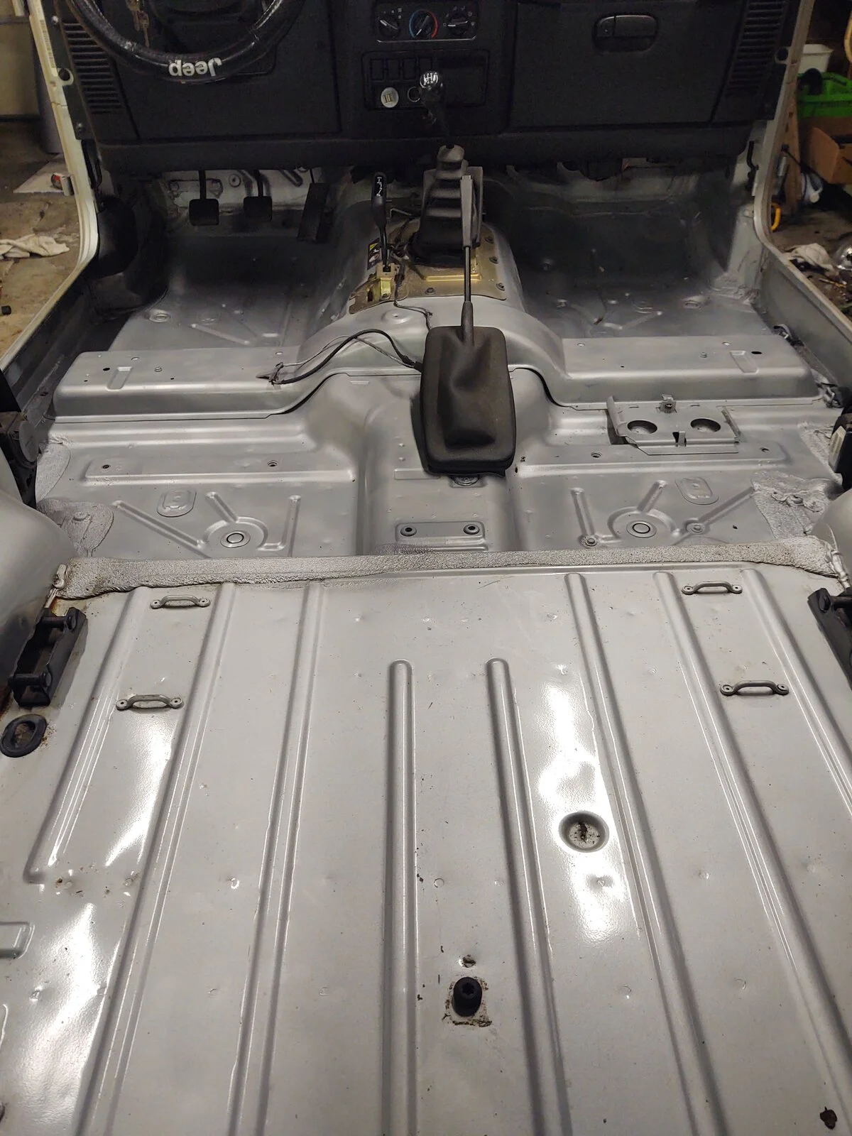

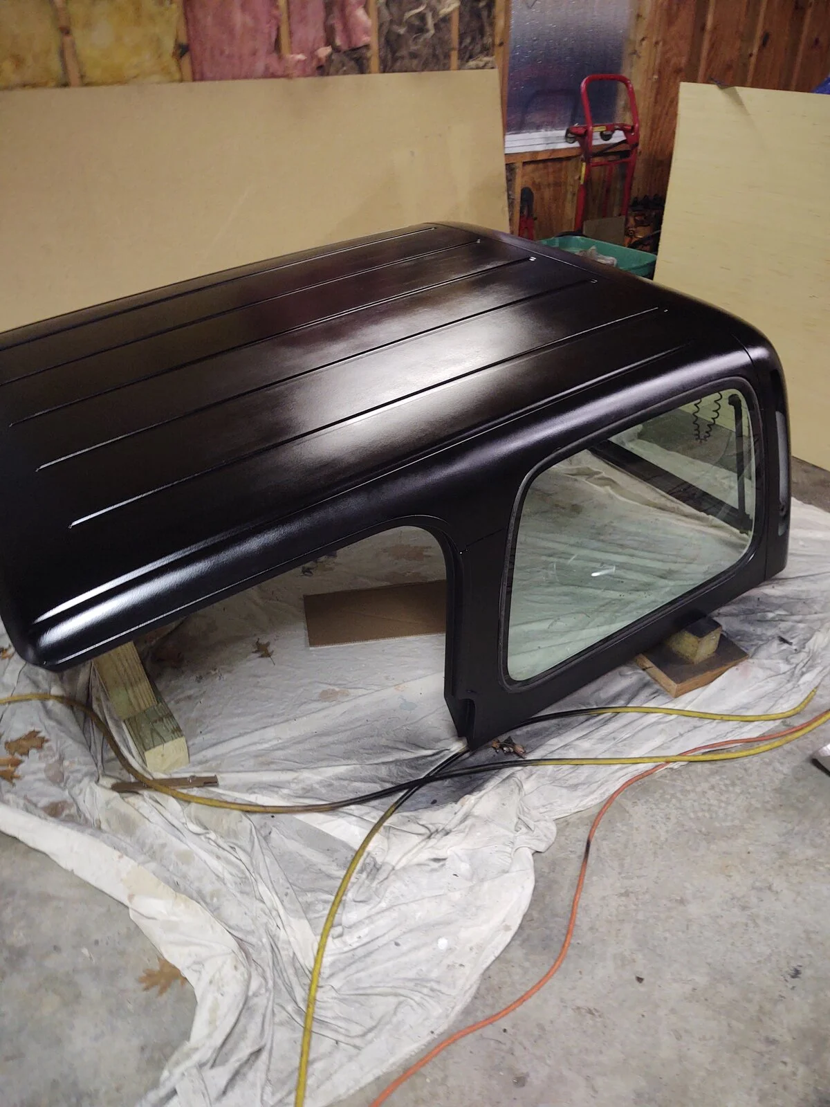

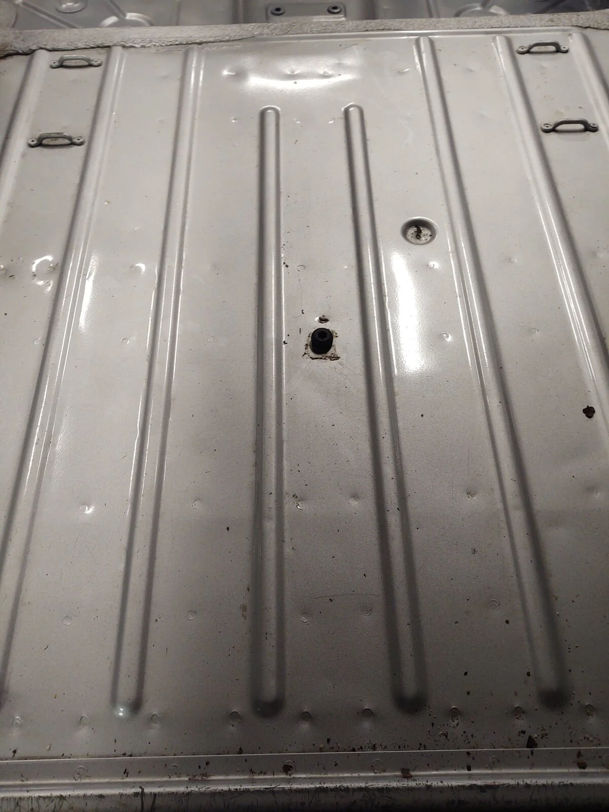

The hardtop is painted, floors are primed hopefully by Sunday everything will be put back together, then I can get it painted. I still can't believe how little rust this Jeep had.
Reactions: Ardenlonewolf
Painting the inside of the hardtop, I can't handle the white anymore going to paint it black. We are taking off as many things as we can, and when we get it to shop that is going to do the paint we will remove the tail lights and a few other things. The more we can do the better. I'm hoping I can take it on Monday??

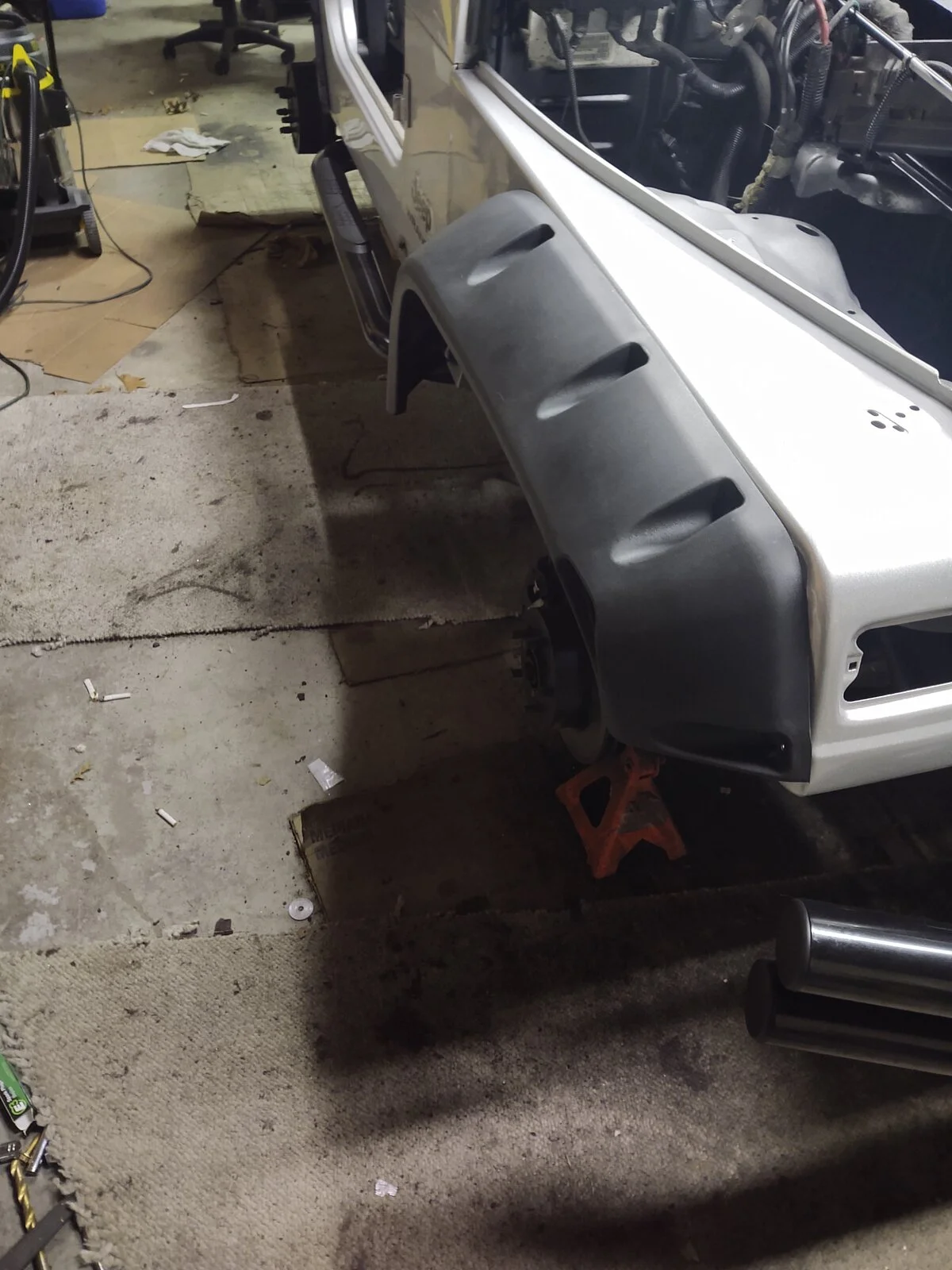

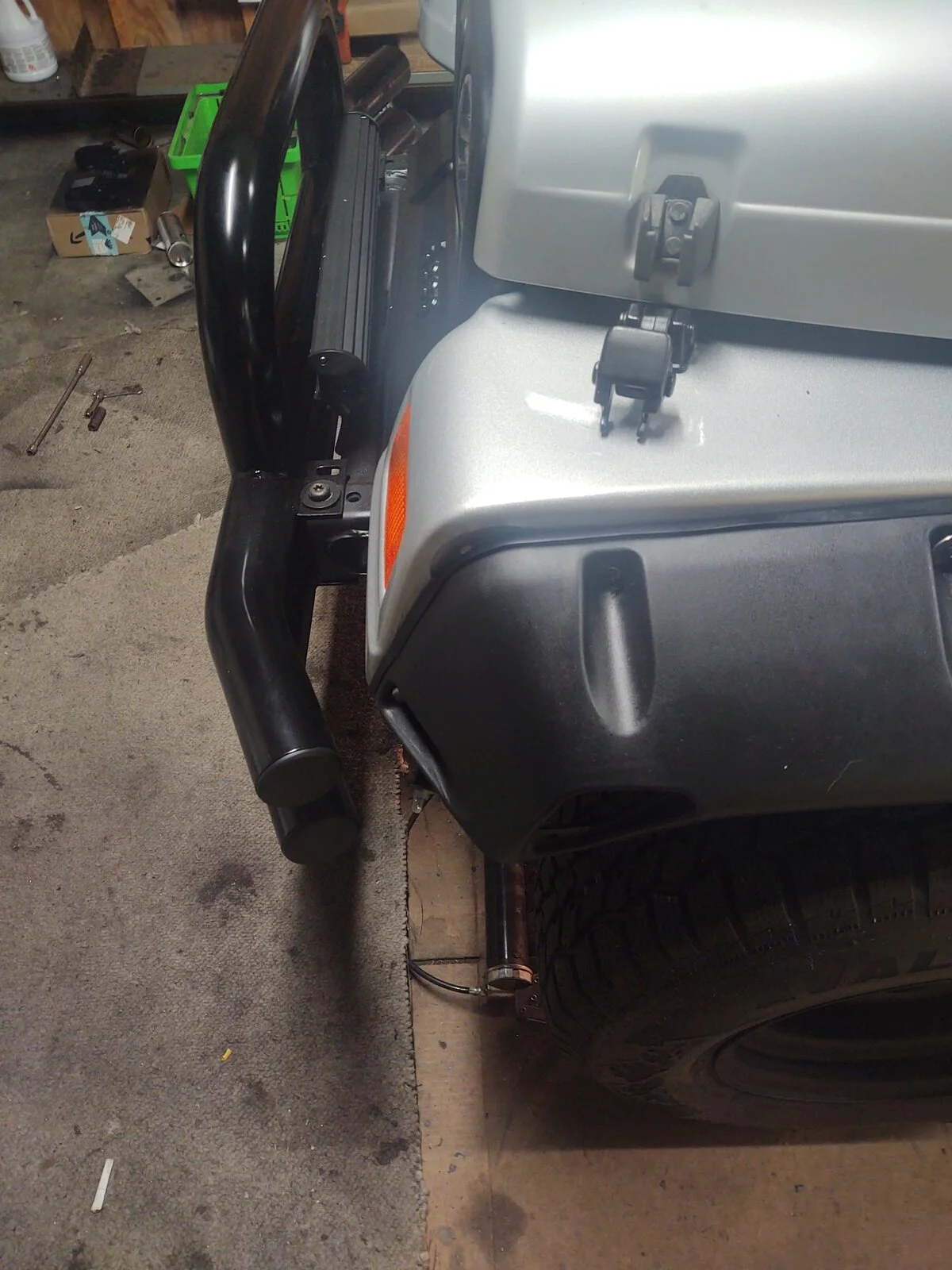

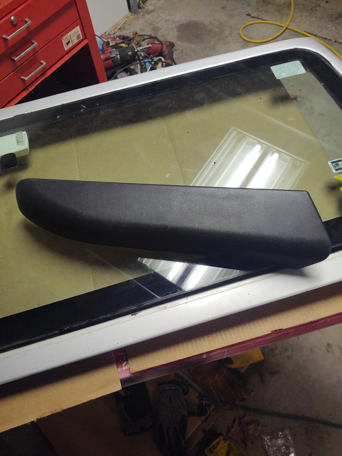

The pocket flares I got suck big time, so I'm going a different route. Why make a fender flare that leaves a gap at the front? The gap sticks out like a sore thumb on both sides.
I just ordered the 7inch fender flares by Rugged Ridge, they look like stock fender flares.

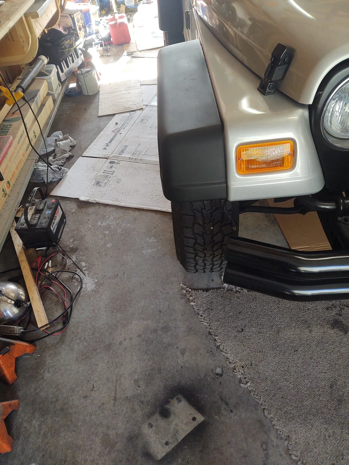

Front Fenders

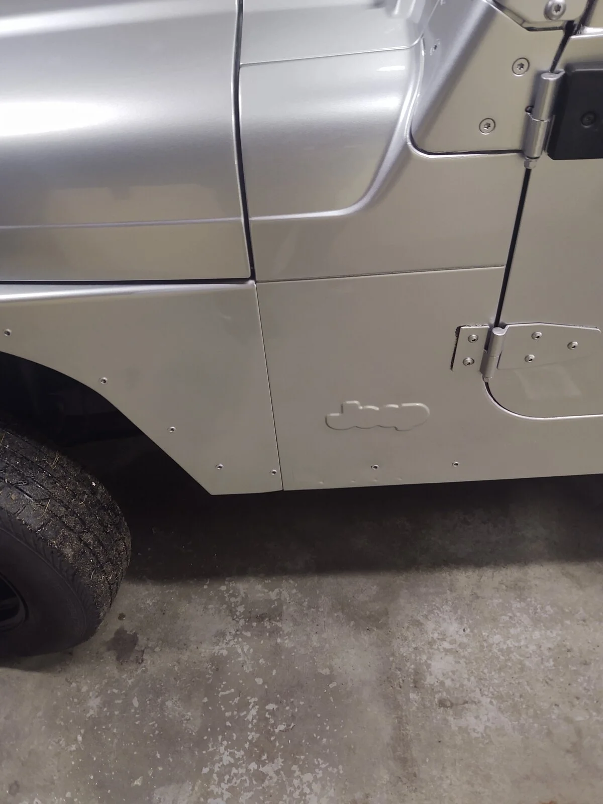

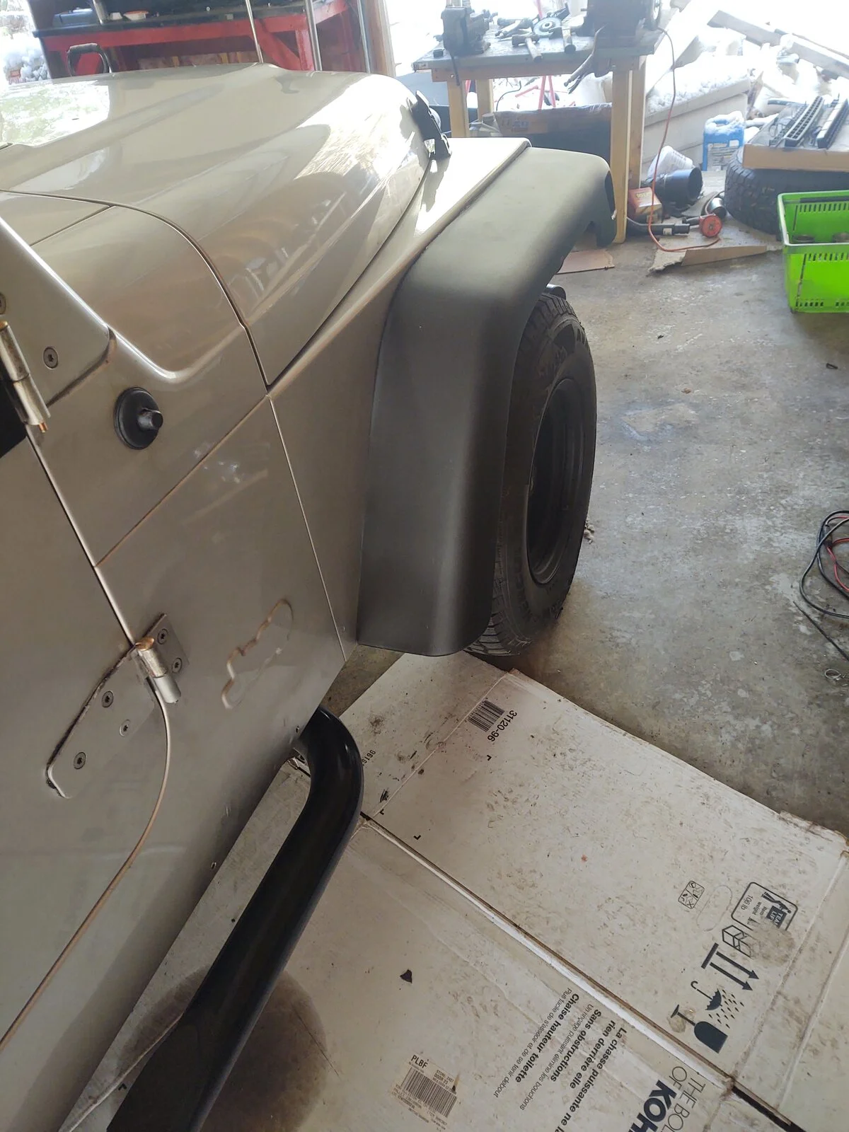

I'm really liking the new fender flares, they look a lot better than the ones I put on first.

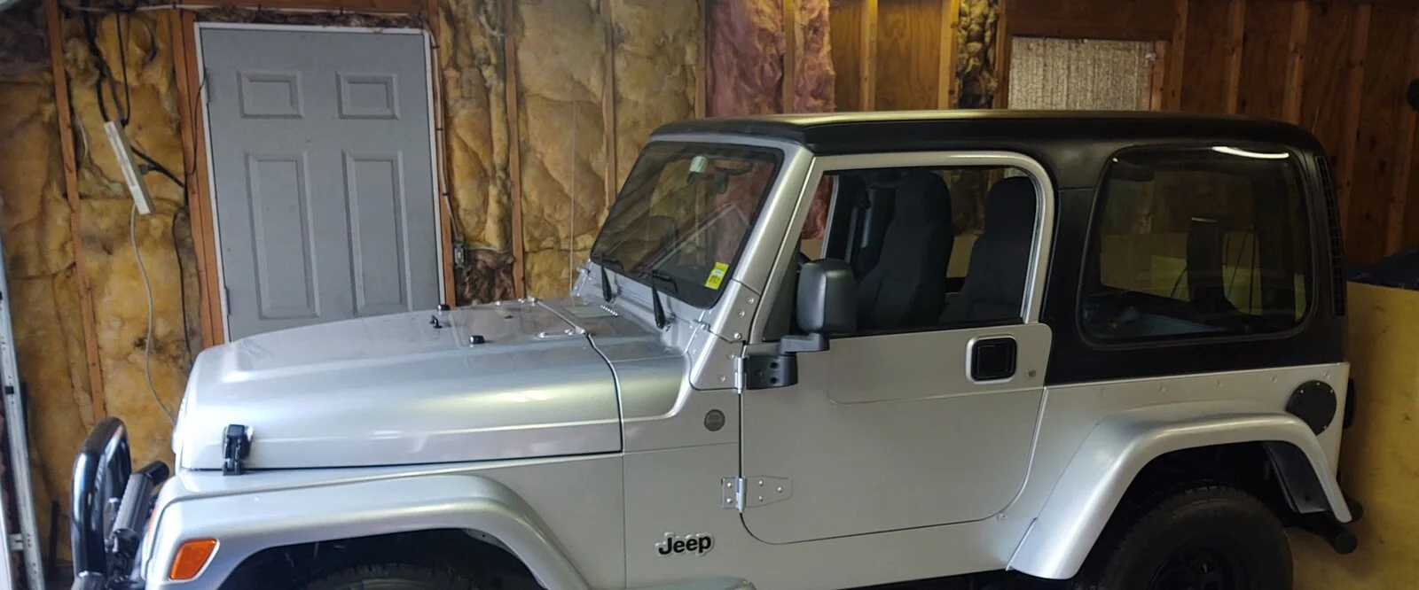

Will be taking everything off before I drop it off to be painted. Need to install the new door hinges next.
I'm going to drop off the Jeep on Monday to have it painted. The new tailgate isn't installed so they can hang it up and paint it.
My brother-in-law thought it would be funny to put something in place of the tailgate for the ride to Portland. (Painted cardboard)
What brand were those pocket flares? I just ordered some similar and now you have me nervous...
Speedmotor that I ordered on Amazon. What a piece of crap, no matter how much we used a heat gun it wouldn't straighten out.
The ones I got from Rugged Ridge lined up perfectly.
i paid a some extra $$ for Bushwacker - so hoping the reviews are accurate and they do better.

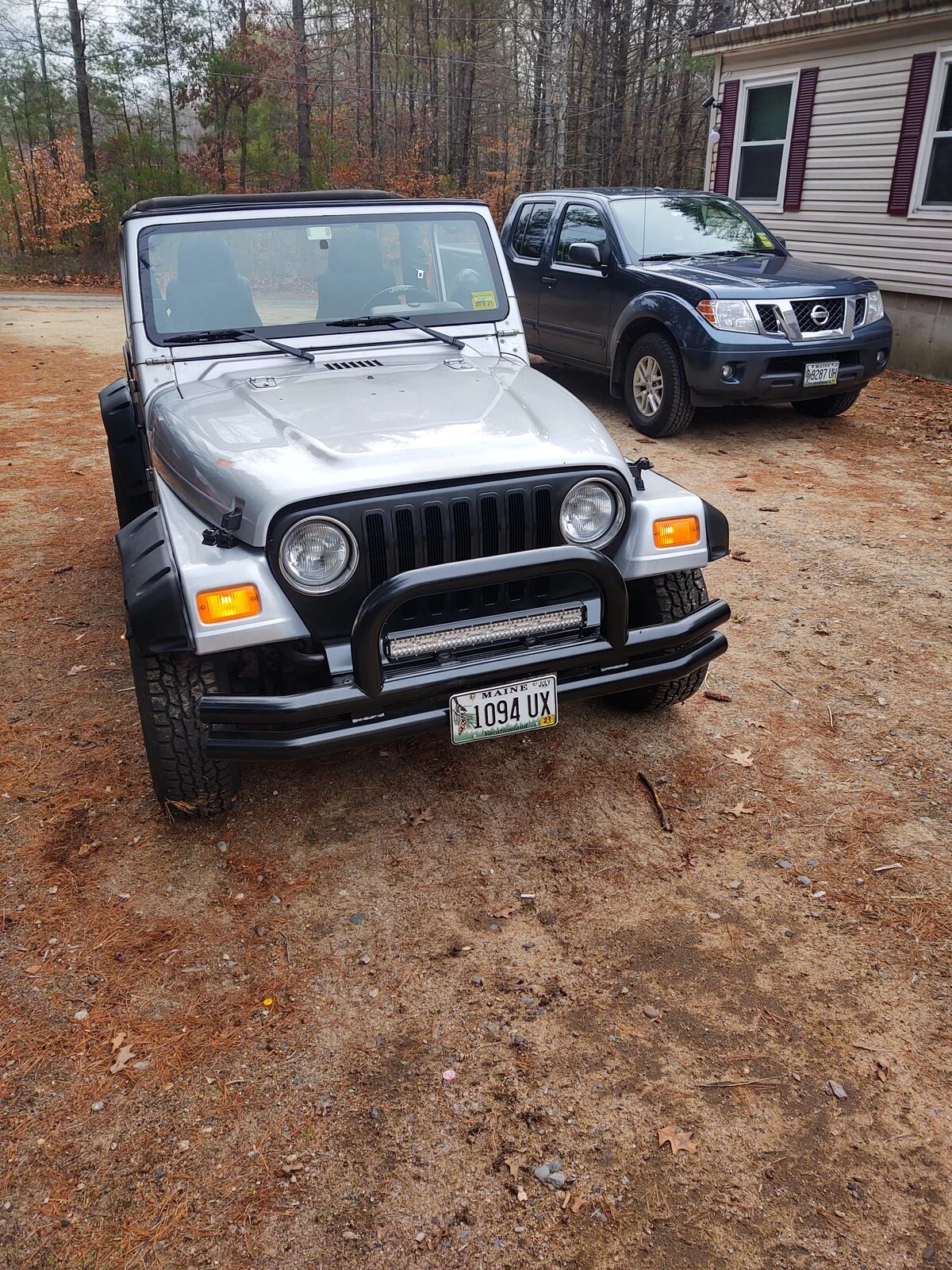

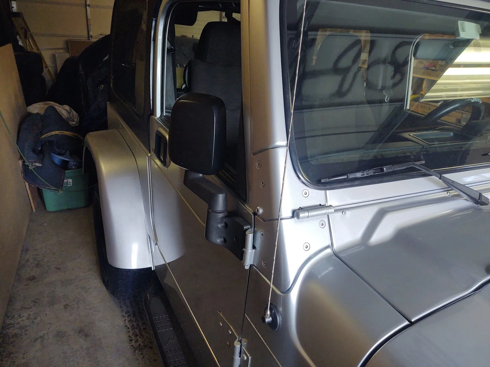

They are done painting my Jeep, he said it came out really nice. I'm going to pick it up this afternoon. When I get it inside the garage all the parts we took off to get it painted will go back on. They painted the tailgate I bought, we need to take all the parts from the old tailgate to put on the new one. I wanted to have them side by side so it doesn't get screwed up.
The hardest part will be getting all the lights to work, need to figure out a few issues. I could never be a doctor I don't have patients. The only things we still need to do is put up the sound proofing, and the headliner for the hardtop, plus the black jeep logos that haven't come yet.
Reactions: Fouledplugs

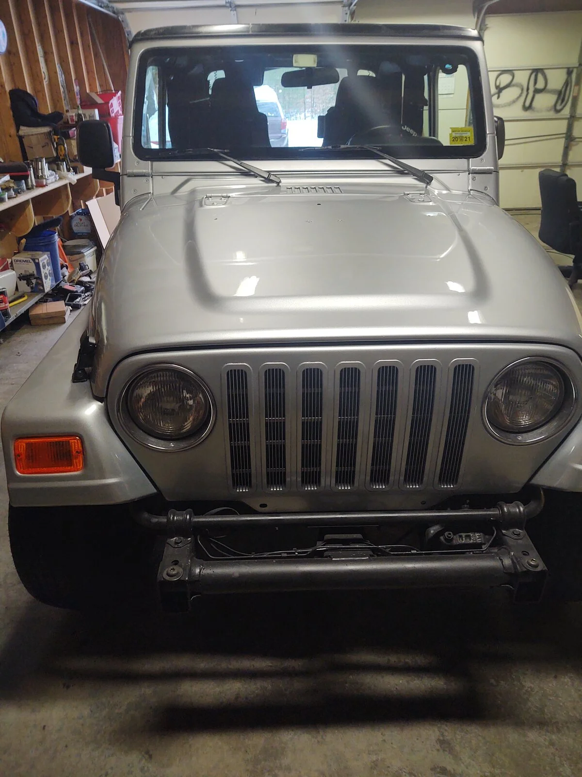

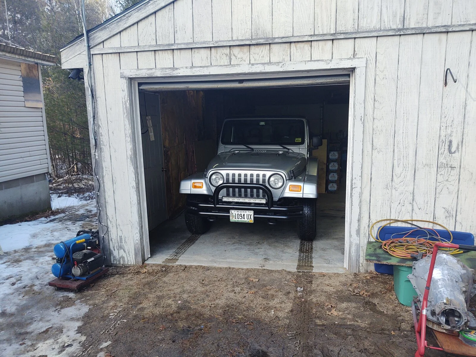

Just about done, but then again is it ever really done? Waiting for the new spacers to arrive on Wednesday, still got to get the new LED tail lights wired. Then I need to do a shakedown ride to see if there is any unknown issues.
