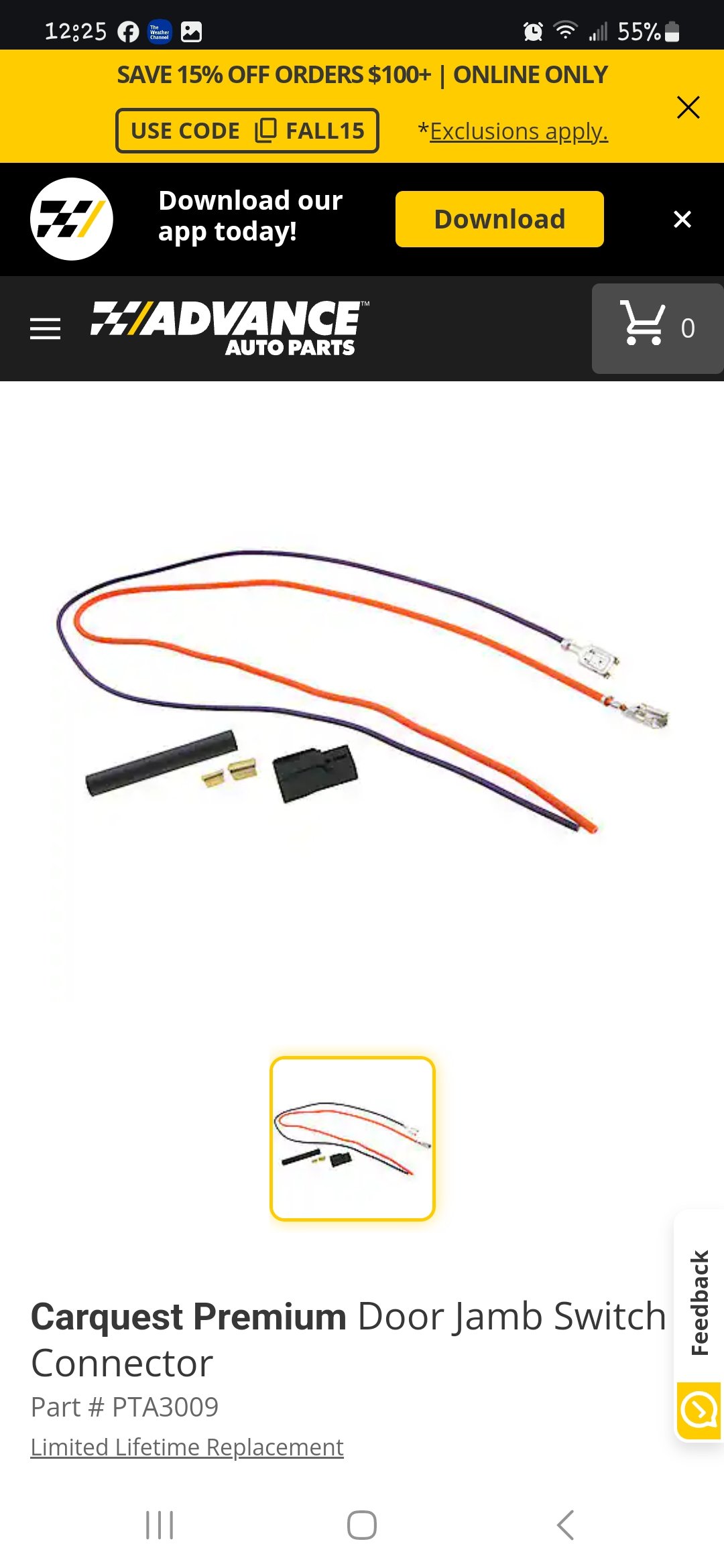

Anybody have a clue if this fits.. guess if it's in stock I could find out.. says it fits

Are you talking about the switch between the door jamb that turns the interior lights on and off? And what year is your TJ? I can't imagine that this switch is the same from 97-06.
