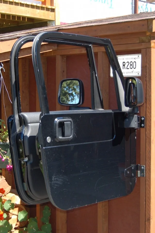

Heres my door storage solution. A set of TJ hinges bolted to a stud beside the parking spot.

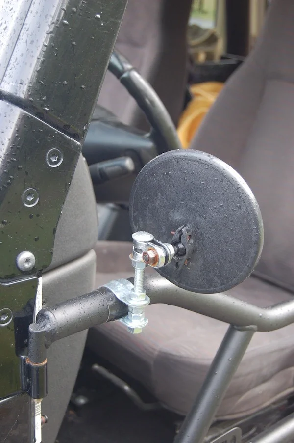

Mirrors, we have a law... can't drive doorless if the vehicle was built with doors. Not real bad, I like tubular doors anyway AND with mirrors mounted to the tubular doors..... I can do the change in under a minute.
The mirrors are cheap semi truck add on convex mirrors. The convex part is awful so I broke it and had a glass shop put in flat glass. WAY more better.
