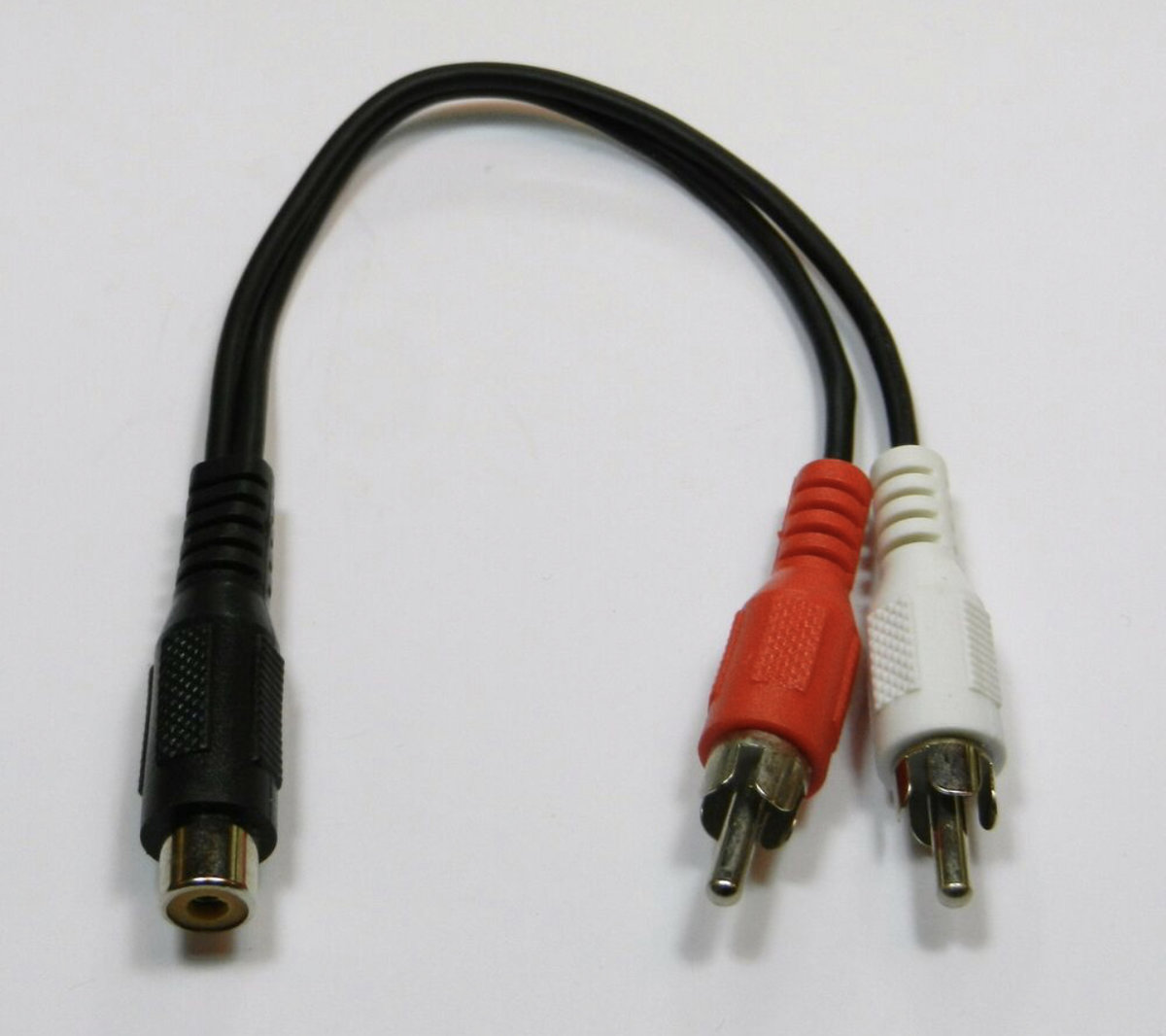

I’m not that big into aftermarket audio, but you are right that most sub amps have the 2 rca inputs. Do you think I could use a splitter to get the 2 inputs? Something like this this off eBay maybe
I’m not that big into aftermarket audio, but you are right that most sub amps have the 2 rca inputs. Do you think I could use a splitter to get the 2 inputs? Something like this this off eBay maybeView attachment 137584
I'm not big into automotive audio either, but I've got a pretty decent QSC/Numark setup in my basement I used to haul around to do the odd gig, and I've done some creative combos of equipment.
You could absolutely do that, and if you were planning to keep the setup permanently you should. I have adapters I could dig out of my basement to try that out, see if it makes a difference. It might take care of the low signal issue I was having, but I doubt it. I got normal speaker signal to the sub by using the two rear speaker RCA outputs off the unit, which is what a lot of people do anyway, essentially, or at least they used to before sub outputs were a thing. If your amp has adjustable pass filter and preferably a remote gain you can mount up front, that's a very decent option to make it all sound how you want with adjustability on the fly. For that matter, since there are no in-unit ext sub adjustability options, you might as well use the speaker outputs unless you can install different software to allow the adjustability. In the end it was a sum of all the issues that made my decision to ditch it altogether. Not surprisingly, the Chinese Android unit felt like an Android phone wired into my Jeep. But with worse audio.

Quick update, I installed a subwoofer and amplifier on the xtrons using a Y splitter for the RCA and it sounds good. One thing that I did not like was that the remote outs on my unit only put out 3 volts, it was no big deal though I just tapped into the red wire (keyed 12v) using a quick T tap.
