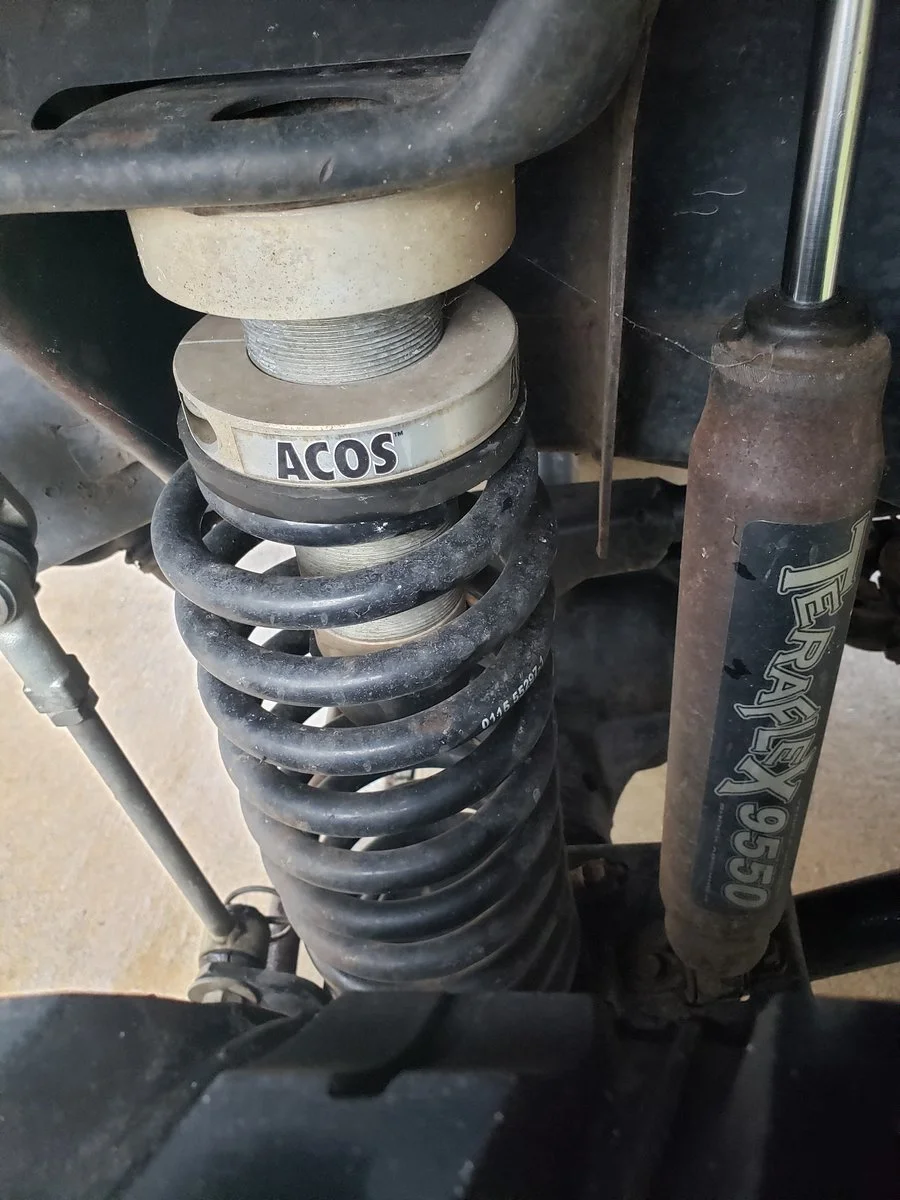

I don't know that the brand or model of lift is necessary. But a picture of it would say a lot. Is it all springs? Body lift? And spring spacers? Could be pretty easy to lower it an inch or so if any spacers are being used. Then 33s would be great.
Don't know too much about the build. The person that did it and I are separated by the previous owner. Not sure of the gear ratio, etc. Kind of learning on it as I go. If you read my intro post, you kind of get the idea of how this all came about, but (in addition to that) I had been looking for a jeep, and really had no plans on anything with this sort of a set up. But it was local, the price was very reasonable, and all the things that needed to be done to get it back on the road were well within my general mechanical skill set. So...it is a running project more than anything else. But any advice is good advice, even if I don't take it.
Also...if someone can tell me what the stock lift is, I can run a tape on it tonight or tomorrow...
Measure the height of that spring. Then measure the height of that ACOS thing.
The good news is that your Jeep likely isn't built to handle 35s very well. ;)
ground to bottom of the pan = ~24"
Spring = ~13"
the "ACOS thing" = ~ 3"
All measurements done in the dark and fast, so give or take a margin of error of some sort.
