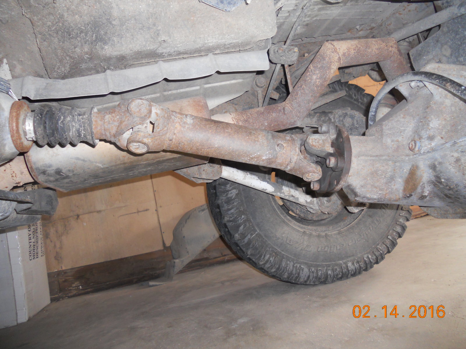

Here are pics for you to check out
The below is how your pinion and transfer case output shafts should look, they're supposed to be parallel to each other with the factory driveshaft as you have. It's hard to tell from the angle of the photo but it looks like your pinion angle may be too high. Did someone adjust the rear axle's pinion angle upward?
I really don't know for sure. Just bought it couple months ago and started working on it about 2 weeks ago. Don't have any history on it. It does look like pinion and drive shaft are almost in alignment with each other. The Dana 35 was replaced with 8.8 at some point. Could have happened then. Can that be changed with adjustable control arms?
Yes it can be with adjustable arms. Any shocks numbers you can look up. Maybe this would give you a better idea of the lift height.
There's no doubt in my mind that thing NEEDS a CV driveshaft and some adjustable control arms, bad... Talk to @AOR, he will hook you up.
It's very obvious now why it's vibrating.

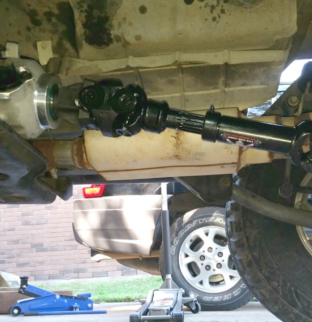

Looks like mine before I added my sye/cv driveshaft. Do you have a lot of vibration issues? I didn't think I had any until i did the sye and driveshaft replacement. I measure 26" to bottom of rocker panel with 33's and a 4" lift. SYE/CV driveshaft is long term solution if your gonna keep it lifted
