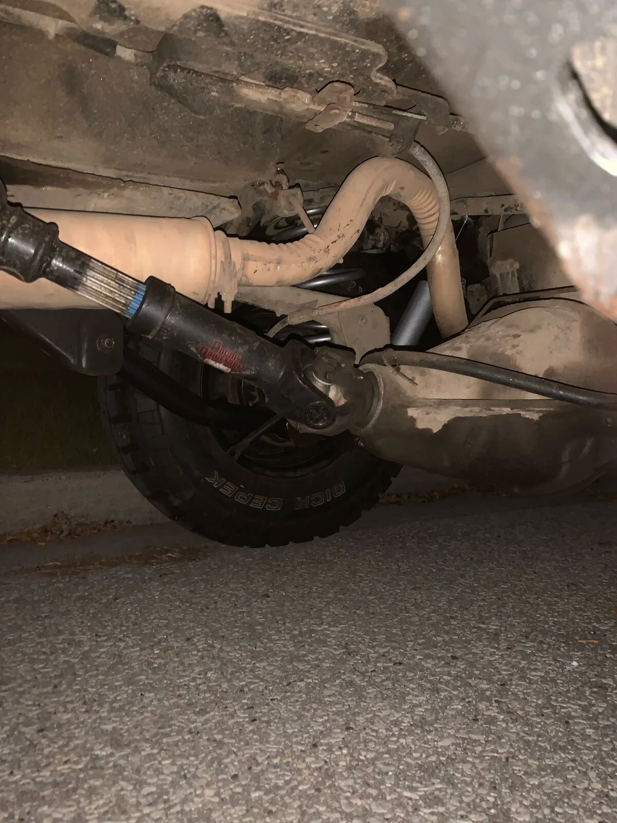

Just finished installing a 4" lift on my tj. Rough country so it has nonadjustable control arms. Just took it out for a test and have bad driveline vibes. Looking at the pinion angle it looks as I need some adjustable rear uppers. I have a sye and rear dc driveshaft already installed. (and yes I did the pinion seal when I was down there lol)
Just finished installing a 4" lift on my tj. Rough country so it has nonadjustable control arms. Just took it out for a test and have bad driveline vibes. Looking at the pinion angle it looks as I need some adjustable rear uppers. I have a sye and rear dc driveshaft already installed. (and yes I did the pinion seal when I was down there lol) View attachment 284400
Pinion is low. Adjustable CA’s are in order. Ideally do both upper and lower. If only one set, uppers.
I did the exact same thing a while back, 4" lift + SYE & new driveshaft, and ended up with bad vibes. It felt like it was in the wrong gear was the best way I could describe it. Added adjustable rear upper arms and got the angle dialed in, everything is perfect after that. It was the first time I had bought a lift kit, but I'll forever be amused whenever I see a kit say something like "you may need an SYE or adjustable arms" because there's no way you wouldn't need those things, imho. Or maybe it's just marketing to get you to buy their cheaper kit that doesn't have stuff you'll end up buying later.

Put the arms in, did an alignment, straightened out the wheel. Did not DW once but felt like it wanted to possibly, I also don't have my sway bars in right now so that could be the case I was definitely trying to get it to DW and felt like it wanted to start once... Going to put the zj steering conversion stuff in soon so hopefully, that'll tighten things up instead of the original crap.

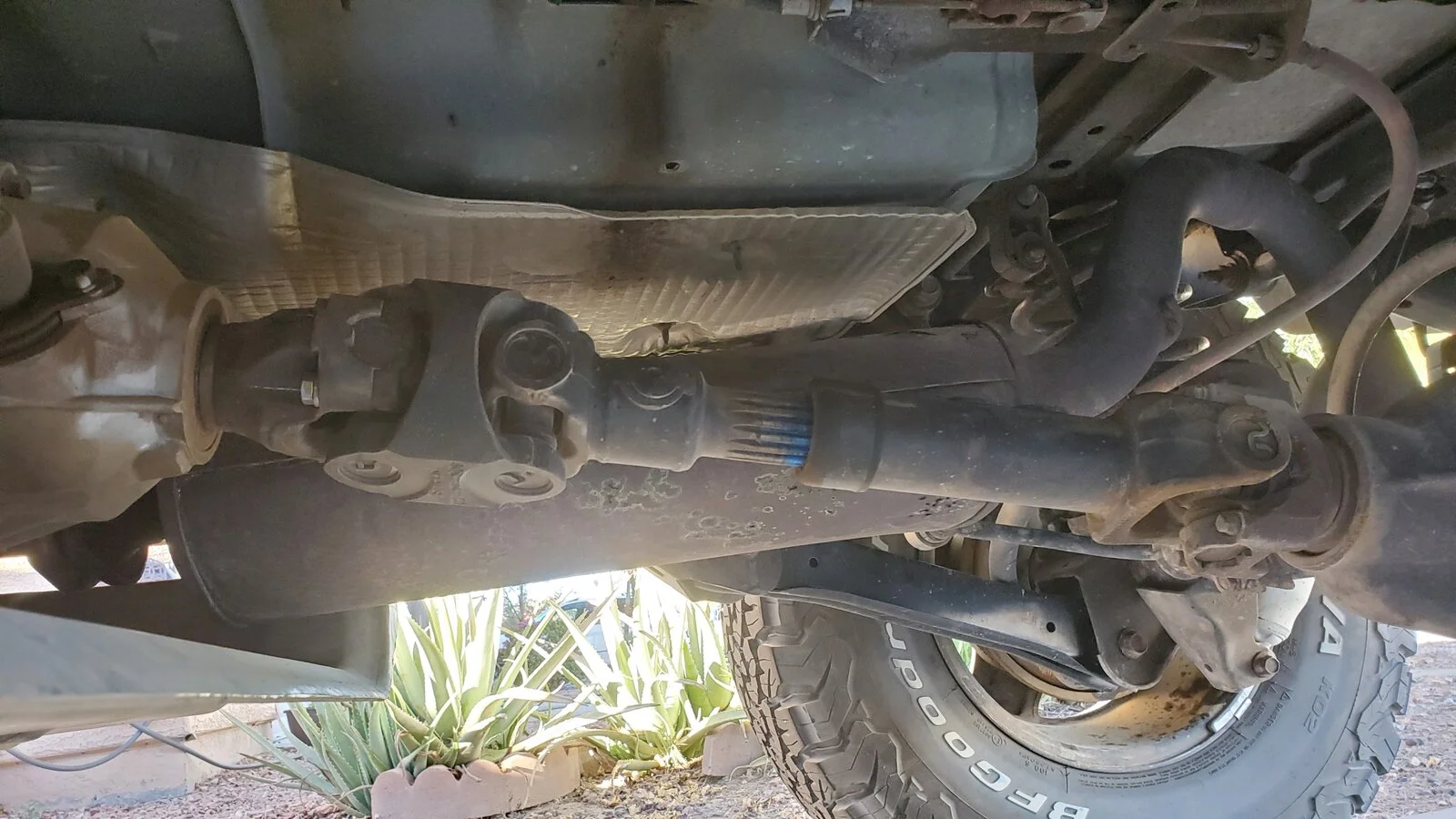

I have a 4 inch lift with the stock arms and my pinion angle looks identical to yours. It looks pretty good but I’m going to try to balance the tires first and see if it fixes it.
After getting arms, and doing an alignment I was good with death wobble and driveline vibes. The driveline vibes were 100% just the crappy pinion angle. I'd say just get the adjustable uppers and do it right and do it once.
