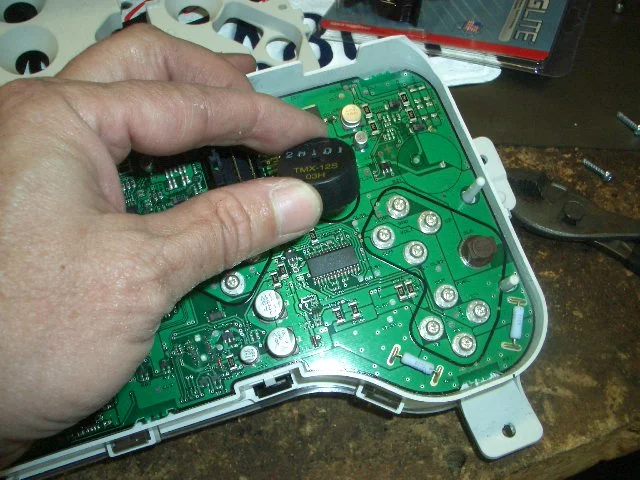

I even removed the device (called a sonalert) from the back of the instrument cluster since I have a real thing against buzzers and chimes telling me to do something.
