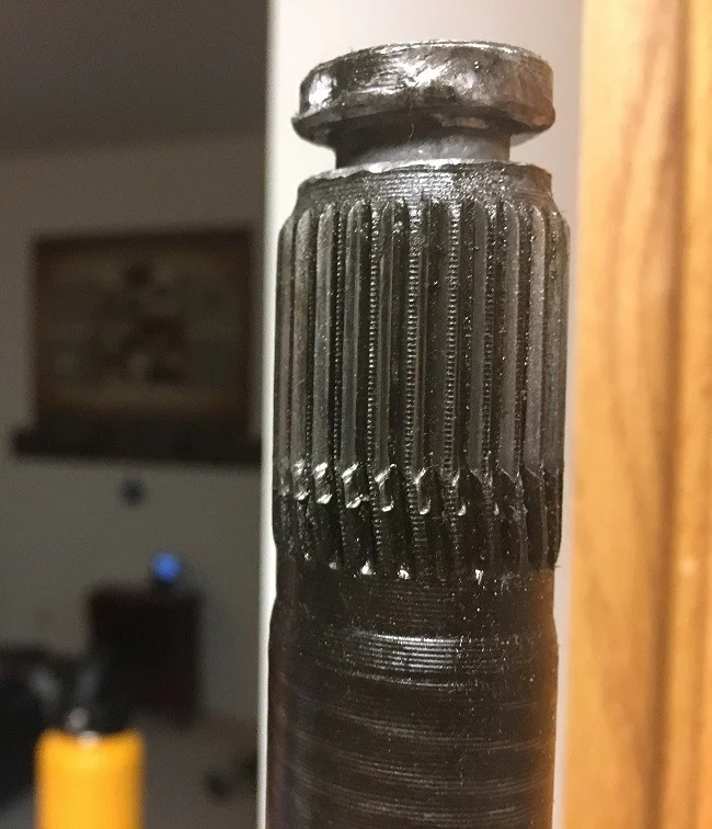

Why do you have to replace your axle? Broke?
Twisted actually, see photo
You may have the first example I've ever seen of a failing c-clip or c-clip pocket. There is something not good going on there as shown by the two sets of marks for the ends of the splines in the diff.
