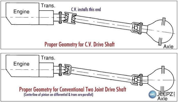

Is the shop setting the rear control arms for your current driveshaft or the new double cardon shaft?

I wasn't aware that it would be a different angle based on the driveshaft. Is it possible for them to adjust it to the angle for the double carton shaft with the old driveshaft being in the vehicle?
Tell them to point the yoke at the tcase output. It will probably have vibrations if they do. Like buzzard said,pull the rear shaft out after and drive home in 4hi

I'd think you'd make it home on the stock shaft just fine. There's a blue coating on the splines. Big question is how much of that is exposed. An inch or two no problem. 3-4 inches and I'd think you're approaching the limits of the shaft.
