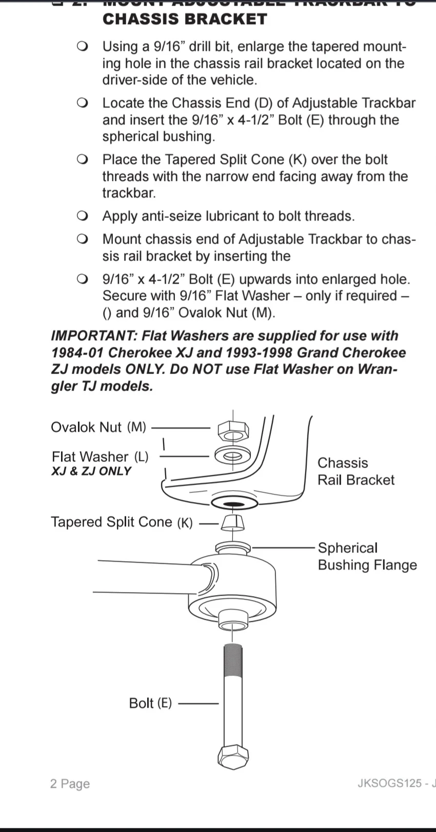

Did you do the install? For the JKS trackbar, the frame side mount gets drilled out to 9/16" and uses a supplied 9/16" bolt?
I had a shop do the install a couple of years ago. It looks like an aftermarket bolt that’s fairly new, so I’m assuming they drilled and installed the one that came with the kit.
This is what you're looking at. There's a tapered cone that goes between the trackbar and frame. On mine JKS trackbar (0-6" lift), the bolt is 21mm and the nut is 22mm.
