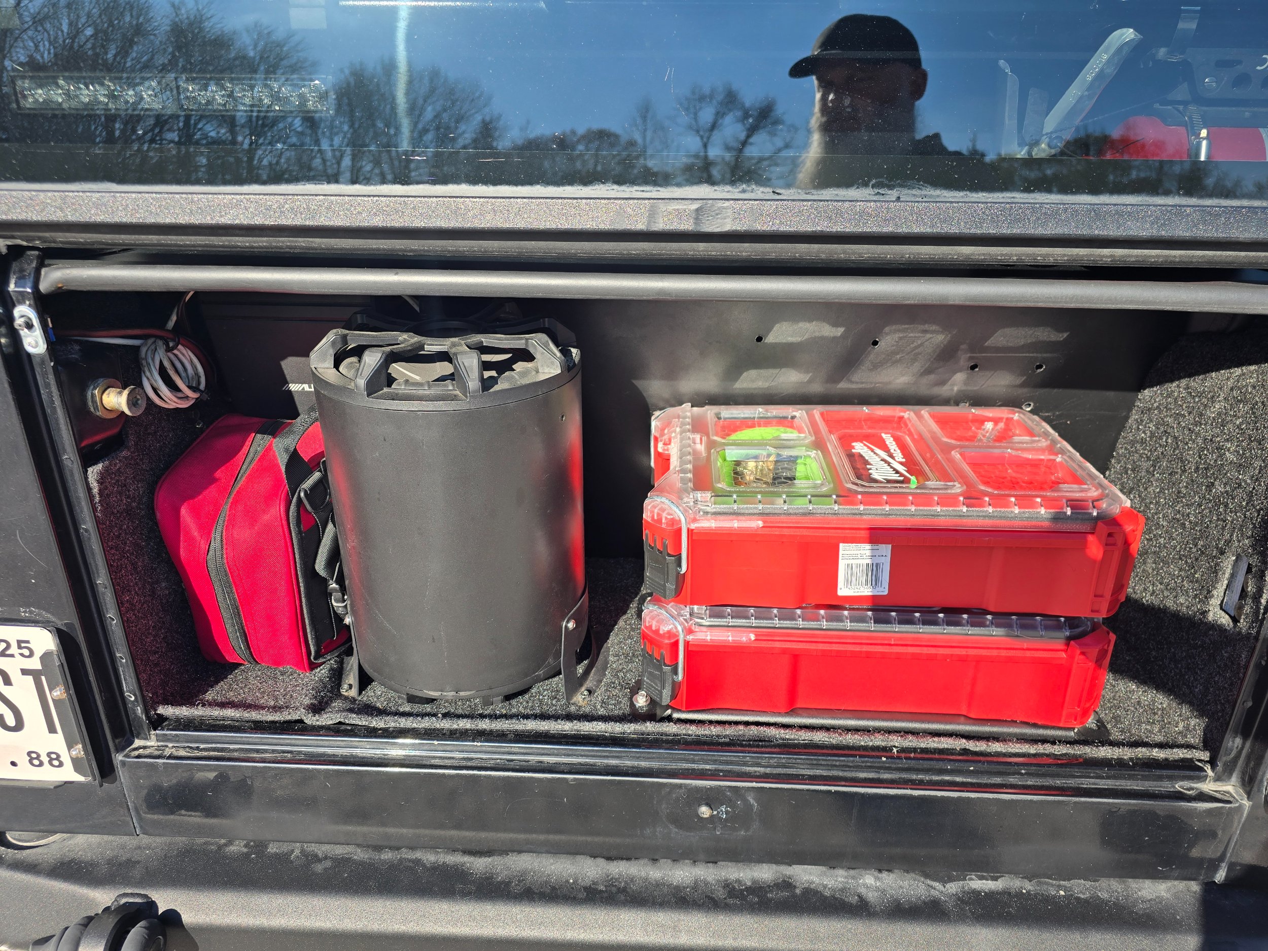

I had to switch to the Bestop rear seat with the headrests but I’ve got the following permanently installed with my rear seat installed.
  • Winch controller + soft shackle between the driver door and seat
  • Under the rear is
  • Tool kit, mix of 1/2, 3/8 sockets, screw drivers etc
  • Blankets, jacket, first aid kit, jumper cables, wheel chock
  • Zip ties and ratchet straps in the Bartact pockets
  • Soft shackle and fire extinguisher around the rear rollbar section.
  • Trunk has dry bag with clothes, rain coat, candle lantern type stuff
  • “Pelican” hard side case for laptop which gets swapped out for compressor on trail rides, or goes into the gear box.
  • Plus other gear such as battery jumper, flashlight, fuses, snacks, in the center console.

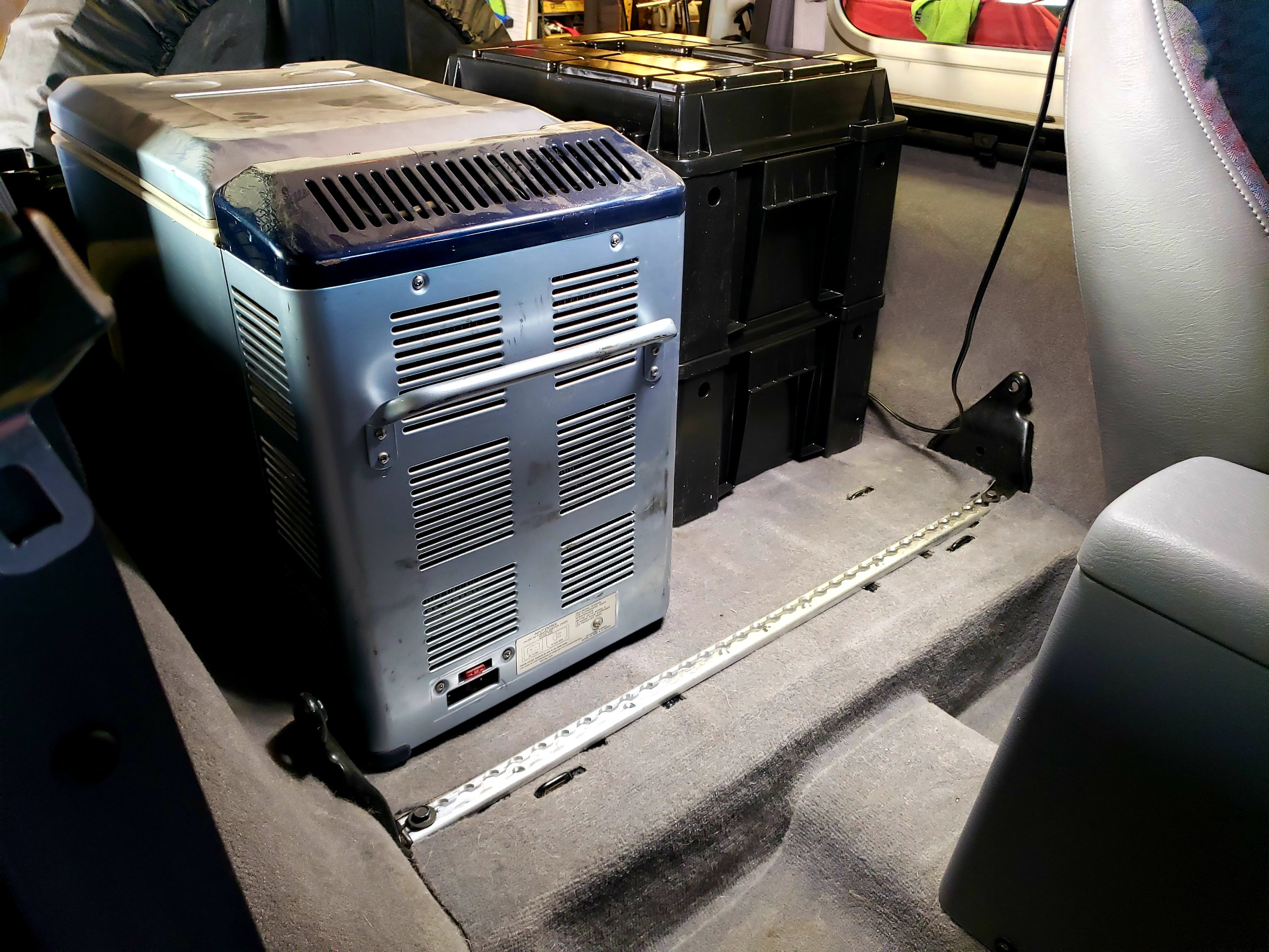

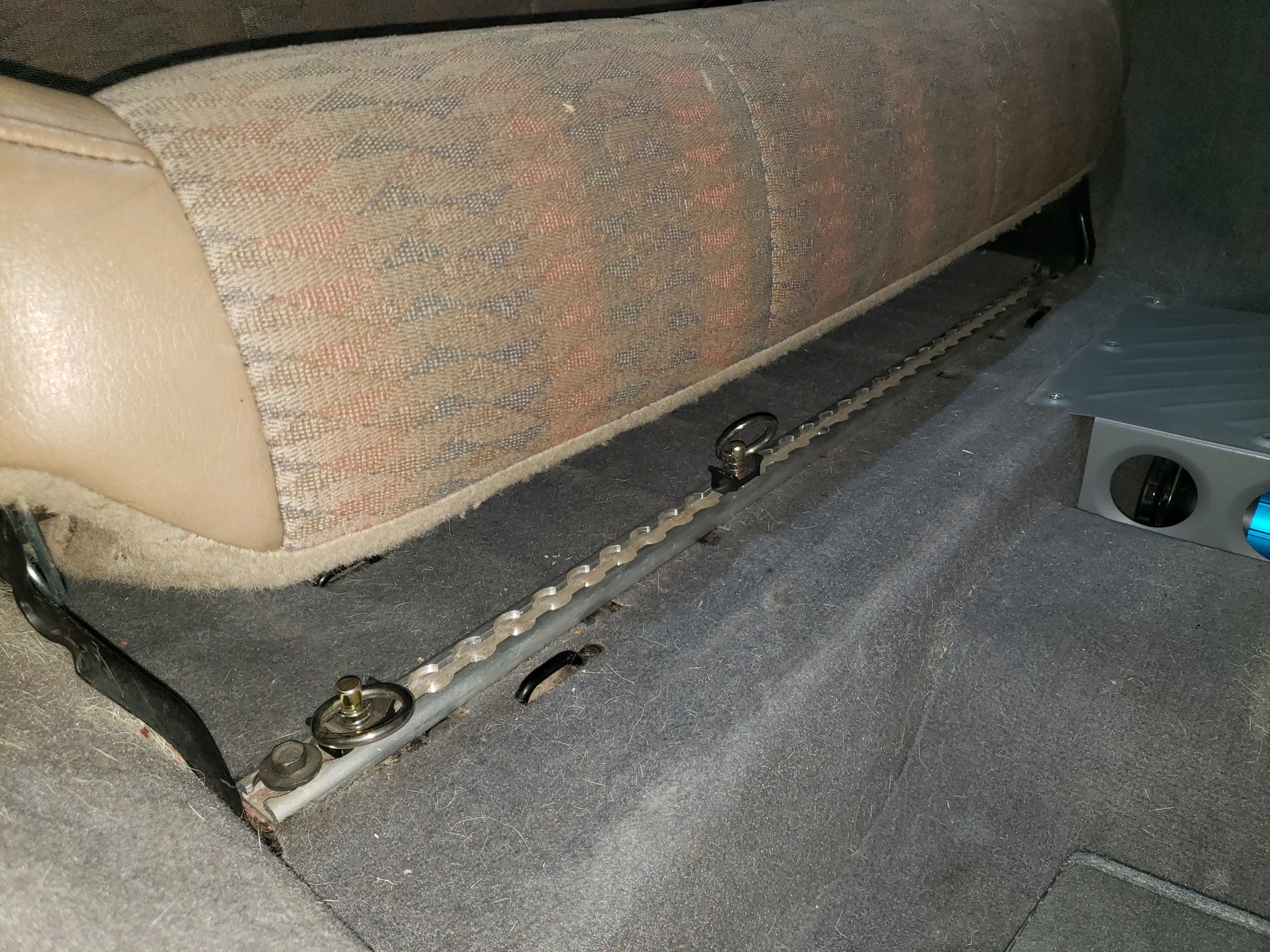

Can you leave the track in place AND use the rear seat, or do you need to remove the front track for the seat?
The track does not interfere with the back seat.

This is actually one of the best setups I have seen for securing cargo in the back of a non-commercial vehicle.

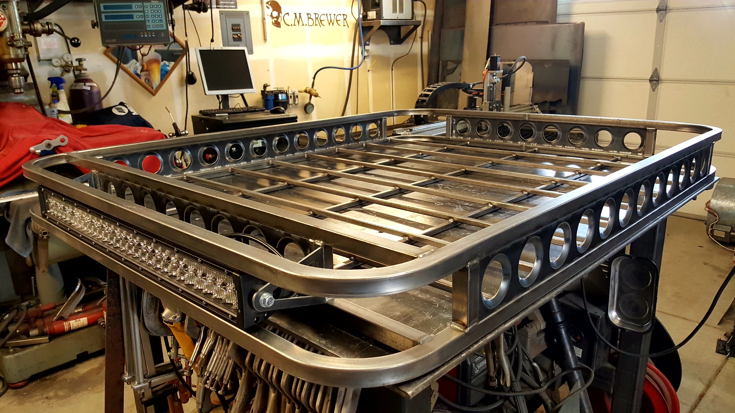

Its really versatile stuff. I was made aware of it when I built a roof rack for a TJ Rubicon. The guy had two strips of it with end trim caps installed to the hard top to attach the rack to. Even had it powder coated the color of the top.
Dont have installed pics but I got picks of the rack :D
Took that right now 😃
