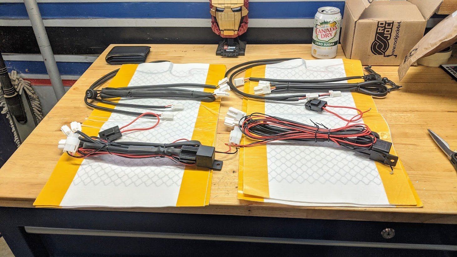

So I saw that all the cool kids are installing seat heaters now. I got inspired by @JMT 's post in his build thread where he recently installed them.
This is the heater kit that I got.
https://www.amazon.com/dp/B09744GJSJ/?tag=wranglerorg-20

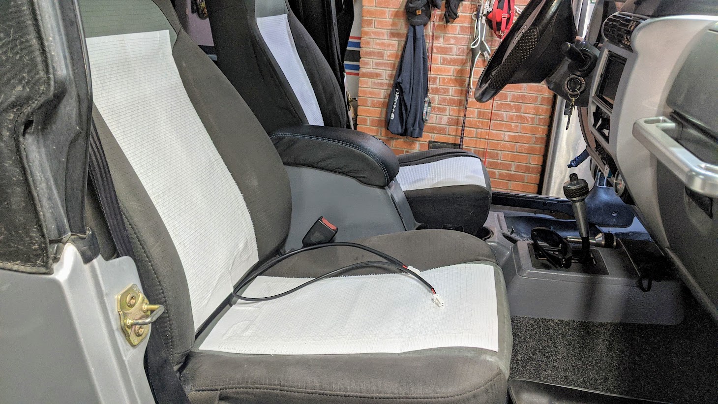

The kit included everything; mats, wiring bundles, relays, switches, and fuses.

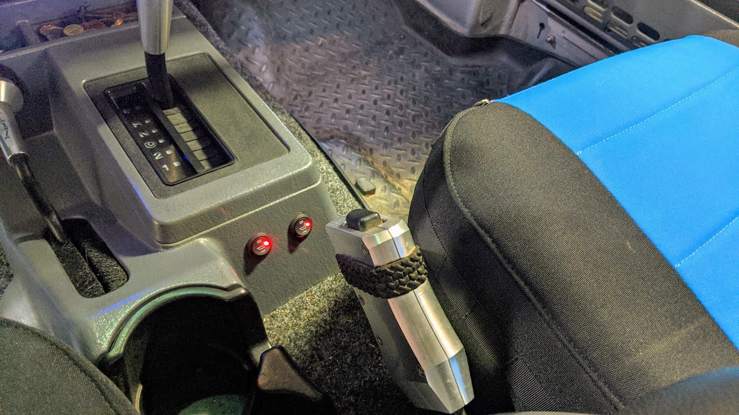

Installed the switches in the console where most others do. It really seems like the most logical spot.

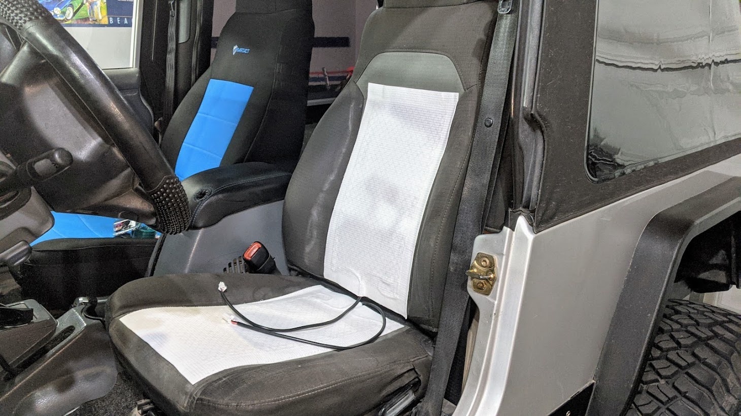

Heater mats have adhesive that simply sticks on to your old seat. I put mine right over the old upholstery, under the Bartact seat covers.

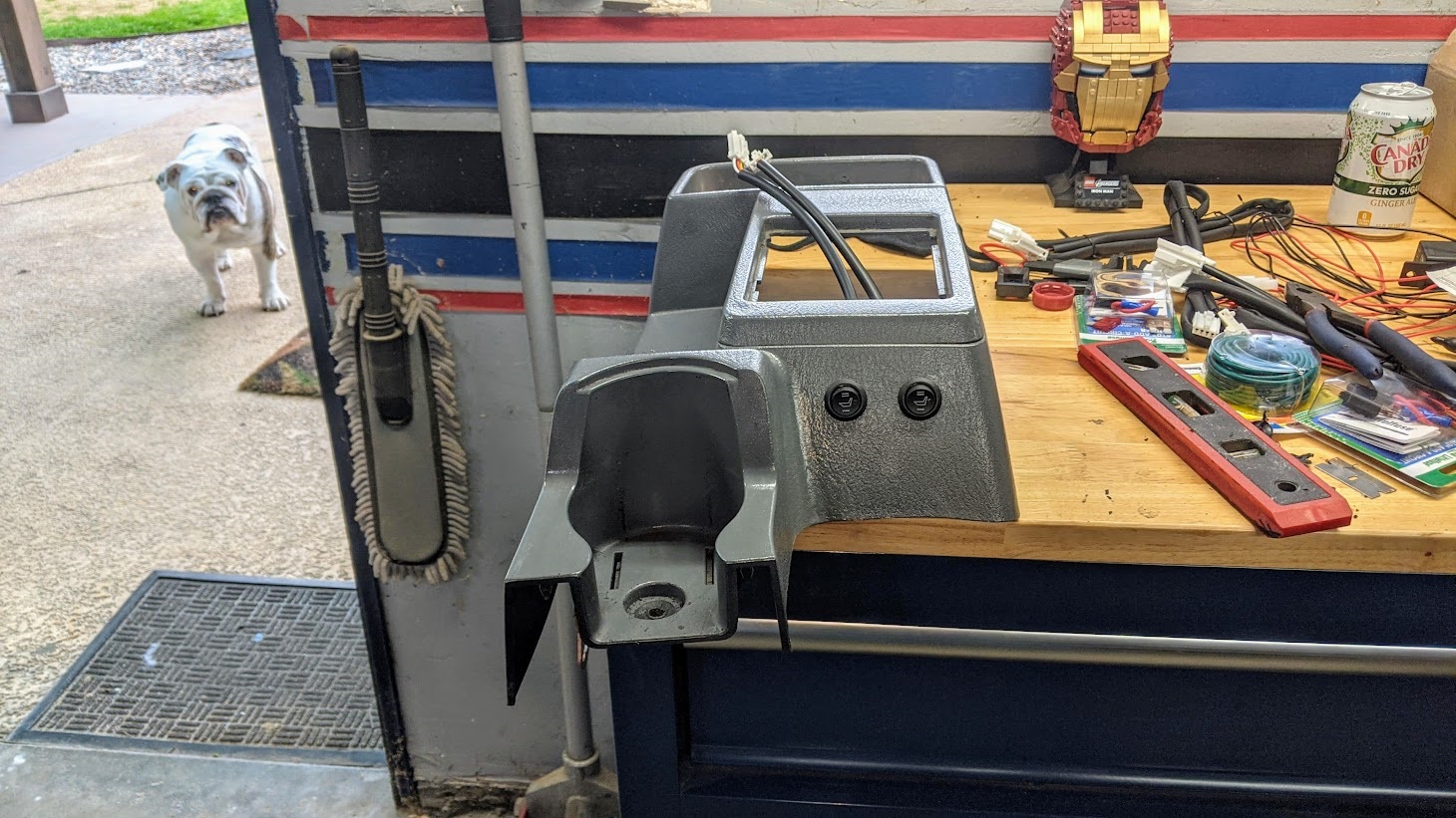

Ran the wiring and relay bundles to the switches, then just tapped into power at the fuse box and installed a ground under the console.

Finished up and put everything back together. The heaters work great, they heat up really fast and have a hi-lo setting.

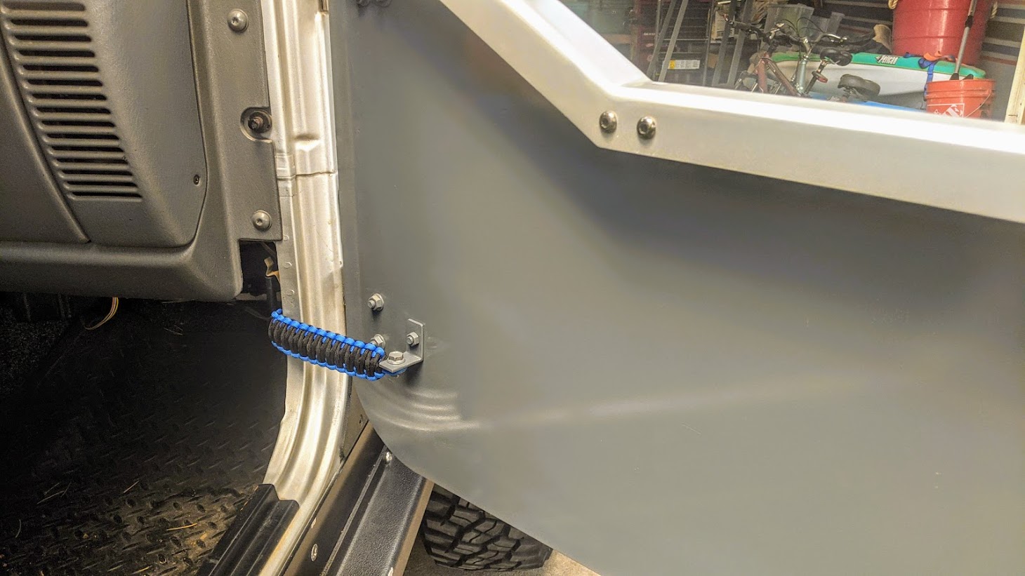

It's one of my favorite days of the year. The day I remove the full doors and put on the half doors for the next 6 months.

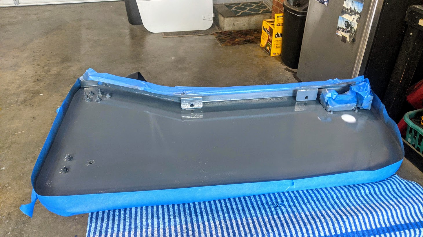

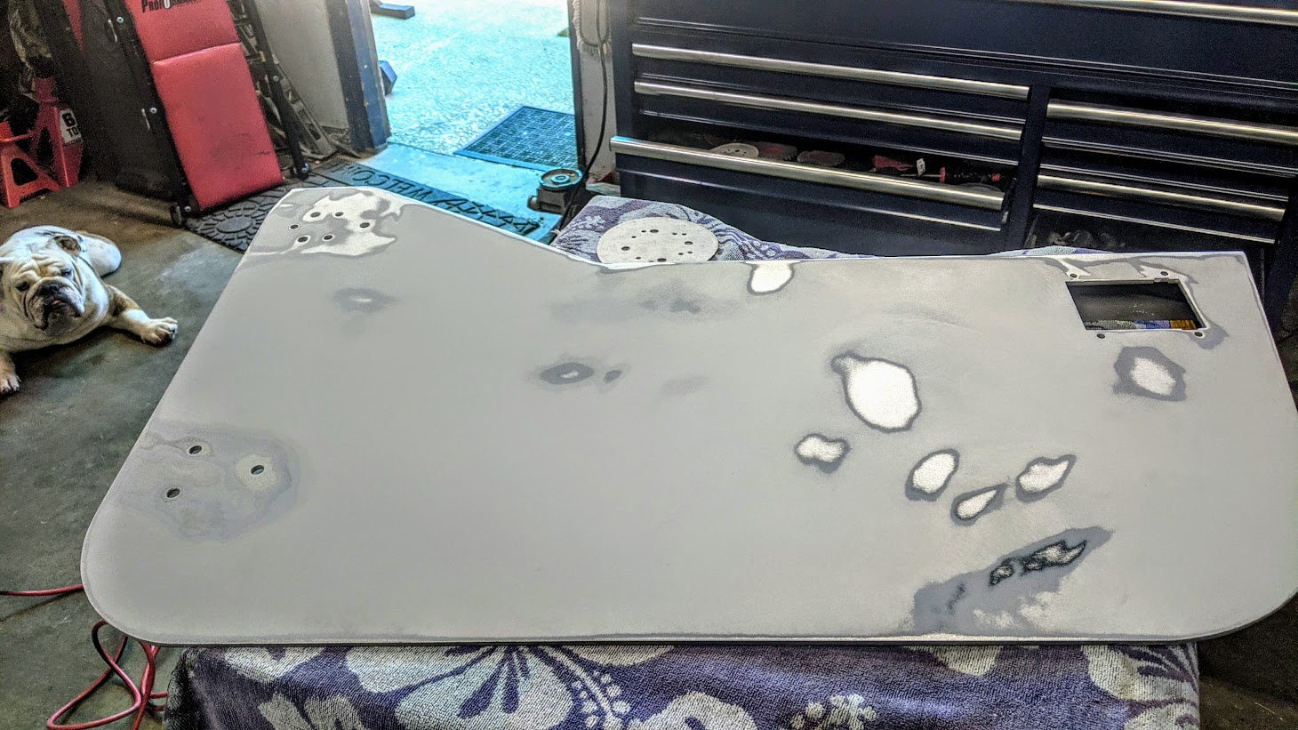

This year I gave them a little spruce up for the season. They had a few chips and scratches in the paint, the limiter straps were shot, and limiter brackets I had made were twisted.
Sanded down to the old primer and blended the chips and scratches.

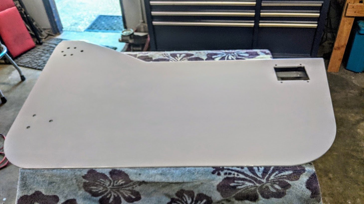

A couple coats of new primer sprayed on. Then sanded smooooth... Then fresh Bright Silver Metallic paint and lots of clear.
Reassembled and painted the interior Gloss Gray to match the interior.

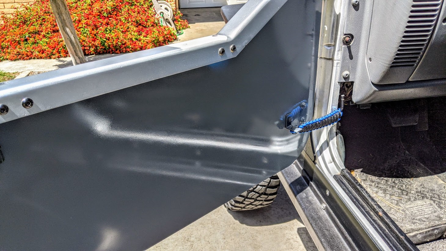

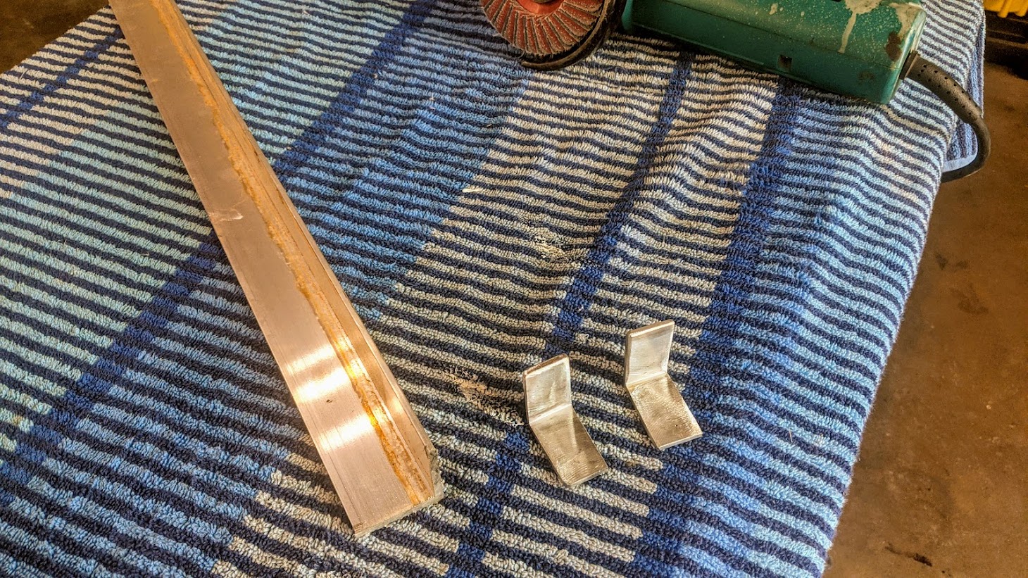

Made some new limiter brackets out of some aluminum "L" channel I had laying around.
Installed the limiter brackets using the hardware for the lower door hinge. I then hung the doors and installed some new Paracord limiter straps.
Came out halfway decent. Bring on the warm weather and summer wheeling. I'm ready!!! 🍻
