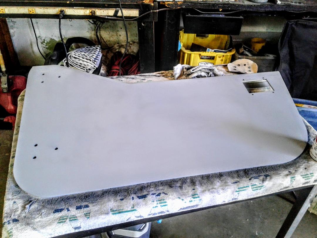

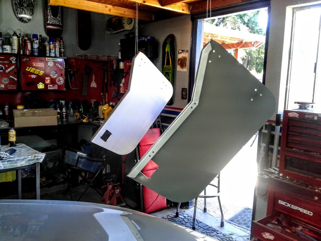

Back in action. I've been prepping and painting my doors. 200, 400, and then 600 grit sanding, primer, basecoat and clearcoat.
I got the factory paint color in rattle cans from
https://www.automotivetouchup.com/
It sprayed pretty nicely. It doesn't quite look factory, but still looks pretty good.
After lots of sanding and primer
Painted the inside gray to match the interior.
After lots of coats of Bright Silver Metallic and clear.

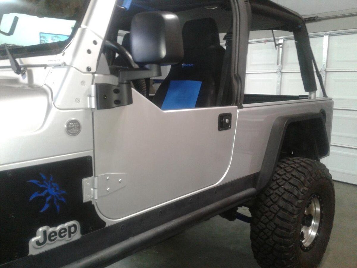

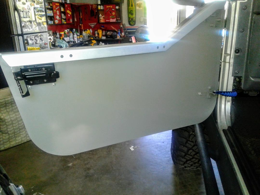

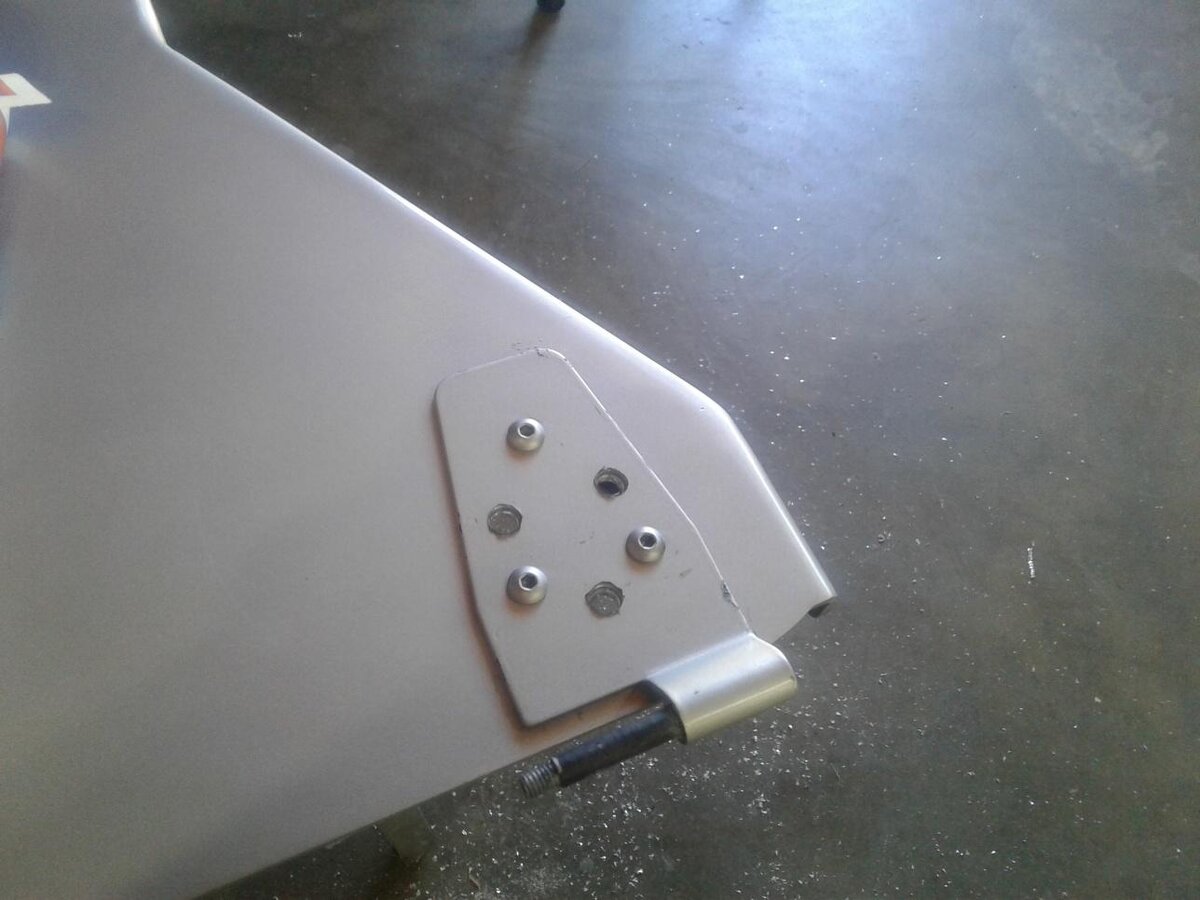

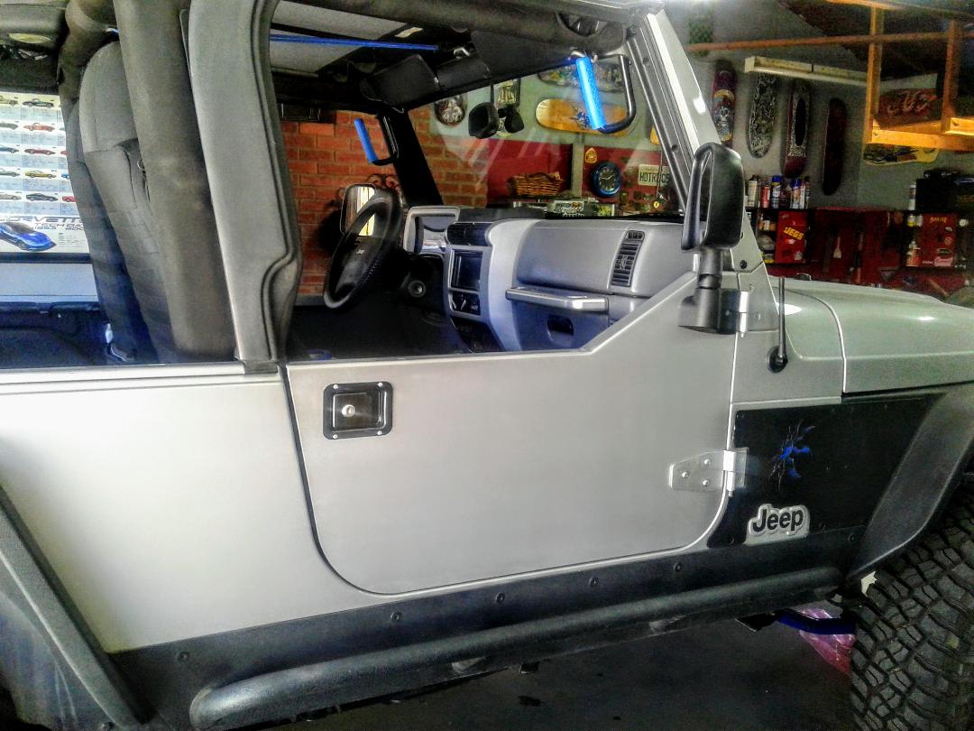

Final phase for the half doors. Installed the door latches, 4 bolts and nuts with no adjustments necessary.
Installed the hinges loose and installed on the Jeep, lined everything up and tightened the hinges.
drilled the holes for the factory mirrors and installed.

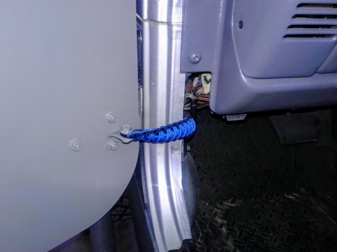

Made an "L" bracket for the limiter straps and installed.
Got everything installed and tightened down. Pretty fuckin' pleased with the results.

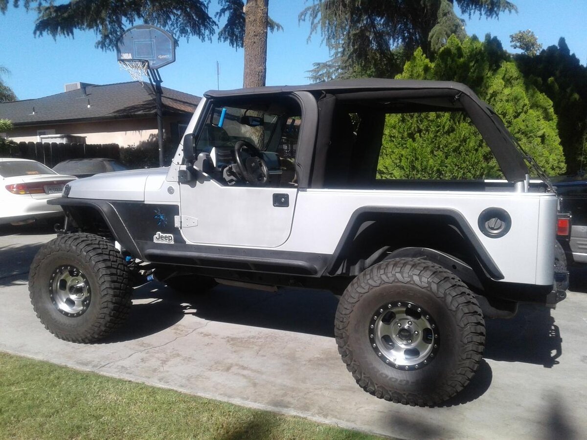

Took a day off and installed the half doors. I'm exhausted. Its a "3 Beers in a Boot" night. 🍻 🍻🍻
