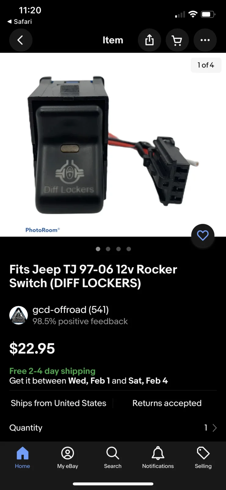

If you have space on your console, I like the oem style switches, lots of options on ebay
https://www.ebay.com/itm/2241000559...d=link&campid=5337789113&toolid=20001&mkevt=1
I used one like this, everything else I just followed Eaton instructions and used the harness exactly as provided. I looped the excess length and hung it with the relay up above and in front of the glove compartment and ran a fuse tap in the switched fuse in the fusebox.

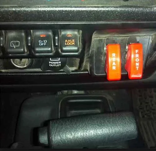

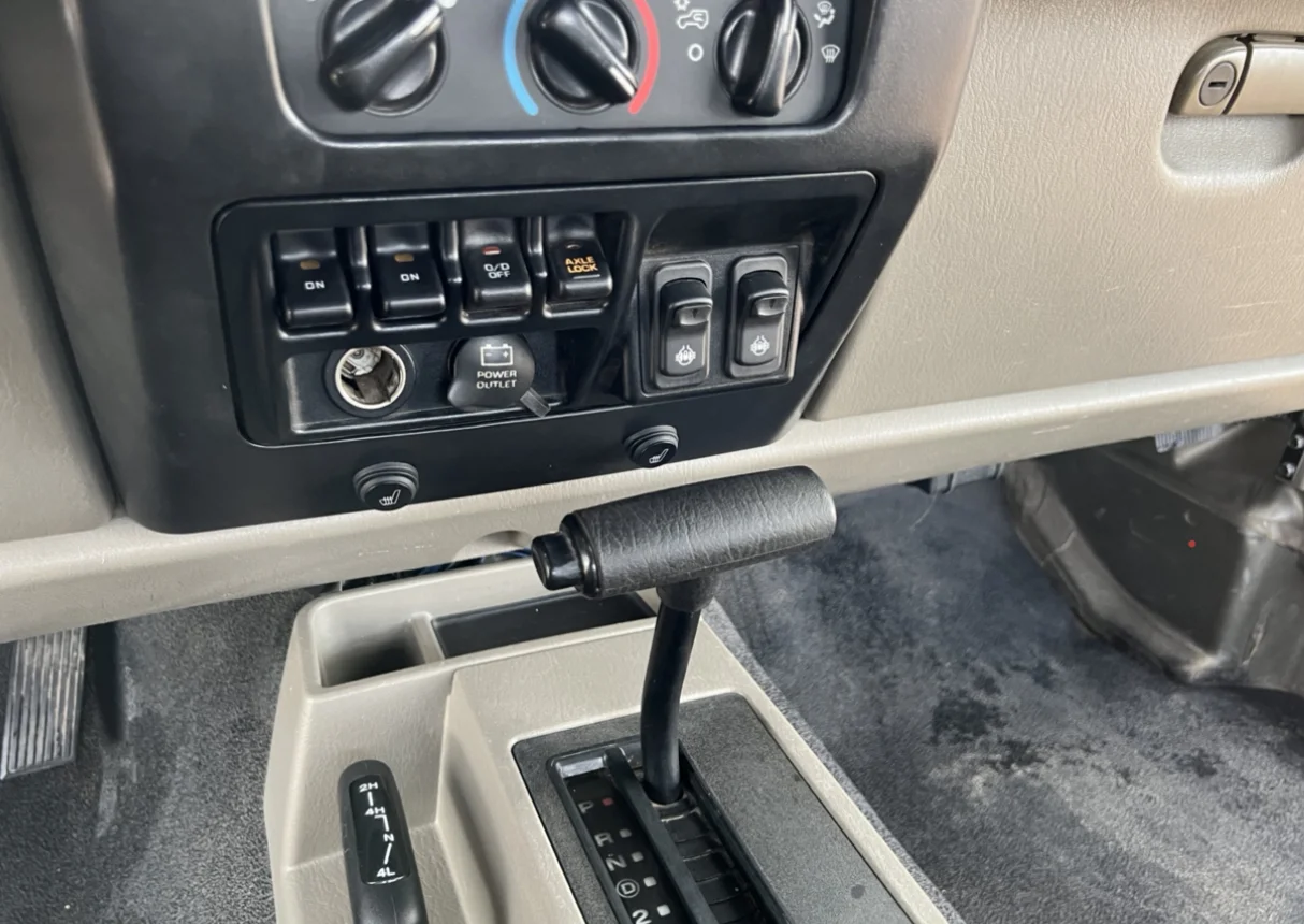

The convoluted way the factory switch functions made it easy for me to decide not to use mine and instead install more easily used regular on-off switches for my lockers. The orange covers flip up to expose the switches when I am using my lockers.
