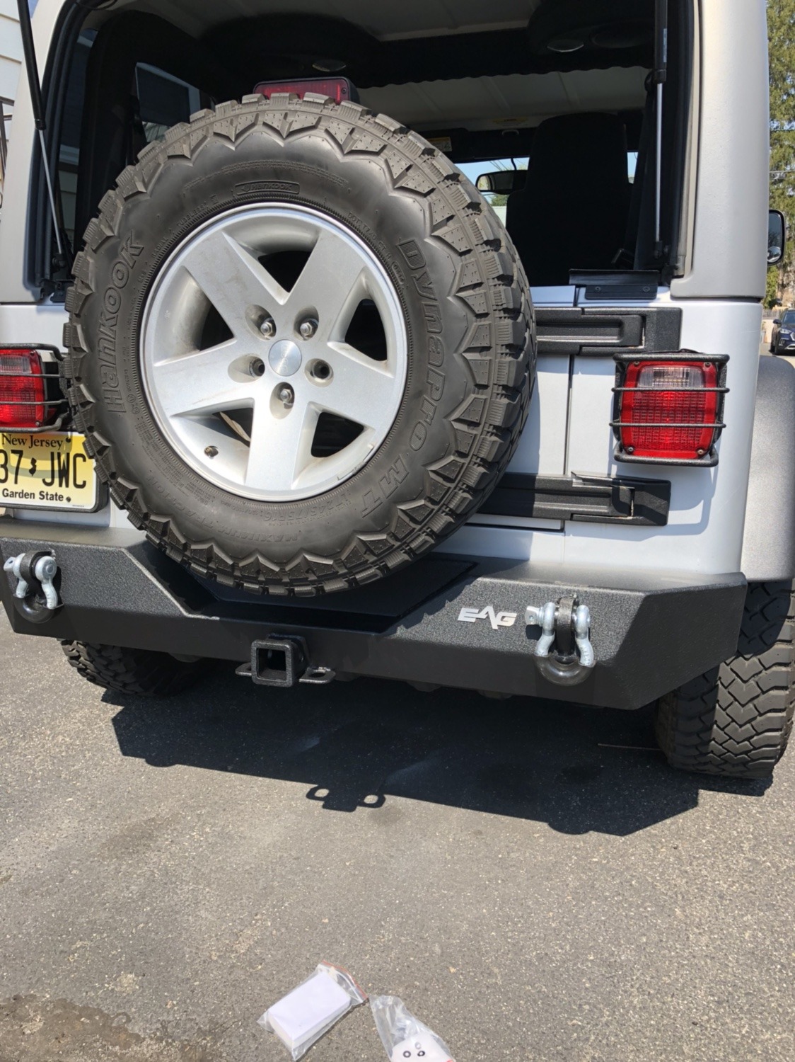

I love my EAG stuff. Totally underrated and very economical. I bought their front and rear bumpers, safari doors, tail light guards and grill inserts all for maybe 500?

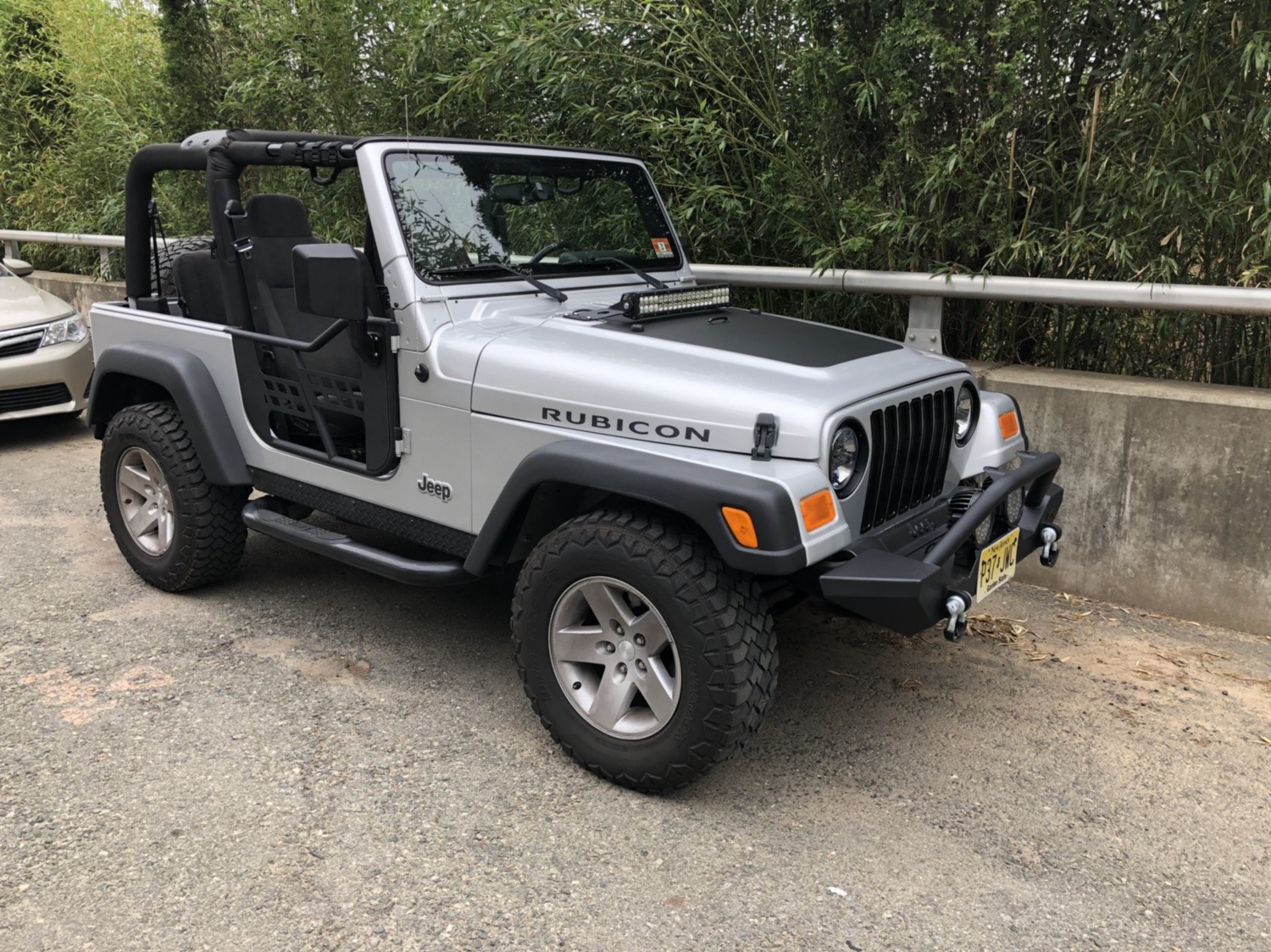

I love my EAG stuff. Totally underrated and very economical. I bought their front and rear bumpers, safari doors, tail light guards and grill inserts all for maybe 500? View attachment 45458View attachment 45459
Where are you from in NJ? I grew up in Union Township and lived in Jackson before moving to CA. Nice Rubicon!

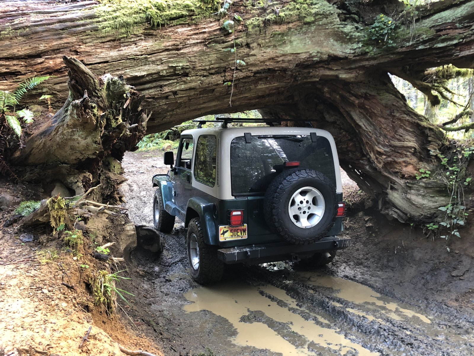

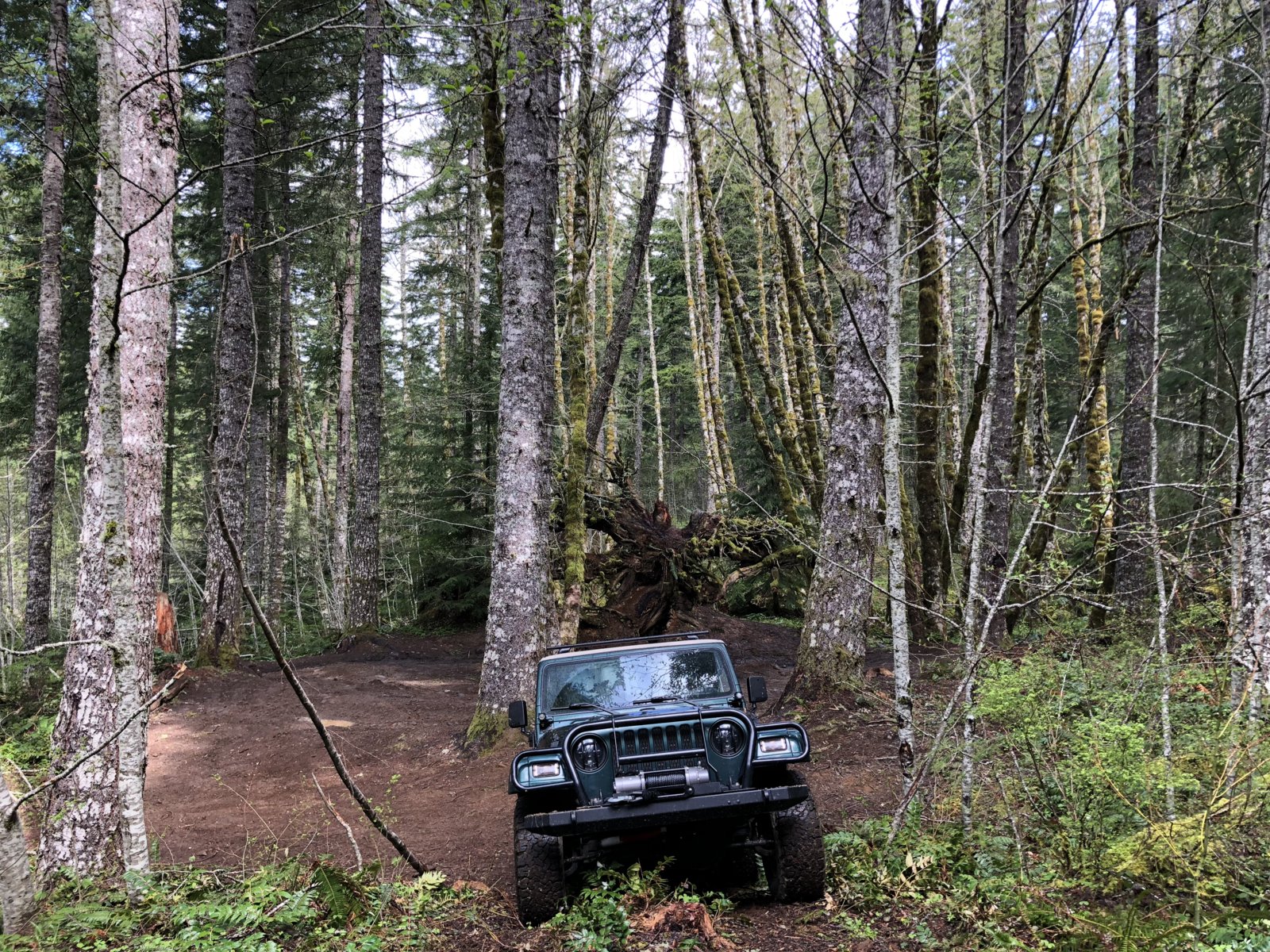

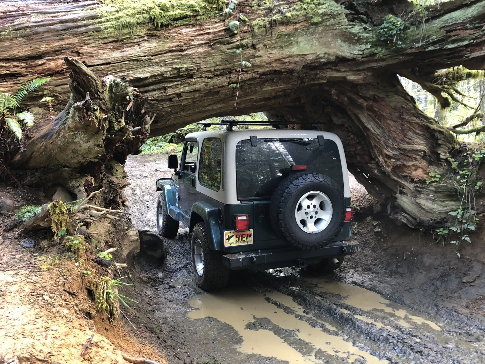

I have the exact same bumper set! Love mine so far and they have held up pretty great on the trail. I have to say EAG is one of the few who actually has decent customer service and is based out of California. I had some scuffs on my bumpers corners from shipping and they made it right. Anyway, good buy and I would buy again from this company. (I also have their winch plate).

View attachment 45696 View attachment 45698
sorry for being off topic, but i cant help but think your jeep looks like mantis from guardians of the galaxy
between the color, and the tan hardtop and the dark headlights
Lol, if I had dual cb antennas or something, that would be hilarious. But hey I do like that for a Jeep name! Good stuff.
Maybe I can relocate my KC Flex led's from the lower windshield corners up to the top windshield corners somehow and it would add to the Mantis effect.
Ha! that would be pretty funny, but all joking aside, your jeep looks awesome and right at home on that trail!
