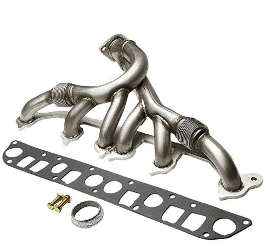

Hey Jerry, I always value your feedback.Yes, the fix is installing a good quality header with flexible steel flex joints at both sides like this one. They're all over Amazon.com and eBay, most have favorable reviews but that's the key to making a good decision, reading the reviews thoroughly and concentrating on the one star reviews to find the real truth.
Should look like this... notice the steel accordion-like flex joints which the original early factory header did not have. They're what was added to stop the cracking caused by the headers being flexed by engine torque.
