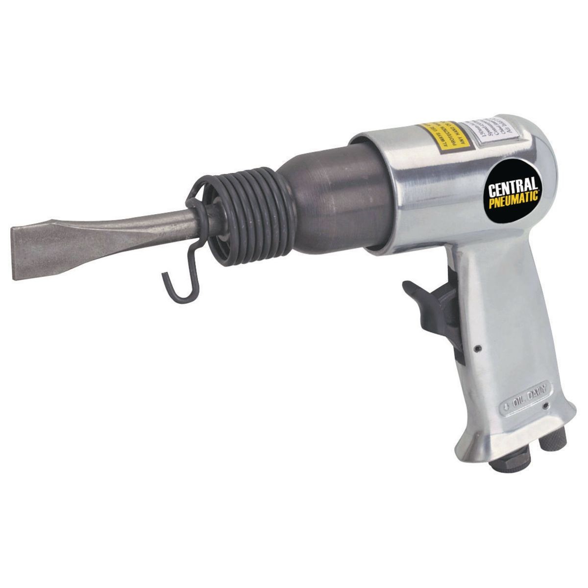

Easiest ever, two quick pulls of the rigger
