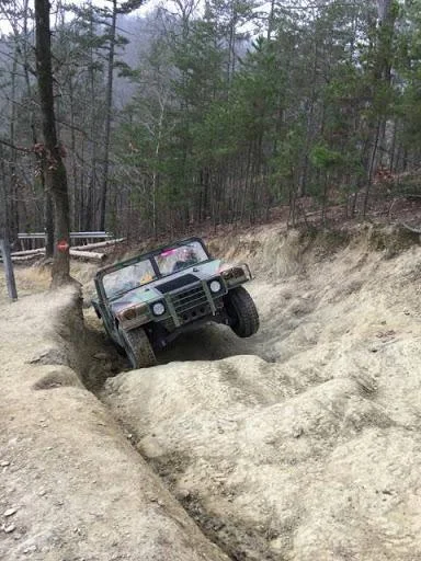

HMMWVs (Humvees) uses trutrac type LSD, NOT lockers. And military Humvee training consists of learning to brake while wheels in the air. Without this knowledge the Humvee is USELESS.
This is a buddy of mine saturday....2 wheels in the air most of the ride straight up a hill...but with proper braking handled like lockers.
They have the geared LSD....I'm not 100% sure the mfg, but it is the same basis as the trutrac.
This is easy to accomplish in a Humvee since it's an auto and a rather weak 6.2L diesel. But it'd be a nightmare two-step to try and do in a straight drive Jeep

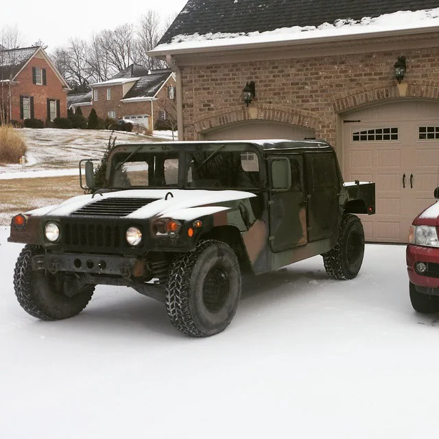

He came over to my house to take my kids for a ride last year when we got 2" of ice in another one of his purchases

I cannot speak for the detroit trutracs. But the gear driven LSD's in the Humvee engaged the wheel on the ground while the opposite wheel(s) in the air with braking enough to power it over the gatekeeper with only 2 wheels touching the ground

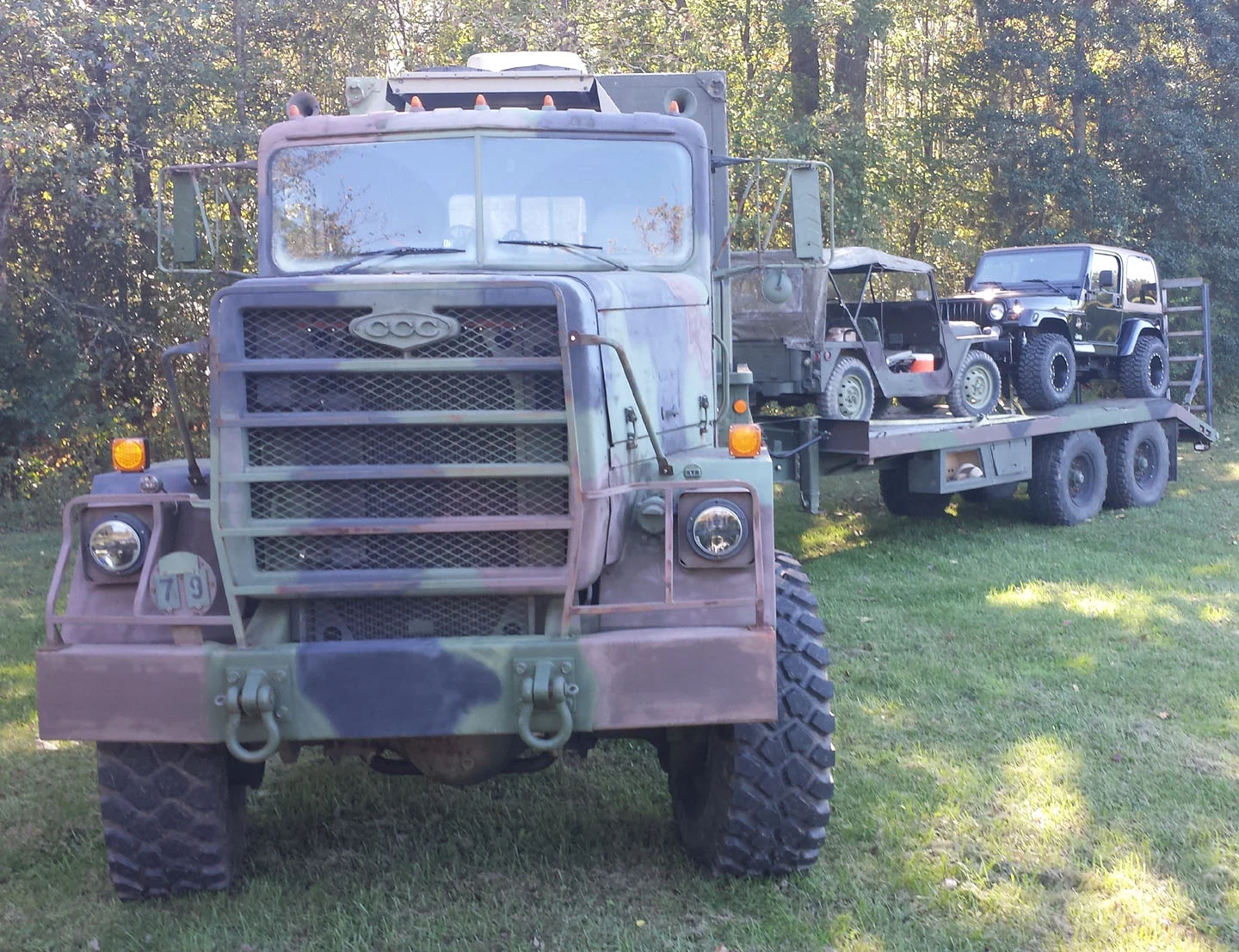

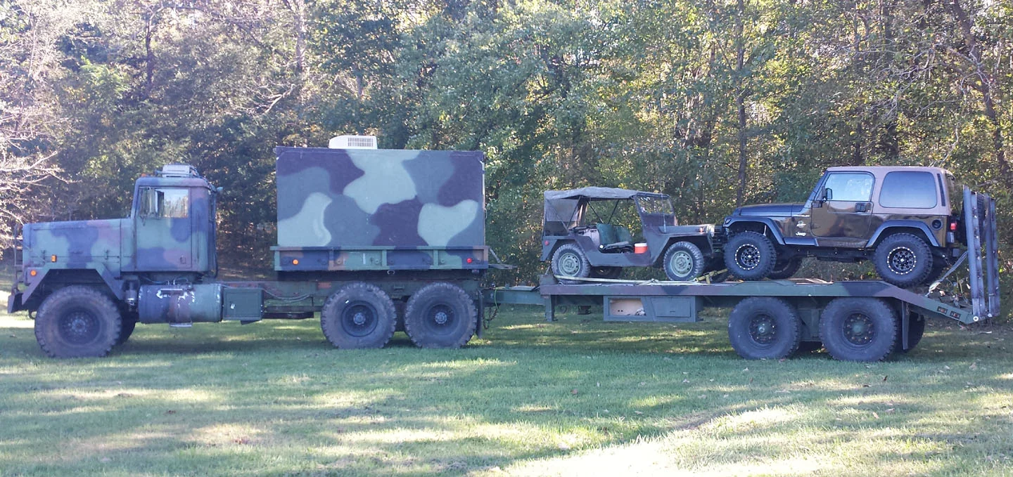

What in the world is your buddy going to do with that Hemitt? It looks like a monster. We have several deuce and halves running around here in various stages of modification and restoration, and I thought they were big.
