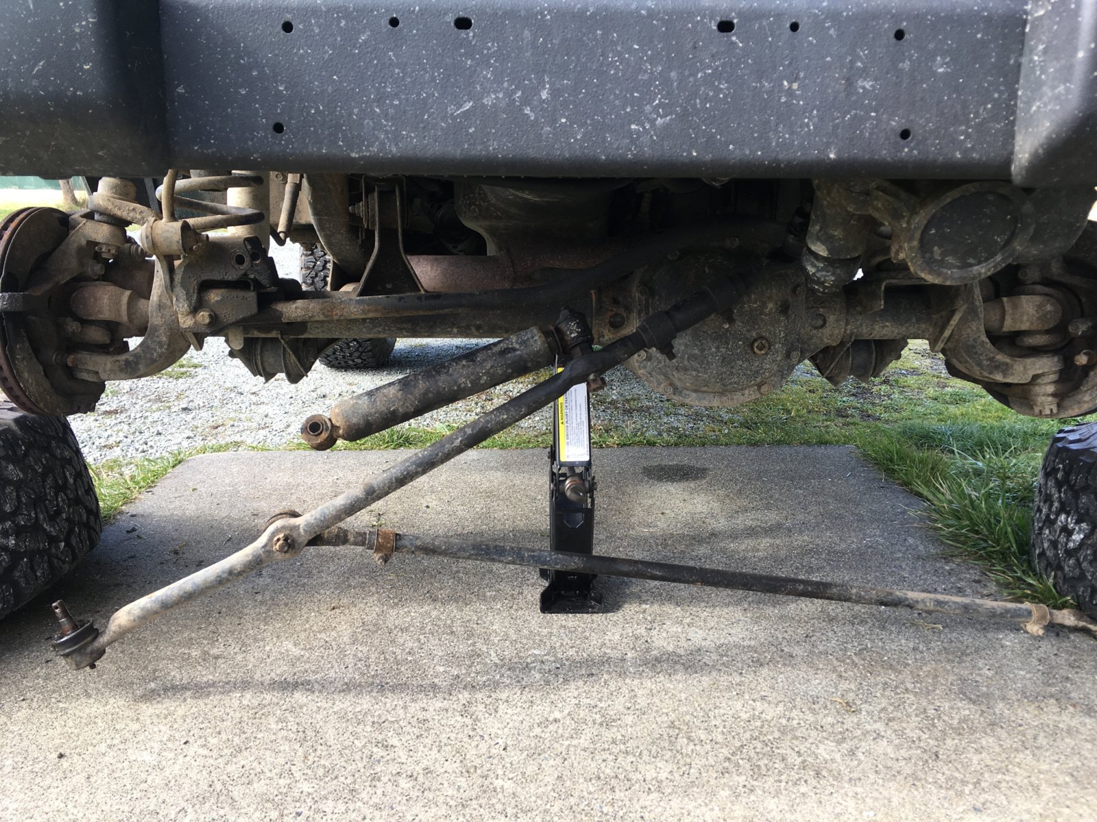

ZJ Tie Rod Conversion time!
I have had this project on hold due to weather but today was beautiful outside and figured I would put some work in and see what happens.

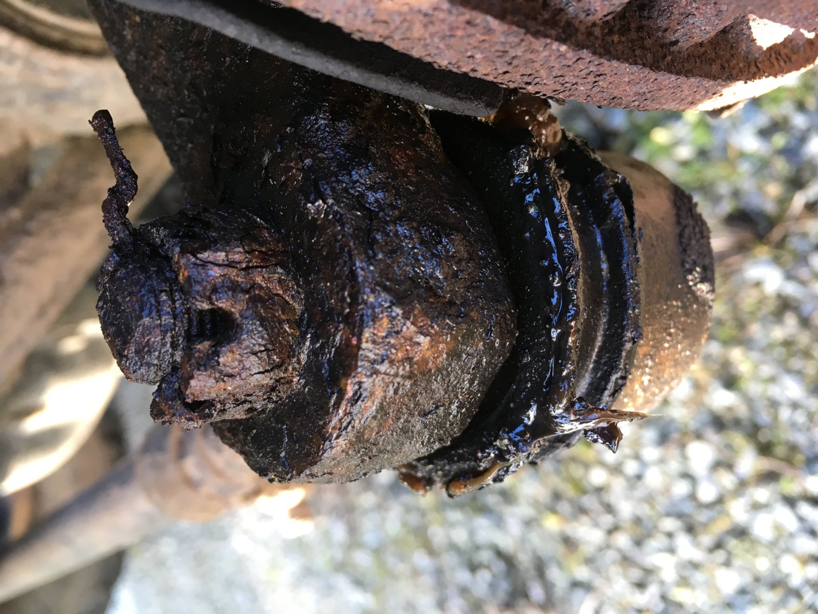

Been soaking these bad boys in Liquid Wrench for the past week and they came right off no problem. Only thing was I had to remove my wheels, there was just no way to remove the cotter pins without doing so. No biggie. Man that Castle Nut doesn't look good though!
As it sits now i've got both Outer Tie Rod Ends out, have the Steering Stabilizer out, and I cannot for the life of me get the damn Drag Link out of the Pitman Arm. Lol.
I tried the BFH by itself and it just isn't happening. I have no pickle fork or tie rod puller so thats gonna be the next thing I try. I just have to shoot over to one of the auto store nearby and see if I can rent one for a few.
But yeah, fun stuff!
Ok, back on track now, it took a little more persuasion if you know what I mean.
All measured up ready to go back on. (Thanks guys for the tips). That Drag Link @ Pitman Arm kicked my ass.
Alright, beautiful day here today so I was able to complete the ZJ Tie Rod Conversion and finished it off with a DIY alignment right in the driveway.
Took it for a test drive and it feels pretty good! Thanks @Serbonze for all your assistance in answering my 20 questions.

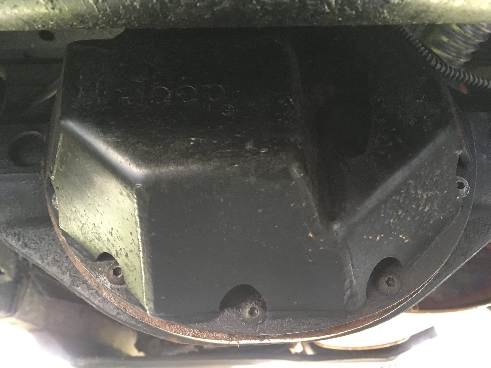

Also got a really good deal on these Rugged Ridge Diff Skid Plates for my Dana 30 & Dana 35. They go for $100/ea and I landed them for $25/ea.
I had the rear one on for about a year now but the front one just went on sale and I had to scoop it up.

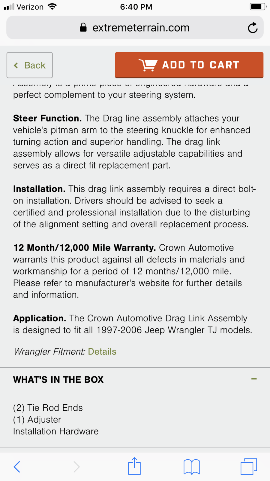

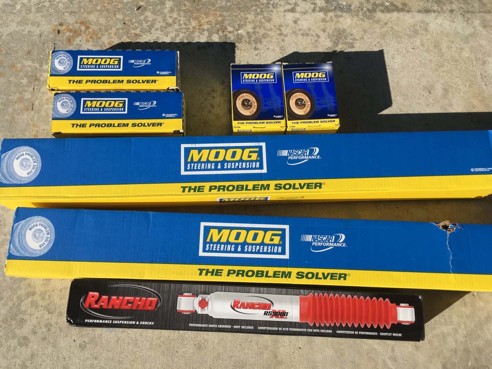

Do you remember the part numbers? I have already got the
Moog DS1312 tie rod
Moog ES3096L tie rod end
Moog ES2079S tie rod adjusting sleeve
I wass just going to reuse the old drag link but it’s got way to much play on it. So drag link Moog #? Do I need another sleeve ?
Moog DS1312 tie rod
That would be DS1430 my friend. Found here: https://www.amazon.com/gp/product/B000C5406S/?tag=wranglerorg-20 And actually its at a decent price too at the moment, I would scoop that up and if you can just get another sleeve (makes life a little easier, and they're not that expensive).
Also, here is a whole thread on the ZJ Tie Rod Conversion too if you haven't checked it out. https://wranglertjforum.com/threads/zj-tie-rod-conversion.2183/page-2#post-146431

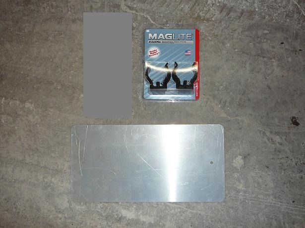

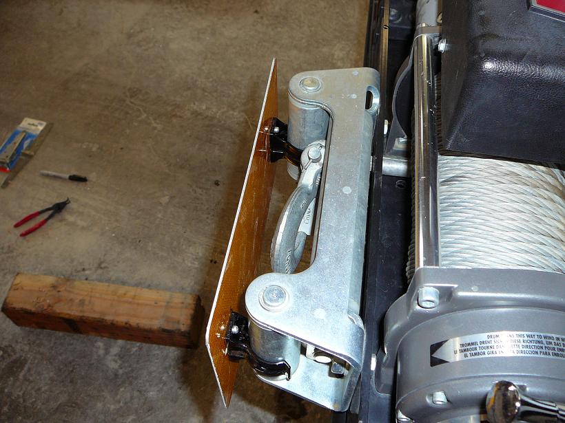

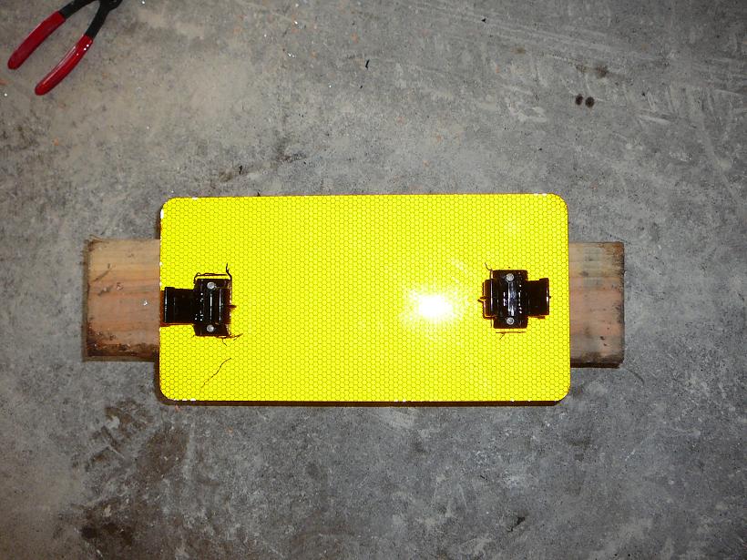

You can make a simple license plate holder once you get a winch installed. 2 Maglight holder clips, a piece of aluminum/metal, some rivets, and bam!
I don't have a roller fairlead, though i'm sure there's a way to adapt it to a hawse. Looks cool though I was already trying to think of options for this. I was hoping to find such a bracket that might let me mount my 10" KC Flex Array on there along with a license plate mount. As long as it doesn't come across as overkill, just trying to fit my toys on there and be legal.
Yeah, if you went into the ZJ Tie Rod thread I linked earlier, you would see that in a nut shell, the Crown kit sucks in comparison and is of much lower quality.
