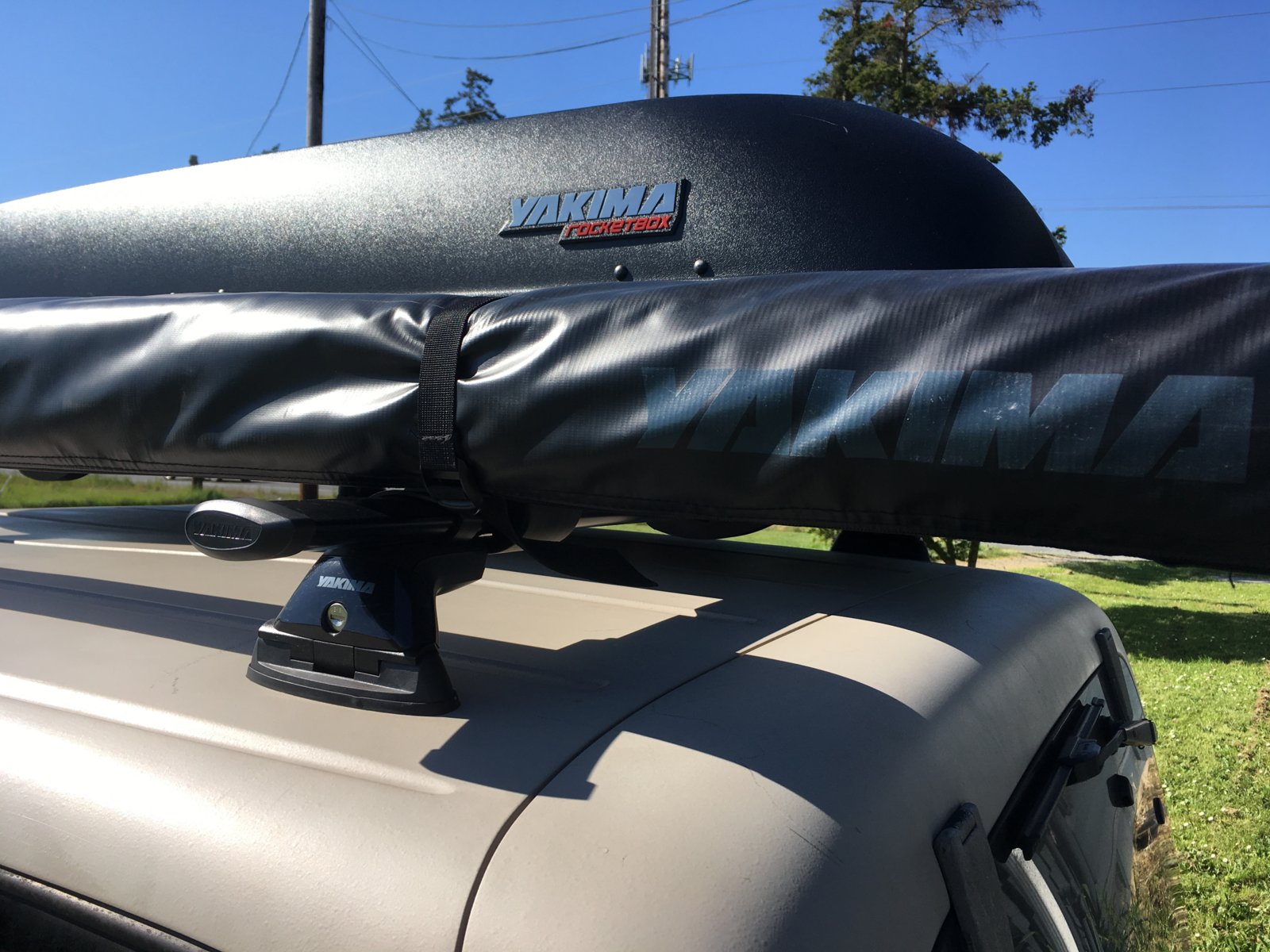

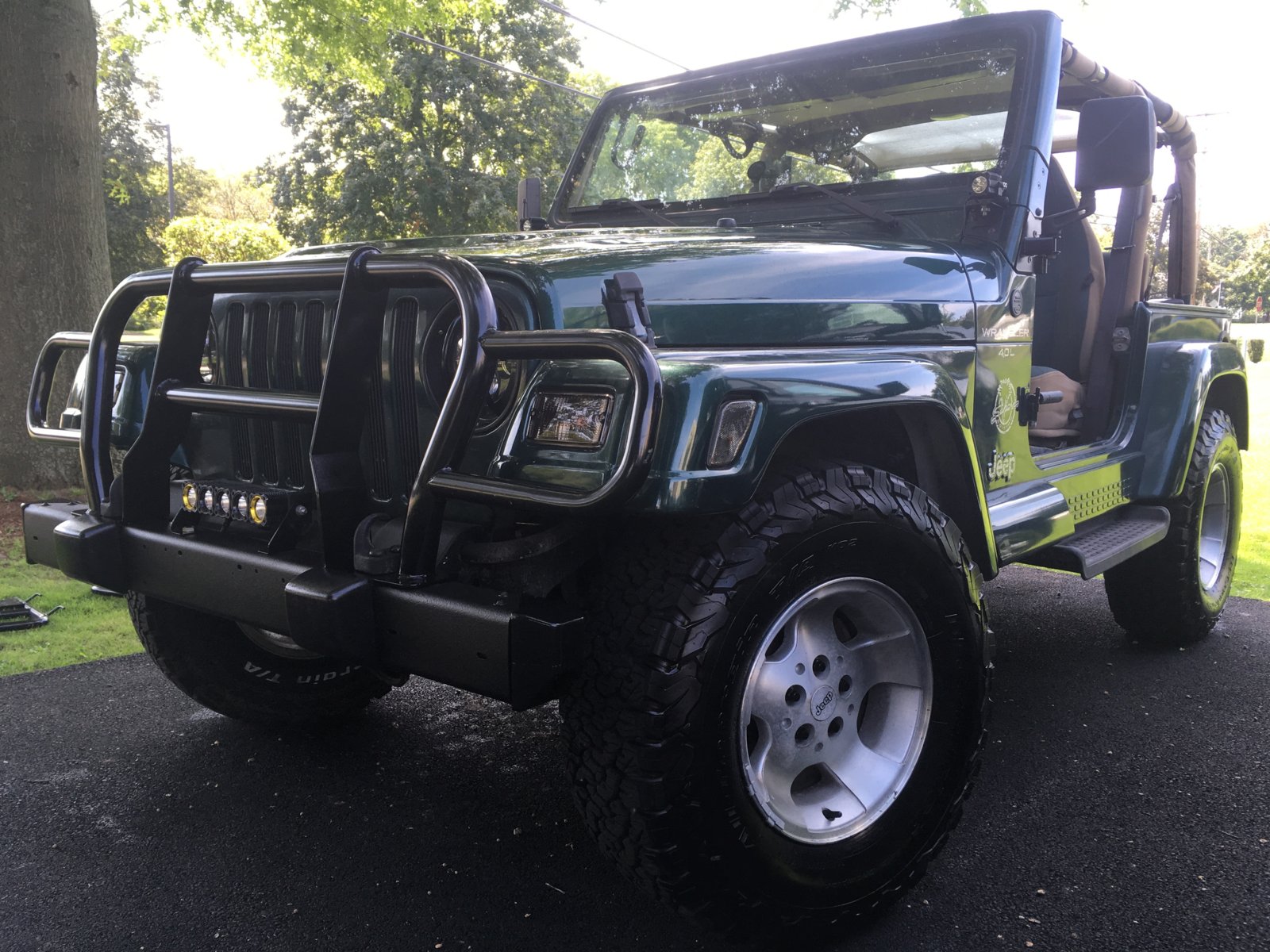

Added the Yakima SlimShady RTA to the roof rack setup!
Picked up a Barnes 4WD Fairlead LED Mount, and integrated it into my KC Flex Array.
Reactions: Shamu

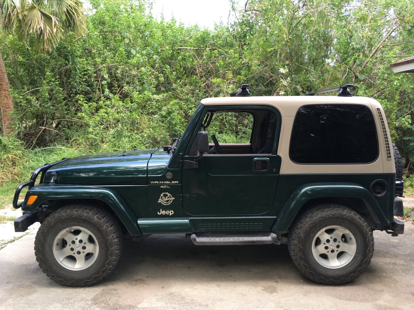

Switched over to the Yakima LoadWarrior+Extension today as well. The paint was totally sun-baked from the life in the Endless Summer, so I gave it a couple nice coats of truck bed coating and it brought it right back to life again.
Reactions: Shamu
New Yakima Timberline Towers & Roof-less Rack Setup.
Should also have a few of those Axe & Shovel mounts for the sides of the basket on soon too. Adding the RTA back into the fold for a few and will have this thing loaded out in no time.

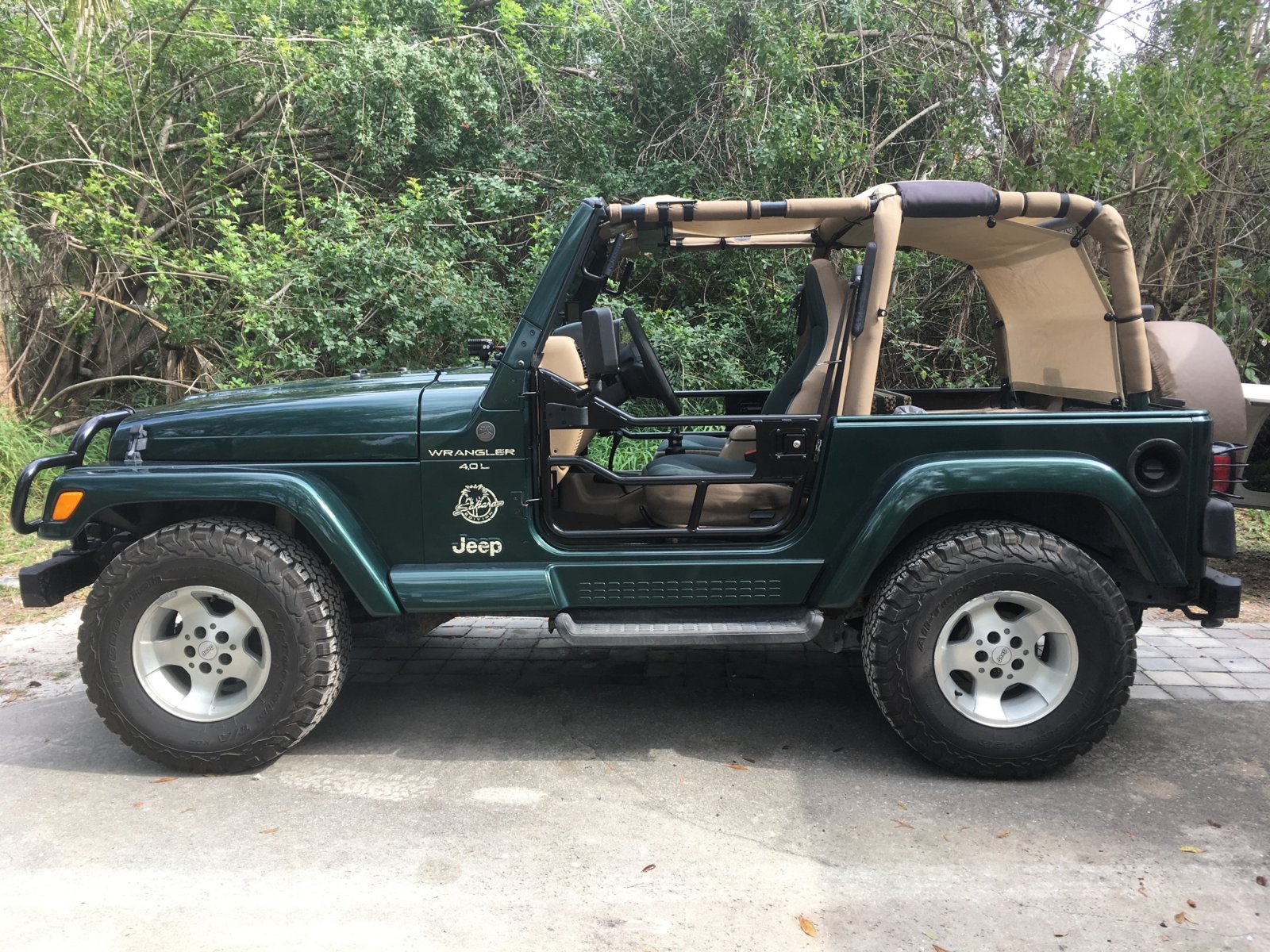

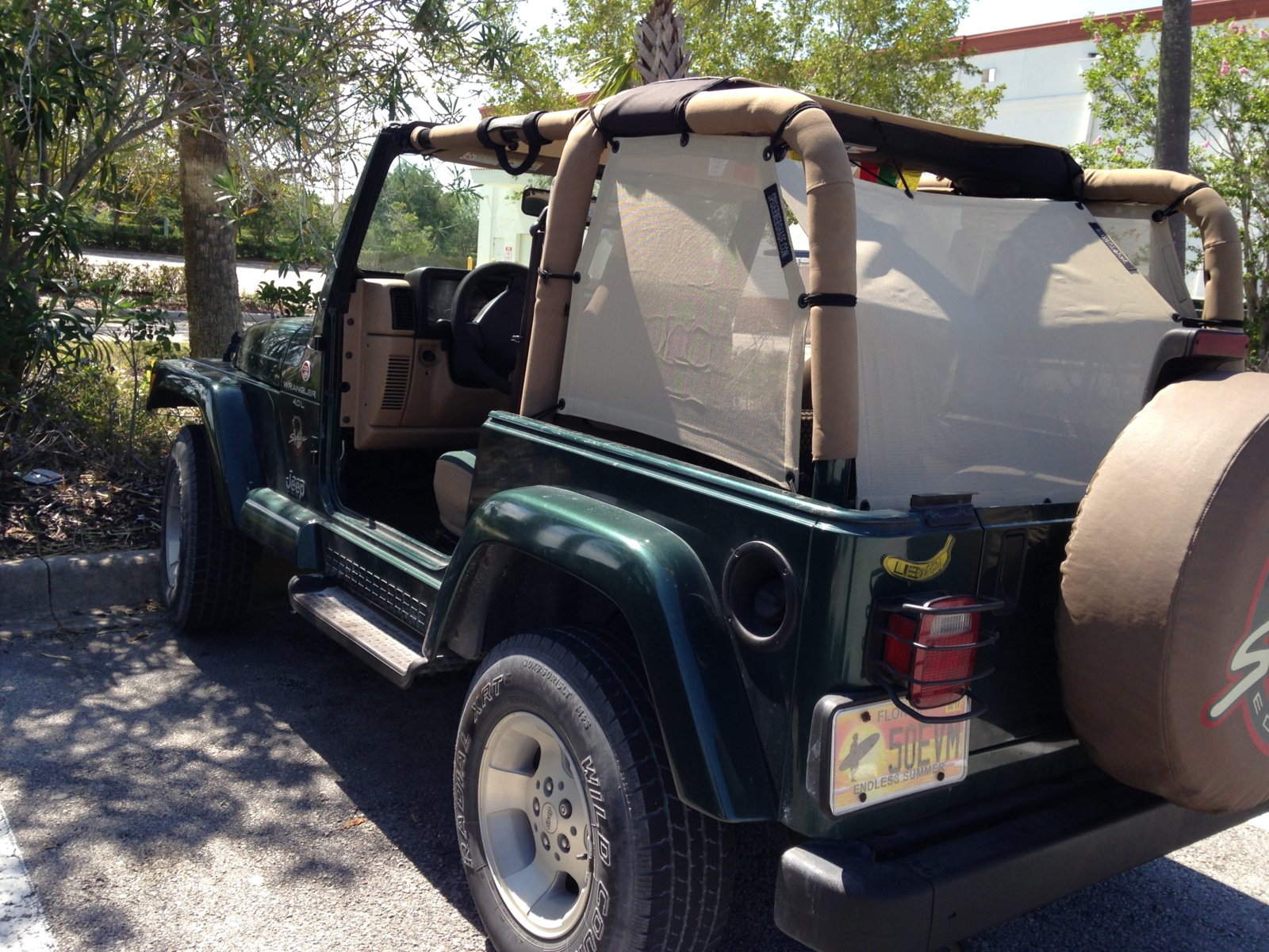

This was the day I got my first Jeep, a Forest Green 2000 Jeep Wrangler TJ Sahara.
https://wranglertjforum.com/threads/new-member-first-jeep.1950/
View attachment 33383 Completely bone stock at this stage, and 148k on the clock.
I got my Jeep as a result of a car accident and the totaling of my previous vehicle a month prior. The Jeep was an even buy from what my insurance check was for my totaled vehicle. I didn't know anything about TJ's at all except that its what I wanted...and what people in my family have been telling me to get for years.
Anyway it was a road trip to get it and get it back home (which was coastal FL at the time), I could not wait to rip the doors and top off when I got home! From this day on, I knew...this was it for me.

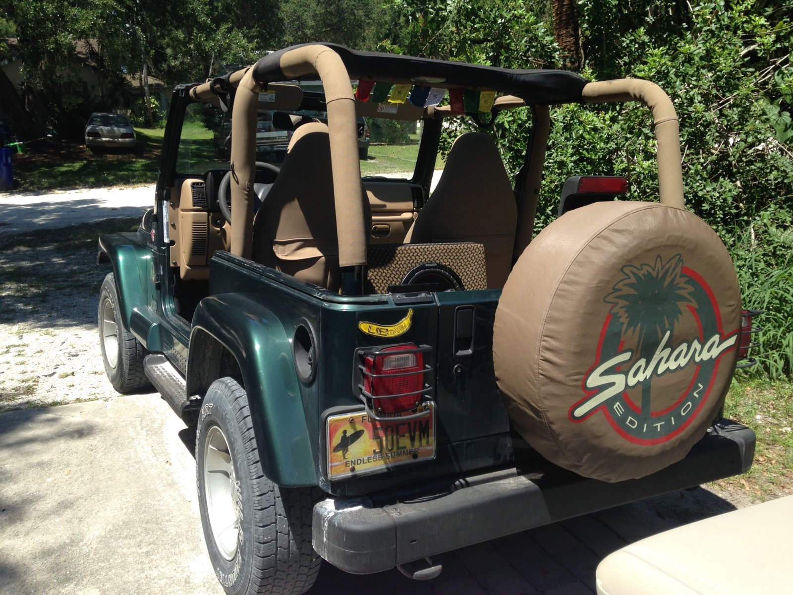

I quickly realized that I needed something to help with all the sun. I stumbled upon SPIDERWEBSHADE!

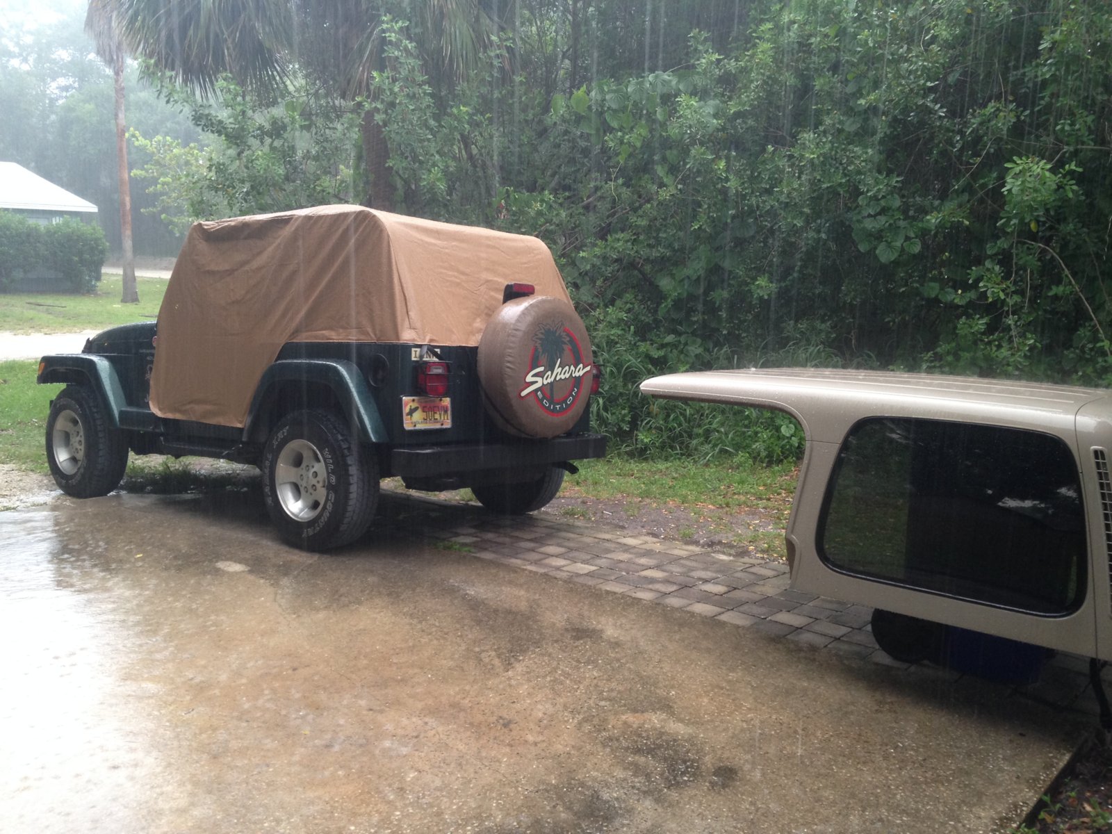

I then quickly realized that I needed something to help with all the rain. I went with the Bestop Trail Cover!
View attachment 33390 View attachment 33389

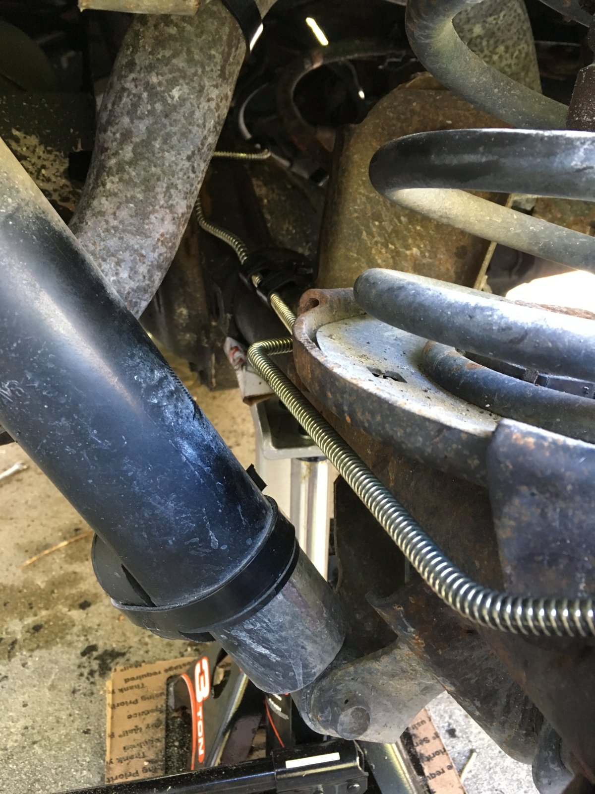

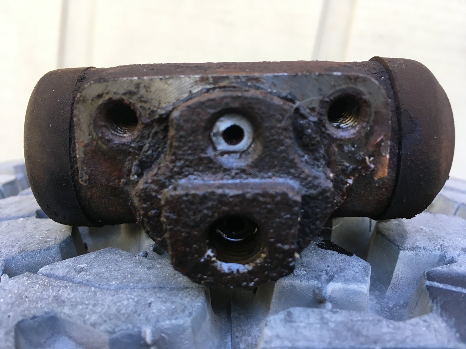

The first thing that actually failed on me was my brake line burst leaving my driveway one day. Luckily it was not in a much worse scenario. I would recommend people do visual inspections of them up front especially. This was a front passenger side brake line and it was my first task on my new Jeep. I went with the Rugged Ridge full brake line set and had it installed in a day. Also broke a bleeding valve and replaced both of my rear drum cylinders while I was in there.
https://wranglertjforum.com/threads/lost-my-brakes.2630/
View attachment 33414 View attachment 33415 View attachment 33416

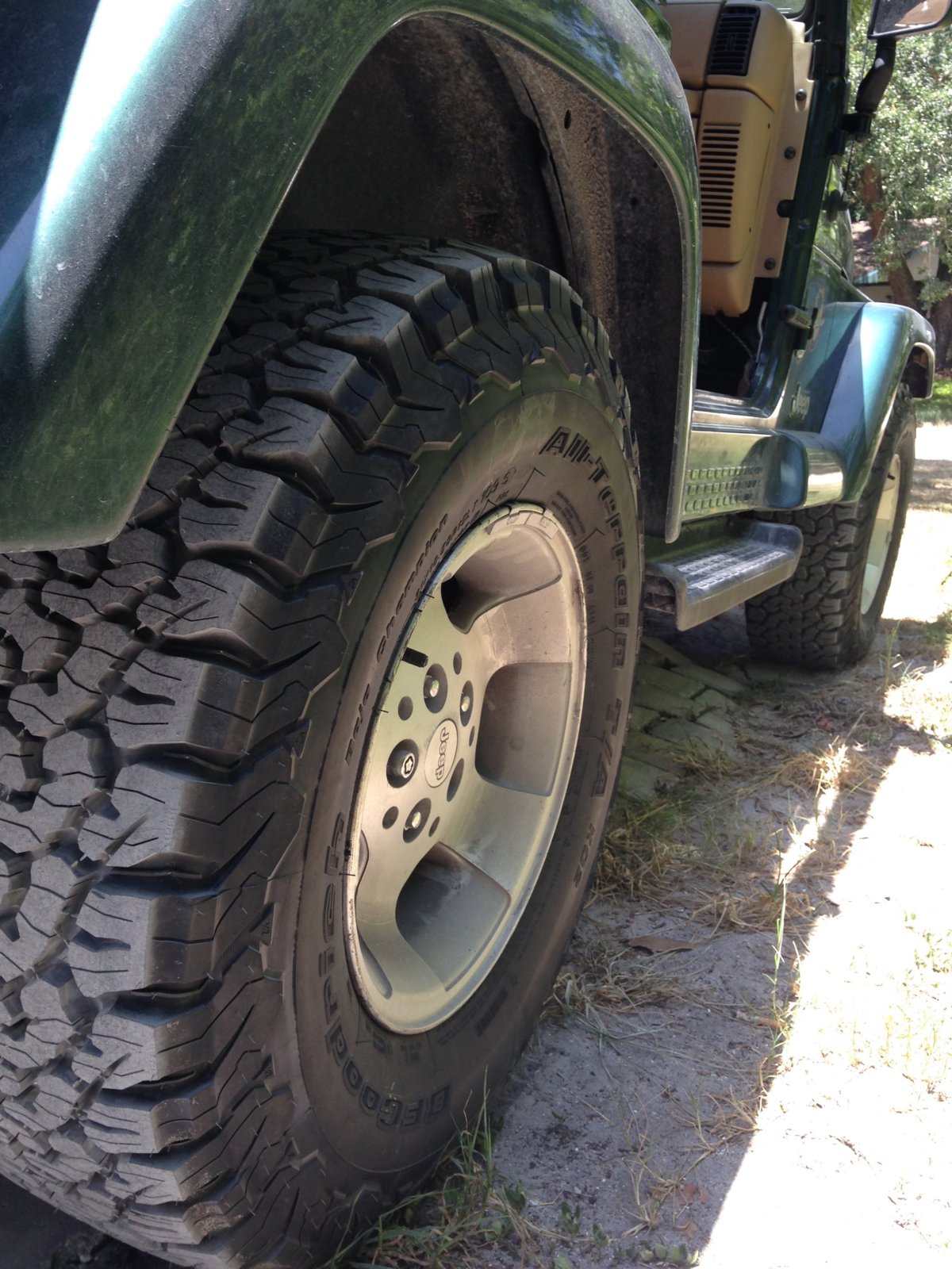

Next...tires! I had to save up a bit for a 5-pack of 31" BFG KO2's but it was so worth it.
I then had to take them for a test run. Wet sandy trails to palmetto forest...I had a riot.

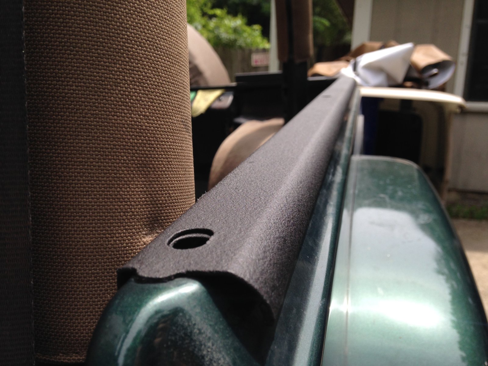

I performed a "Tub Rail Armor" mod with a bedliner.
https://wranglertjforum.com/threads/tub-rail-armor.2051/

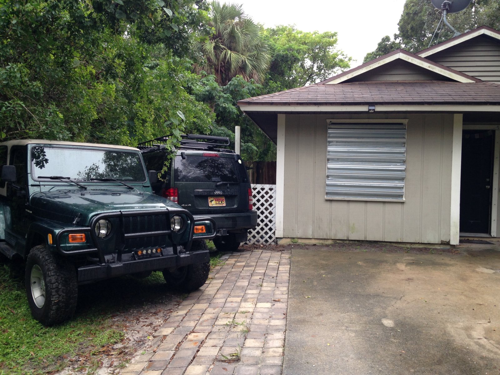

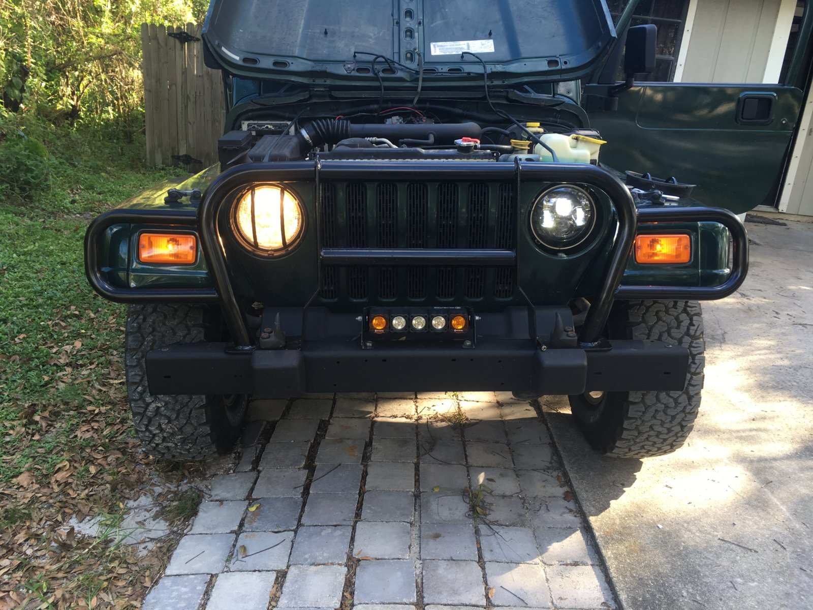

Prepping for our 1st hurricane to hit, I bought a Rampage Brush Guard thinking it may help with potential debris...and on the overgrown FL trails.
https://wranglertjforum.com/threads/hurricane-approaching.2329/
Upgraded to Sunpie LED head lights, and picked up a set of KC LED tail lights.

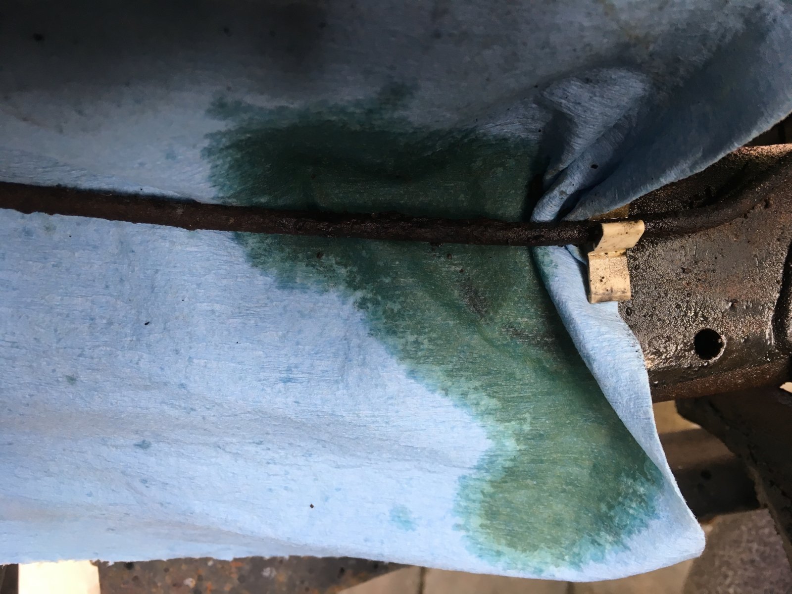

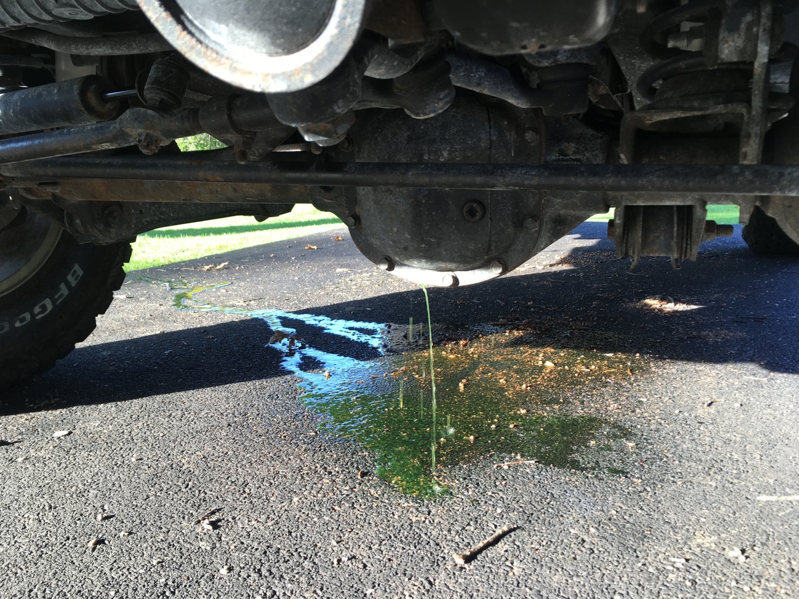

While troubleshooting this little leak, I replaced the upper and lower radiator hoses, installed a fresh water pump, thermostat, new belt and did a reverse back flush of the heater core.

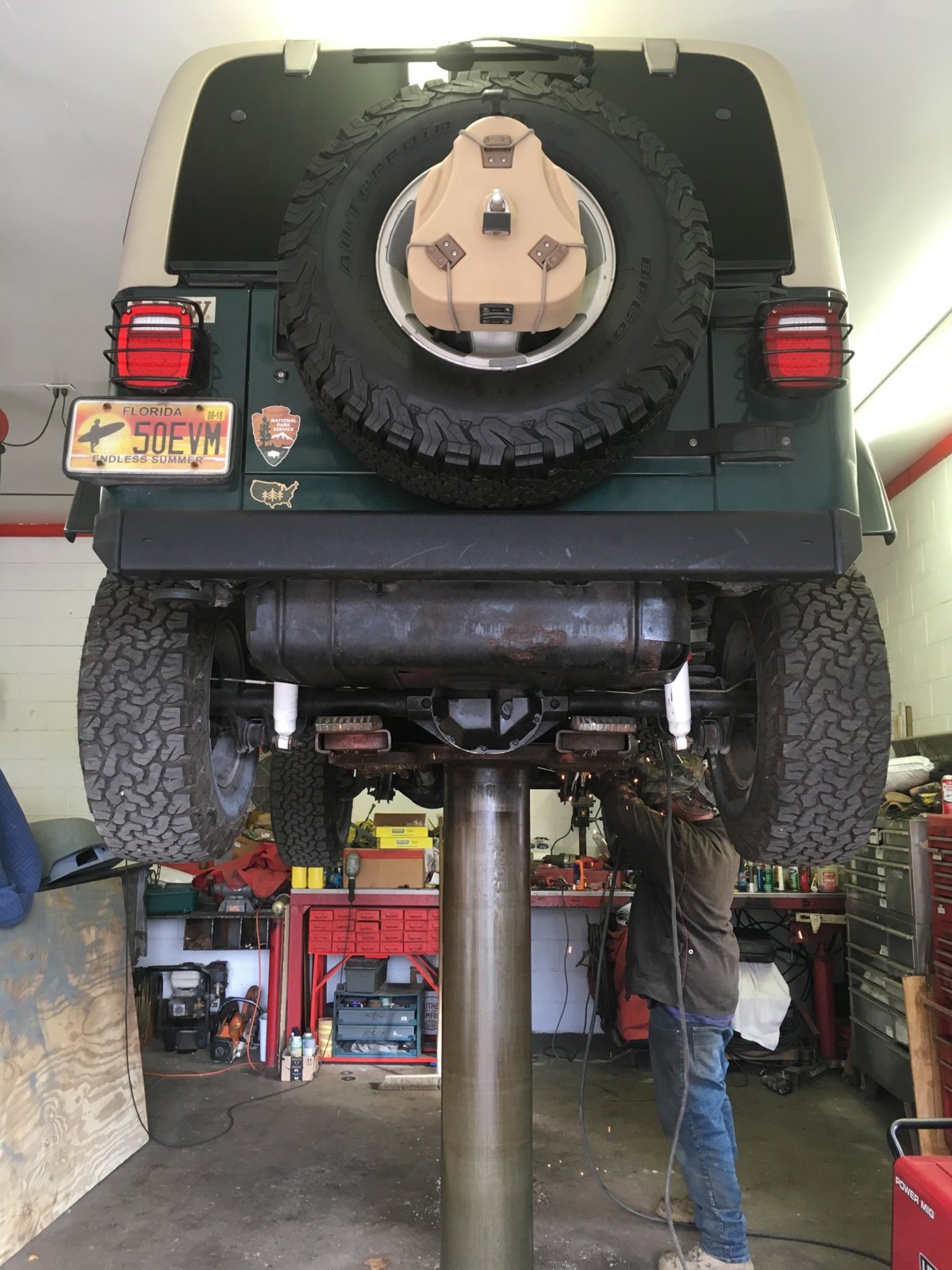

There are just too many pictures for tho but I underwent a major frame repair. Replaced frame sections with Safe-T-Caps including the rear trail arm all the way up to the front. Both sides. Huge job, but its all good now...
https://wranglertjforum.com/threads/going-in-for-frame-repair-surgery-today.7373/

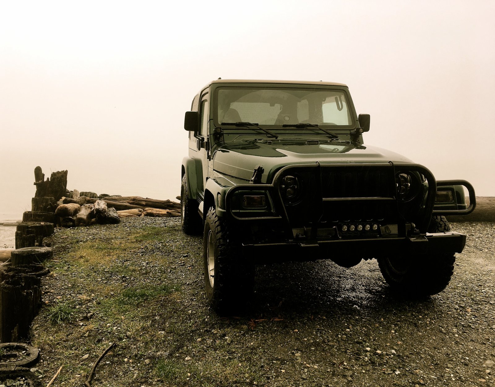

And that brings me to leaving the east coast and arriving in the wet and foggy pacific northwest.
My TJ now has 161k on the clock. So 12k miles in 2 years on a DD with a complete cross-country journey isn't too bad! I did not run into any issues on any of my road trips or outings thankfully, I think its due to preventative maintenance and the help of THIS forum and its members of course. So @Chris thanks again man for starting forum and making/keeping it awesome, it has helped me tremendously and taught me so many things. Obviously many people contributed to helping me and there are just so many of you to thank, that I will just say Thank You! and hope that you know who you are!
I look forward to learning a lot more here, building up my TJ a bit more, and being a Jeeper for life.
