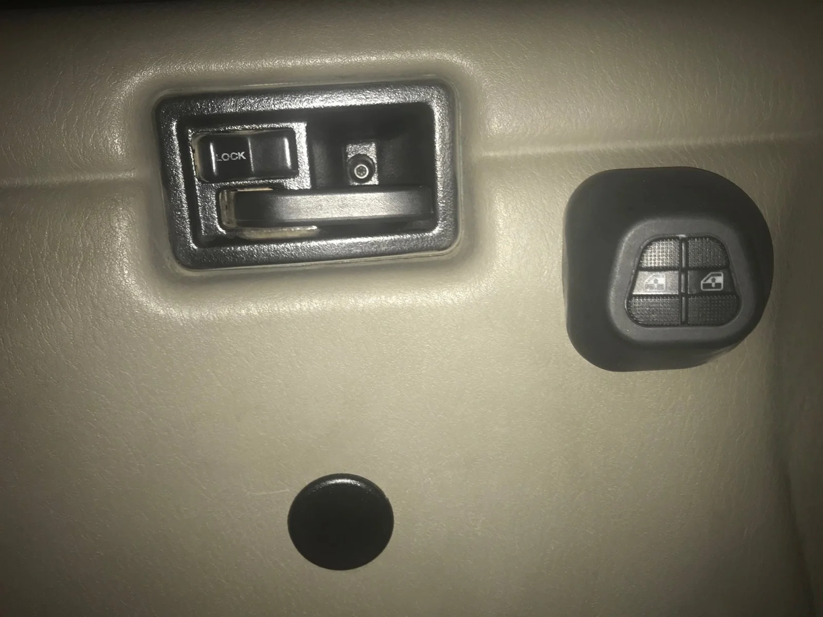

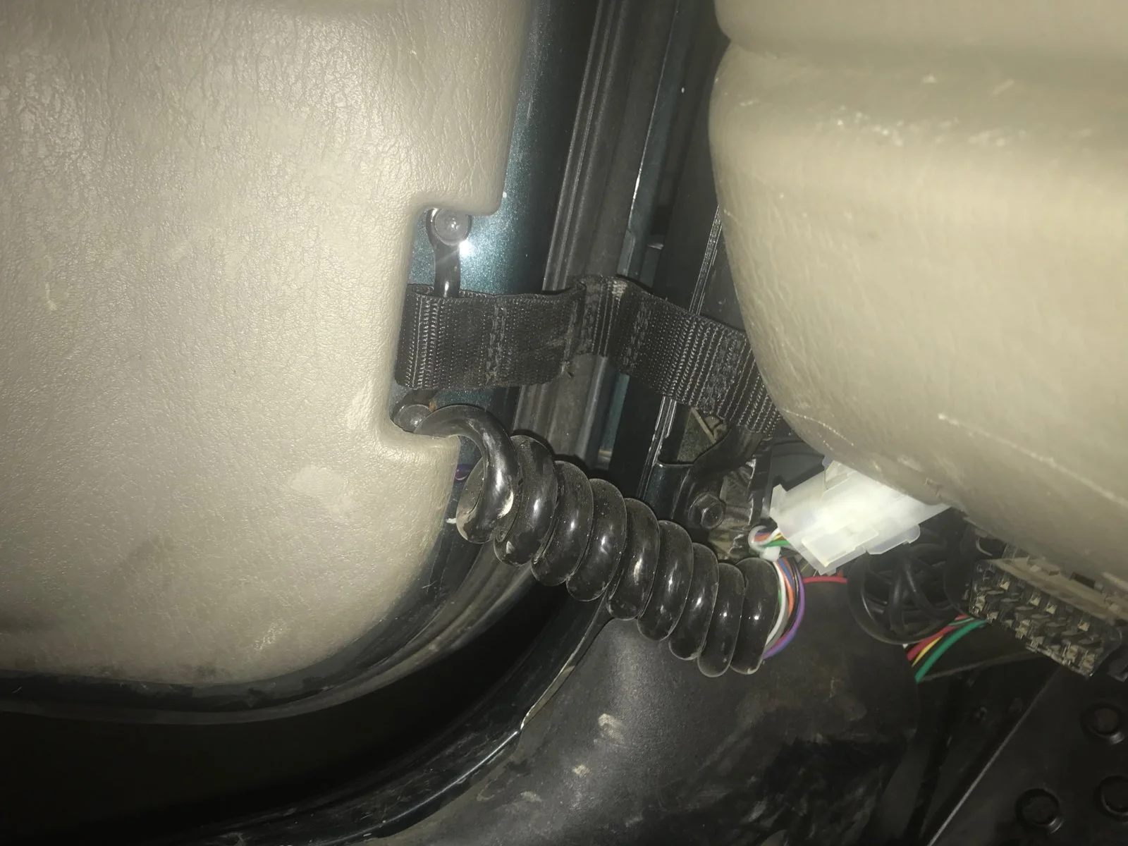

I should be able to tell you how many wires it is because I did it, but I can't remember. I have both locks and windows installed so the total is substantial, something like 8 wires. Windows alone are probably more like 4. I used fairly standard Molex connectors for disconnect and coiled cables. I mounted the window switches up high and forward so my knee wouldn't hit them in the standard location which is where the window crank used to be.

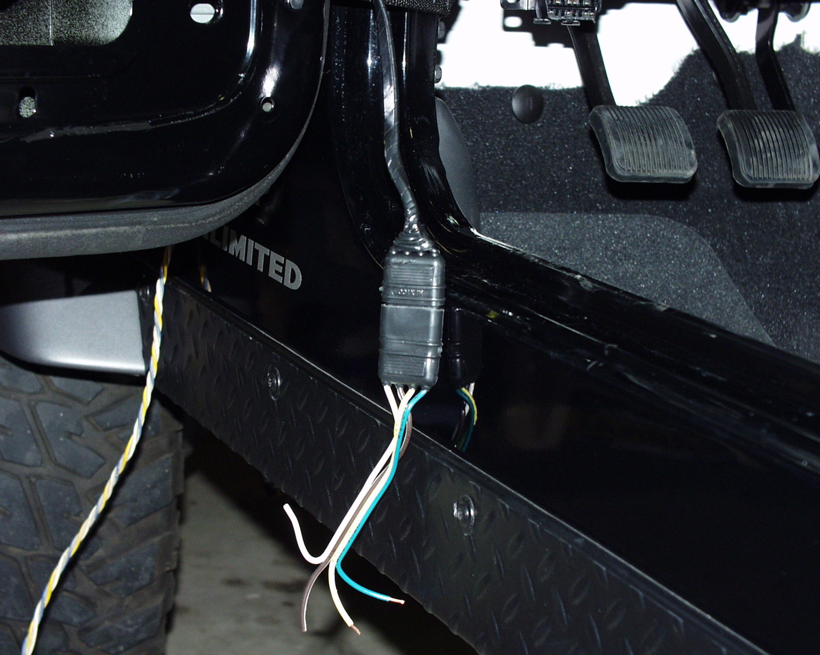

If you have dual switches in the drivers door (a switch for both the driver and passenger door) you will have 5 wires. If you have power door locks, you will have at least two (depending on where the switches and control unit are mounted. For a quick disconnect, I used a flat trailer wire connector, they are available in 5 wire versions. ($9 at Amazon).

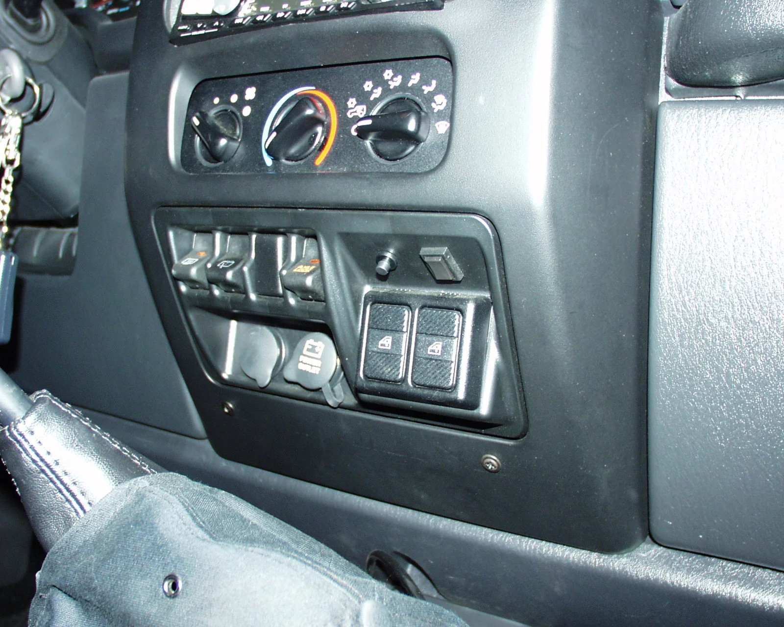

I had the same issue with where the switches are mounted in my '03, it stuck out right where my knee rested against the door. When I traded up to an '05 Unlimited, I used different switches and mounted them on the dash so both the driver and passenger can reach them. That meant I only needed two wires each for the power windows and door locks (positive and negative for each). So I could use a flat 4 pin connector as a quick release. I put power locks in my 1/2 doors with the same connectors so it's simple to swap doors. (I know, locking 1/2 doors sounds stupid, but hey, that's never stopped me before....)

One of the first mods I did was install power locks. No contacts, just wired but with quick disconnects so I cam remove the doors. I wanted them for use with my hard top so I don't have to check the passenger door or tailgate when I get out. I intentionally don't have any internal switch, so I can remotely lock it with the fob and the tailgate cannot be unlocked from inside when the top is off. I have a tuffy tailgate security enclosure for gear storage in the summmer and I didn't want to have to unlock and lock it with the key every time I get in or out.

On my '05 the place where I mounted the switches was a blank plate. On earlier models there used to be a switch to shut off the passenger side airbag (I think that's what it was for). The kit I bought came with switches to mount on the doors over the hole left from the original window crank. Unfortunately, the stuck out about 1 1/2 inches just where my knee rested against the door. I bought the flat switches you can see in my post above from the same company (https://www.electric-life.com/) they were the perfect size to fit the blank plate. To mount it, I just had to cut the holes in the plate to match what the switchers needed. As a bonus, both the driver and passenger have easy access to both window switches. Same for the rocker switch above the window switches which is for the power door locks.

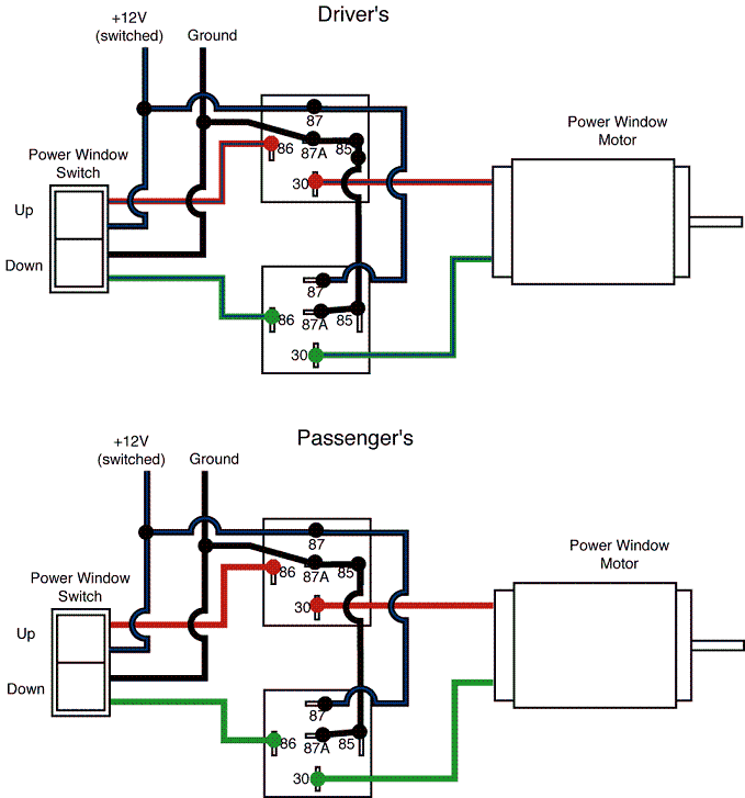

As another bonus, I only had to run two wires to the driver's door instead of the five needed when you have both switches there. I don't remember if I used the control module included with the kit (I did the install 15 years ago), I think I made my own using two relays for each window. It's actually pretty easy, each of the two wires from the motor goes to the common (#30) lug on the relay which connect to the ground from the #87a lug. When you trigger one relay, it feed 12v from the #87 lug, causing the motor to spin one way or another. You can only trigger one relay at a time, and since the other one is already at ground, bingo! You have +12v and ground going to the motor. Elegant in it's simplicity. The same idea works for door lock motors. I'm attaching wiring diagrams for anyone interested. I ran custom auto install shops for over 10 years and would be happy to answer any general electrical questions about that stuff.
