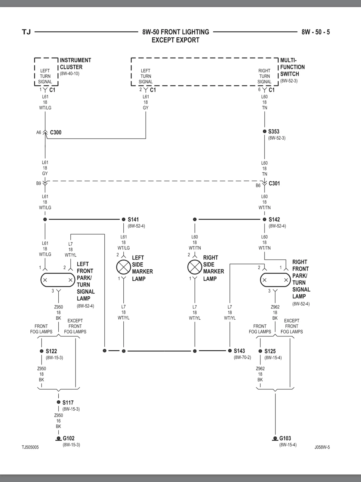

I have a 2001 TJ I have been rebuilding and have an issue that has me stumped! I changed the front signals and rear tail lights and brake lights to LED’s. I have replaced the flasher unit with one for LED’s which solved the hyper flashing but the emergency flashers just buzz? Have tried 2 different flasher units rated for LED’s to no avail. Any help would be greatly appreciated.

Yes, the stock bulbs (not LED's) get grounded one way for the marker light and then the electrical flow and ground goes the other way for the turn signal. It's kind of a wonky setup but actually pretty simple. The shortcut around this is:
A) add a second LED- wire one from one wire to ground, wire the second to the other wire and ground (if one or the other doesn't work, just reverse your ground and supply wires- LED's are polarity specific)
B) pick a wire- tape the second off- one wire will feed a turn signal LED, the other will feed a marker light. Just pick which one you want.

If you look at the pic I posted, you'll see how the stock bulb is actually across the marker and the turn filaments. It is not directly grounded. Just FYI.

I have had the problem before i changed the markers or the front signal bulbs. With only the rear changed the problem reared its head. Ultimately i think i will have to do the wiring modification that dbb1 was so kind to post the diagram for. I do want to try the flasher replacement first as I should have it in my hands by the weekend.
