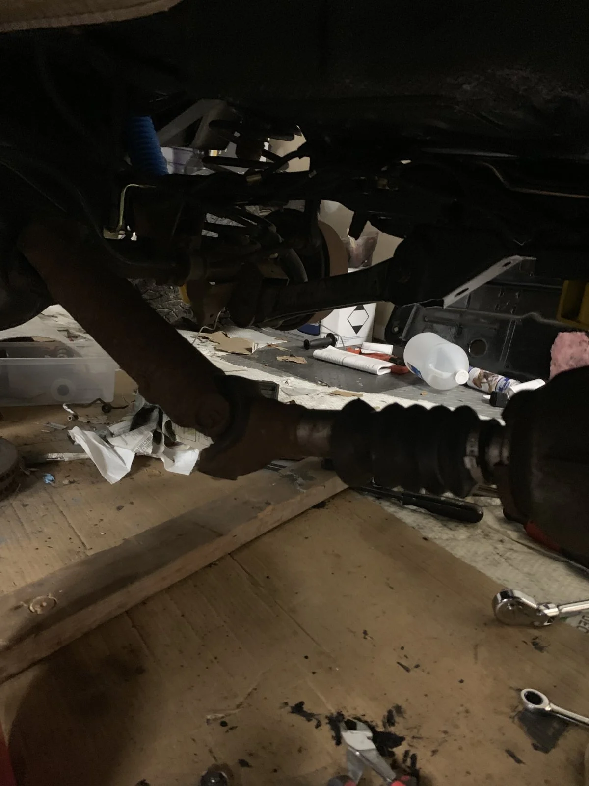

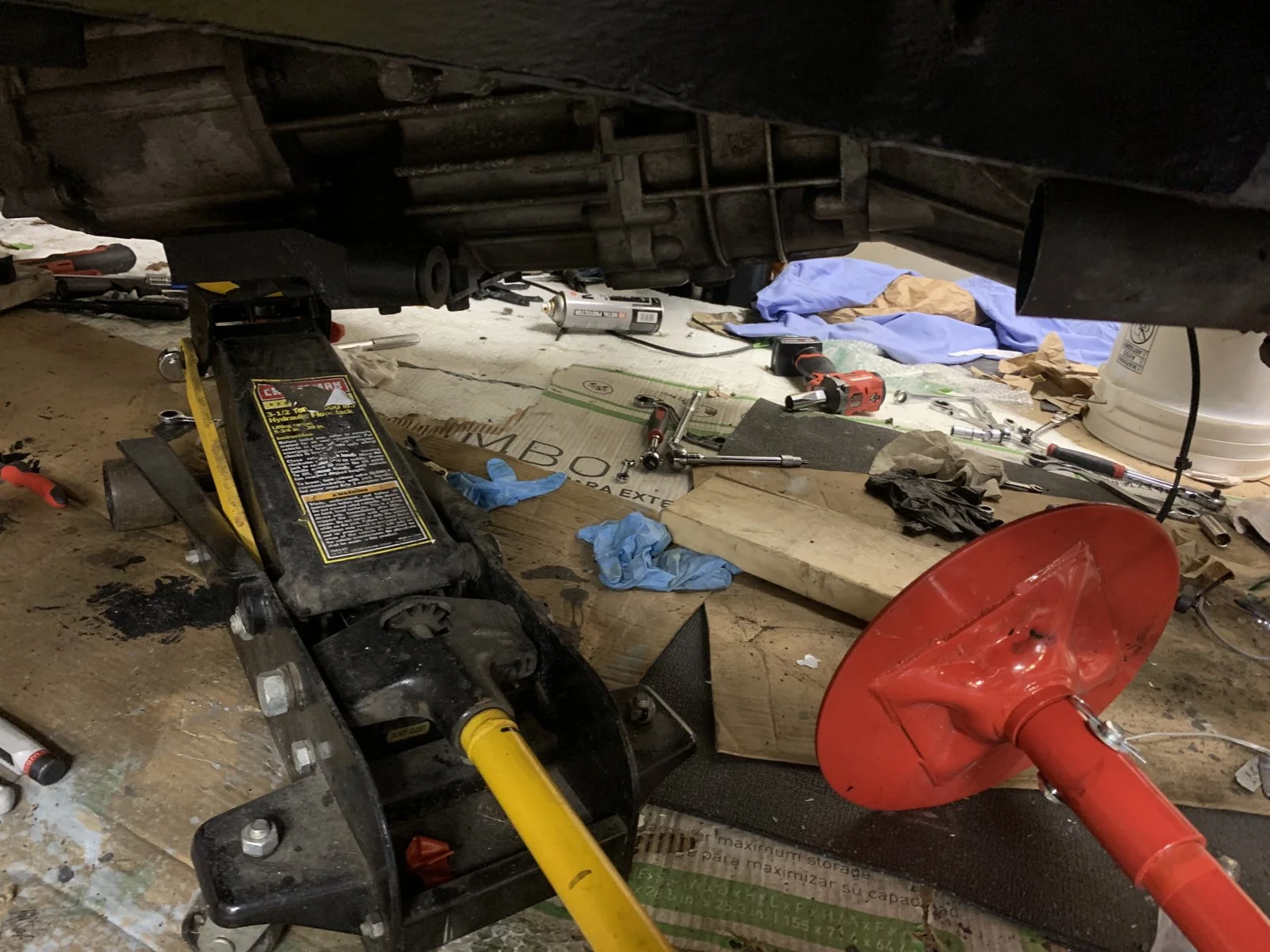

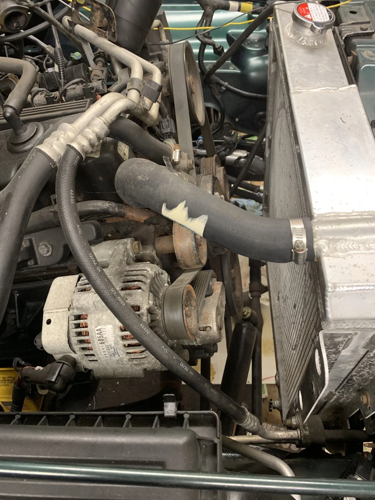

Here are some pics of my engine and the drop back. Any help appreciated
Not to derail this thread but you do know that you don't have a radiator fan, right?
I'd look front to back and find what's pushing up. It could be a bent exhaust too.
Problem fixed!!
Rear shaft bound up when the engine/trans dropped preventing the unit from being lifted back in place. Had to remove the rear shaft to move it. Lesson learned on supporting the engine with skid off....
