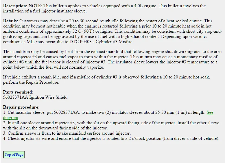

It sounds a lot like Heat Soak. The fuel in the fuel rail near the #3 injector vaporizes, so when you restart, there is vapor not liquid fuel in the rail. It starts, but runs rough, after a few seconds, liquid fuel gets in and it runs right again. You only get a CEL if you do this several times in a row.
The factory solution is to cover the #3 injector with sparkplug wire insulation. Below is a copy of it.

Tons of us have -Common issue. Mine does it all the time in warm weather- simply idle up a sec til the fuel is flowing and you are fine. Wrapping number 3 may help, but it is like using a sleeping bag in an oven. The intake and exhaust are on the same side of the engine- it is a furnace.

That d/e kit will fix it,fixed mine ,u tube vids on it too!
I did the insulate #3 trick. It may have helped, but I've had the heat soak symptom a time or two even afterwards. I just rev it up for a moment to clear it. I'm wanting to install hood vents which reputedly solves the problem.
X2 on the DE kit. Took about an hour to install, my heatsoak issue went away almost entirely. On the hottest of hot days I still get a little rough idle for a minute or two but not nearly enough to be a problem.
