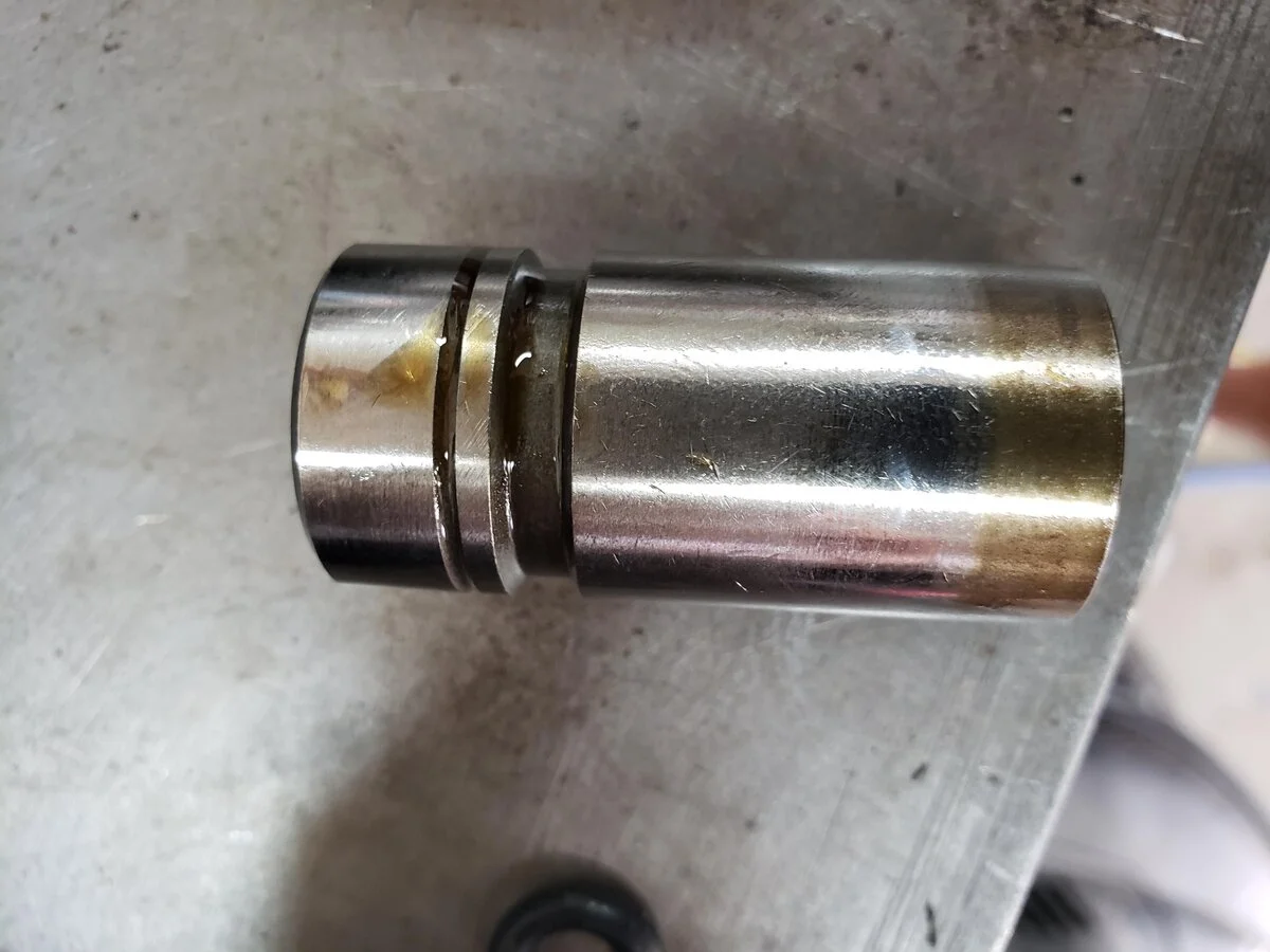

Well, i can spin all the push rods with the exception of the cylinders with visually open/actuated valves......So I cant get a good measurement. Also think the valves are actuating about .370. I put the gauge on the rocker/valve end and rotated the engine. Its difficult at best as I couldn't find a solid piece of steel for the magnetic base, but am close. I am 1 inch away from re-installing the old lifters. Problem is Since I replaced them, I just threw them in a box and didn't mark them... I know the "rule", but at driving 3k a year, it should get me by until I rebuild it. The foot of the lifters are perfect looking.....

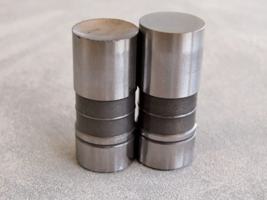

If you changed lifters, but not the cam, I’d be worried about wiping a cam lobe. I just rebuilt my 4.0 and the new camshaft came with a piece of paper that recommended break in with delvac, rotella t, or delo 400 due to their higher zinc and phosphorus concentration.
This article explains a bit more: http://www.superchevy.com/how-to/corp-0808-worn-down-engines
Here’s what I think I’ve learned during my rebuild: flat tappet engines are high contact, high wear setups. The design of the 4.0 goes back to AMC, and is rather old. “Older” motor oil also had higher amounts of zinc and phosphorus as those elements are very effective additives in motor oil. However, Z and P will clog catalytic converters, so we moved away from them as emissions standards improved. Today’s motor oil has very little Z and P, which our 4.0 really need.
While you didn’t change the cam, the tappets ride it. I would pull my distributor and attempt to check the condition of the camshaft. If the cam is good, I would check the bottom of the lifters.
And I would use a zddp additive going forward!
