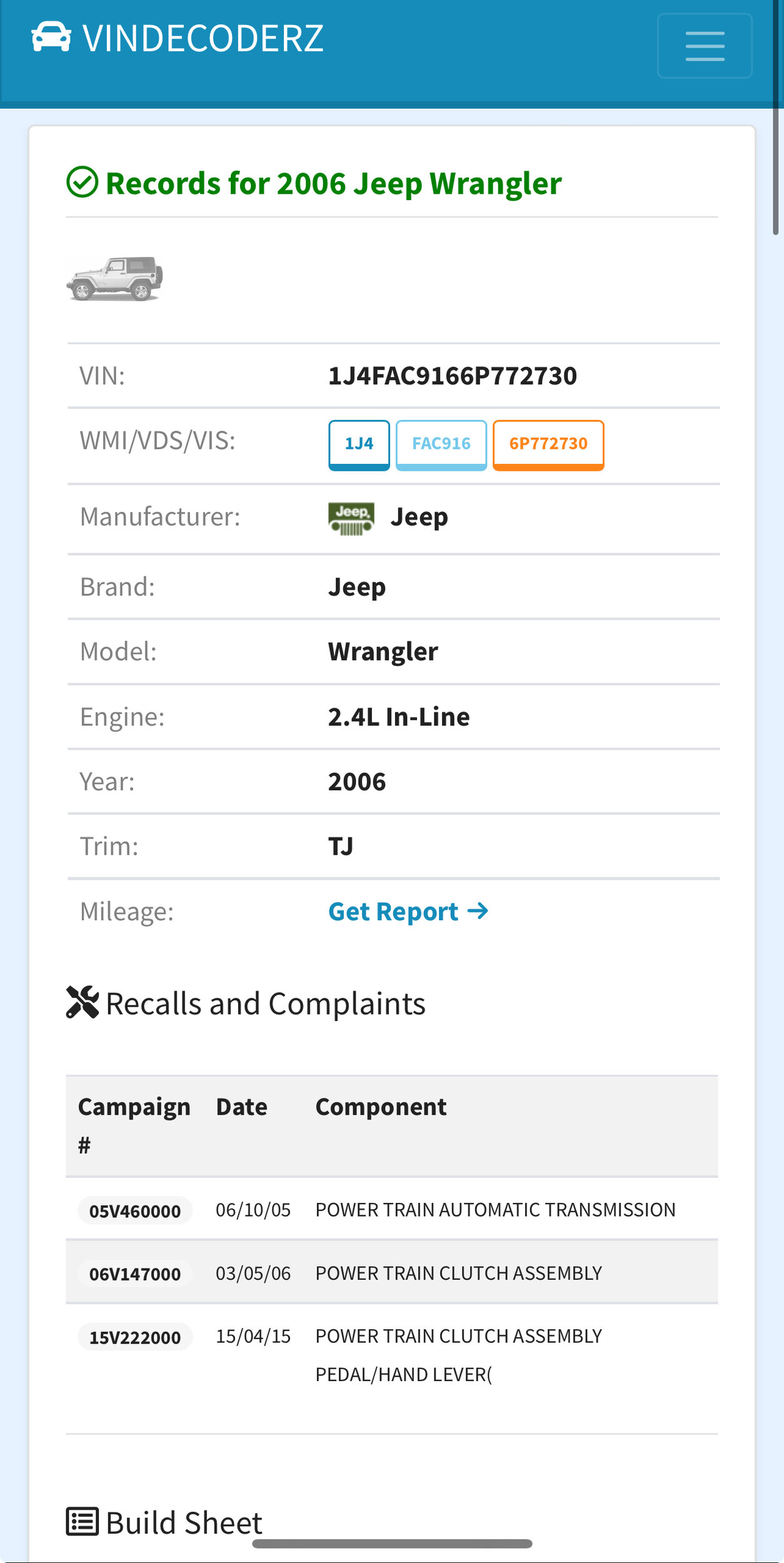

1J4FAC9166P772730
It’s country of origin is Germany. Berlin.
I think that build data number is the one I need. Does anyone have an example of that?

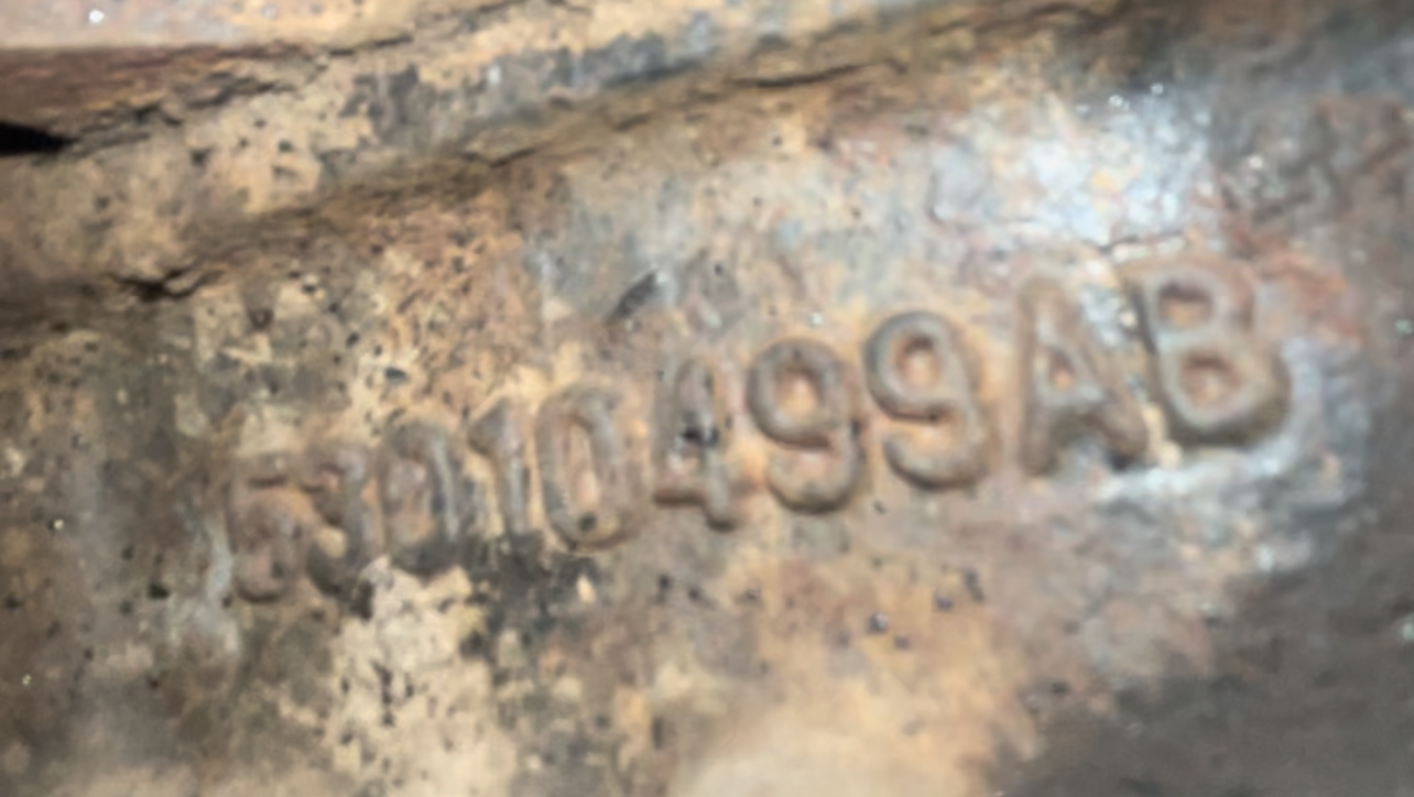

The casting number I found:

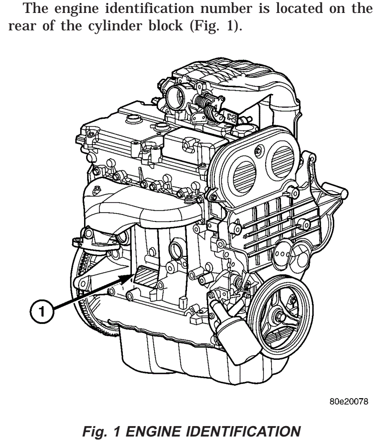

This is from the FSM. Showing where the engine identification number is located on the 2.4L engines.

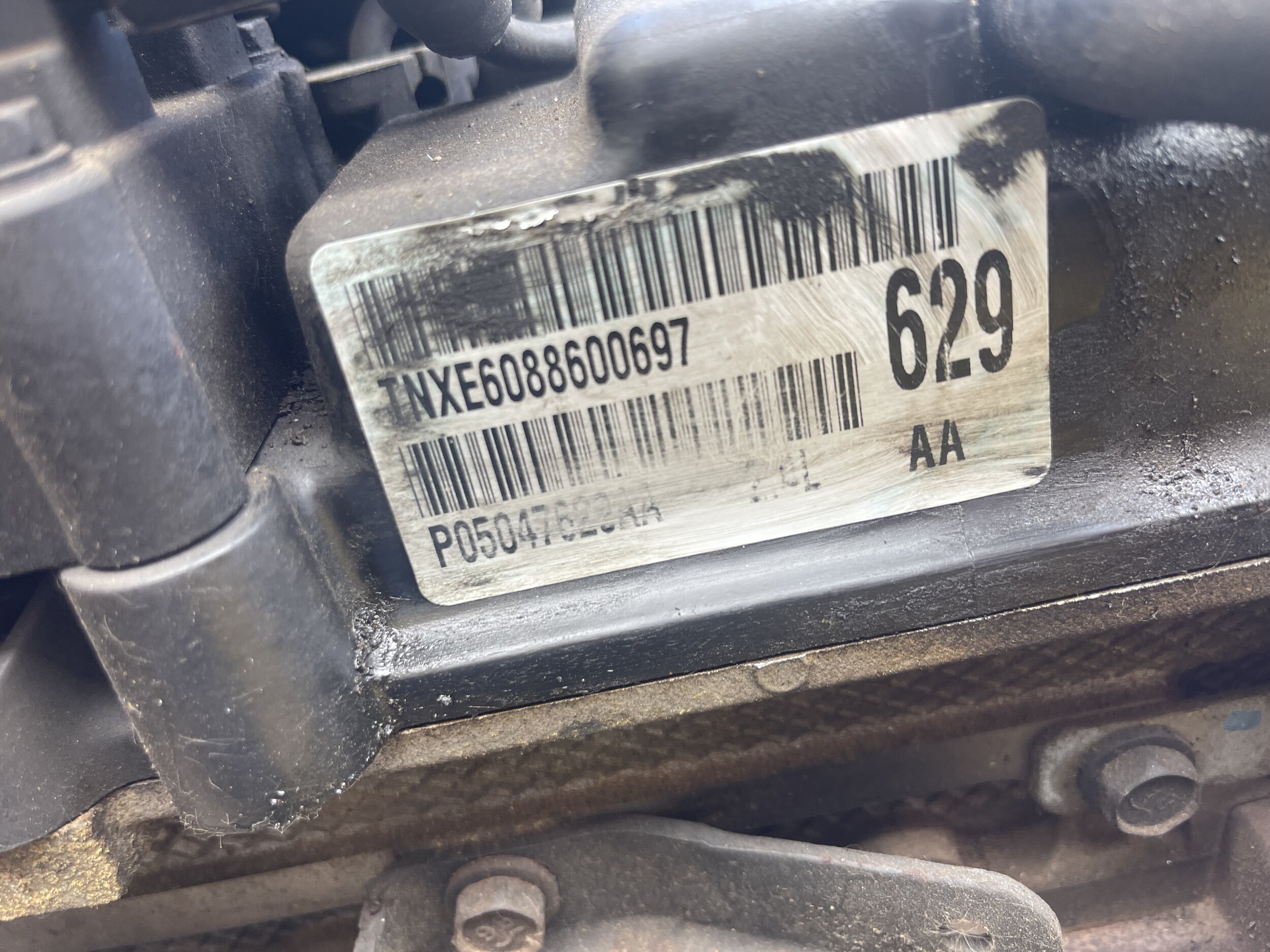

They quit doing the vin in 01. At least in the states
Yeah i also found somewhere that they stopped engraving in 2001. and the only thing they use is the sticker with the barcode that I allready found.
anyway, the inspection center says it needs to be on the block, the jeep dealer also.
the jeep dealer gave me a picture of what they found on the location but i just cant make anything out of it..
it looks like there was something, but maybe i just want to see it...
