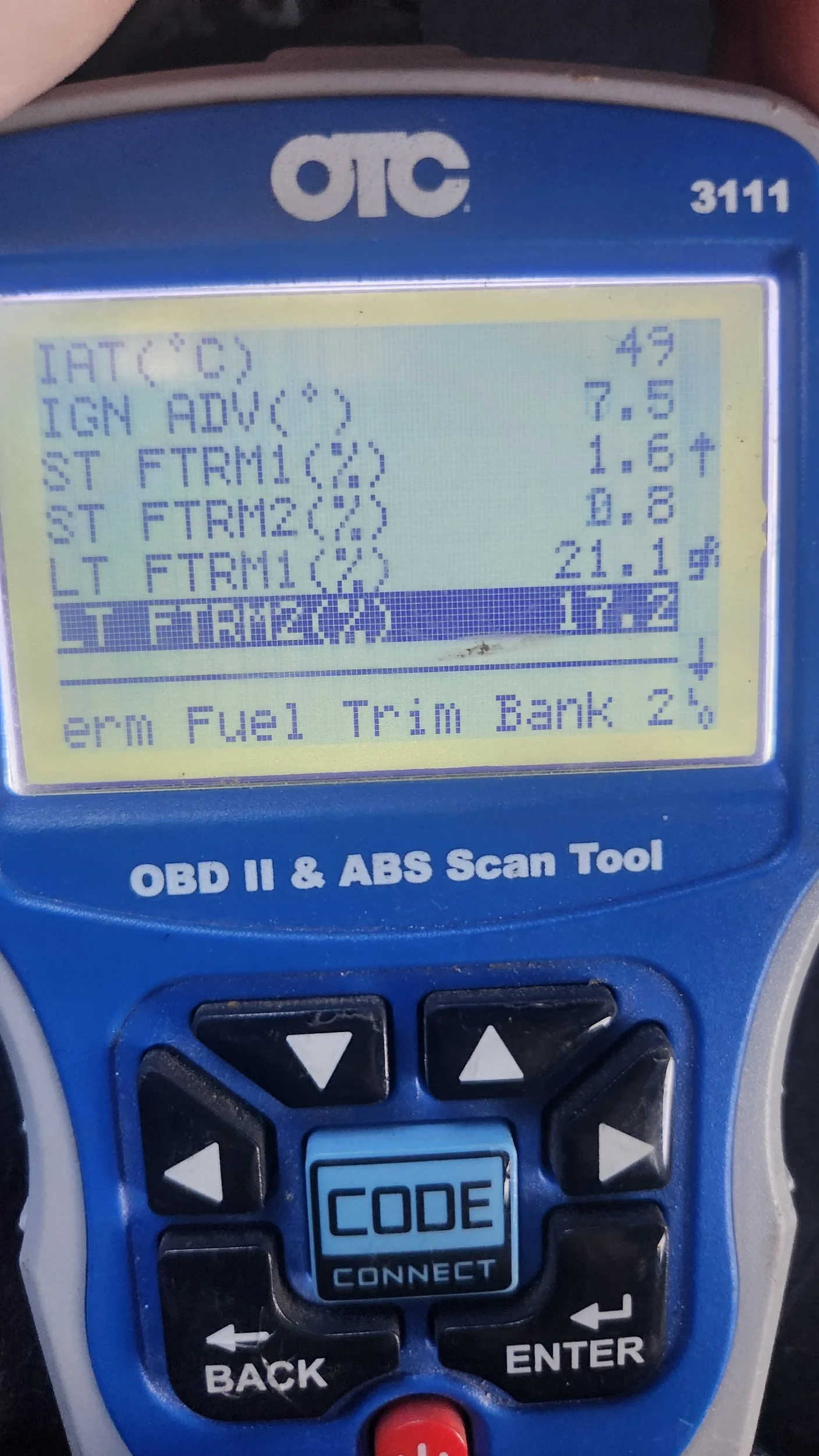

You can also see the fuel trim, not sure if that helps. This is at idle
