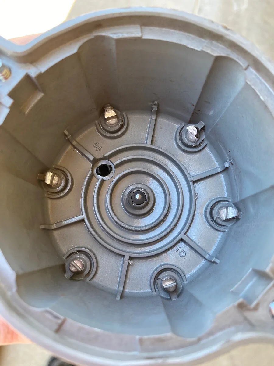

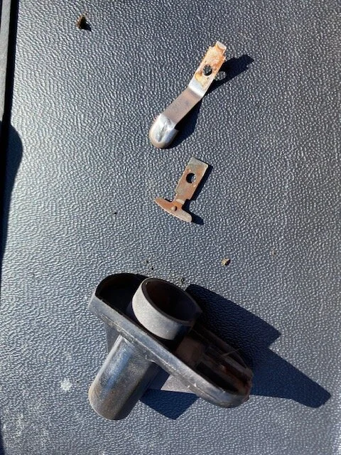

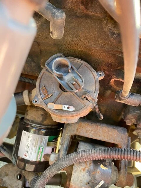

I was jamming to some music (Traffic) and removed the distributor cap and found two metal pieces (see photos) no longer attached to the rotor and i put my finger on the shaft and Holly Cow a 1/4 of play (see video). With that said I installed a New Distributor (rotor and cap were included) and bingo starts right up and its quieter. I was getting what I would call a loud noise and thought it was my injectors (read other feeds about the injectors ticking). So, i think this distributor has been slowly failing all along.

I don't know how you could have gotten spark out of the distributor,let alone to the right cylinder if those pieces were off the rotor. The longer one is what connects the center to the spark plug wire. They must have fallen off when you pulled the rotor.
Anyway, it's amazing that it would run at all! I am impressed with a straight 6 engine's ability to work when it shouldn't. No other engine design can compete with a straight 6.
Glad you found the problem. Even gladder the fix was so cheap. Cap and rotor should be on your maintenance program. They are made so cheaply now. See if you can find ones that use brass instead of aluminum in the cap. Those normally last at least twice as long. Get a new cap/rotor (aluminum) every 10,000 miles (max). I try to replace them every 5,000 on my machines.

Its amazes me the jeep continued to run (no misfires, no lag, no ques of any issues besides this metallic noise which i thought was the injectors) in the condition with 3-4 of the output contacts shaved off by the rotor for what I bet has been ongoing a few months. Info. This is not a daily driver vehicle so I only put couple hundred miles a month on her and noted on the maintenance and parts, thank you!
