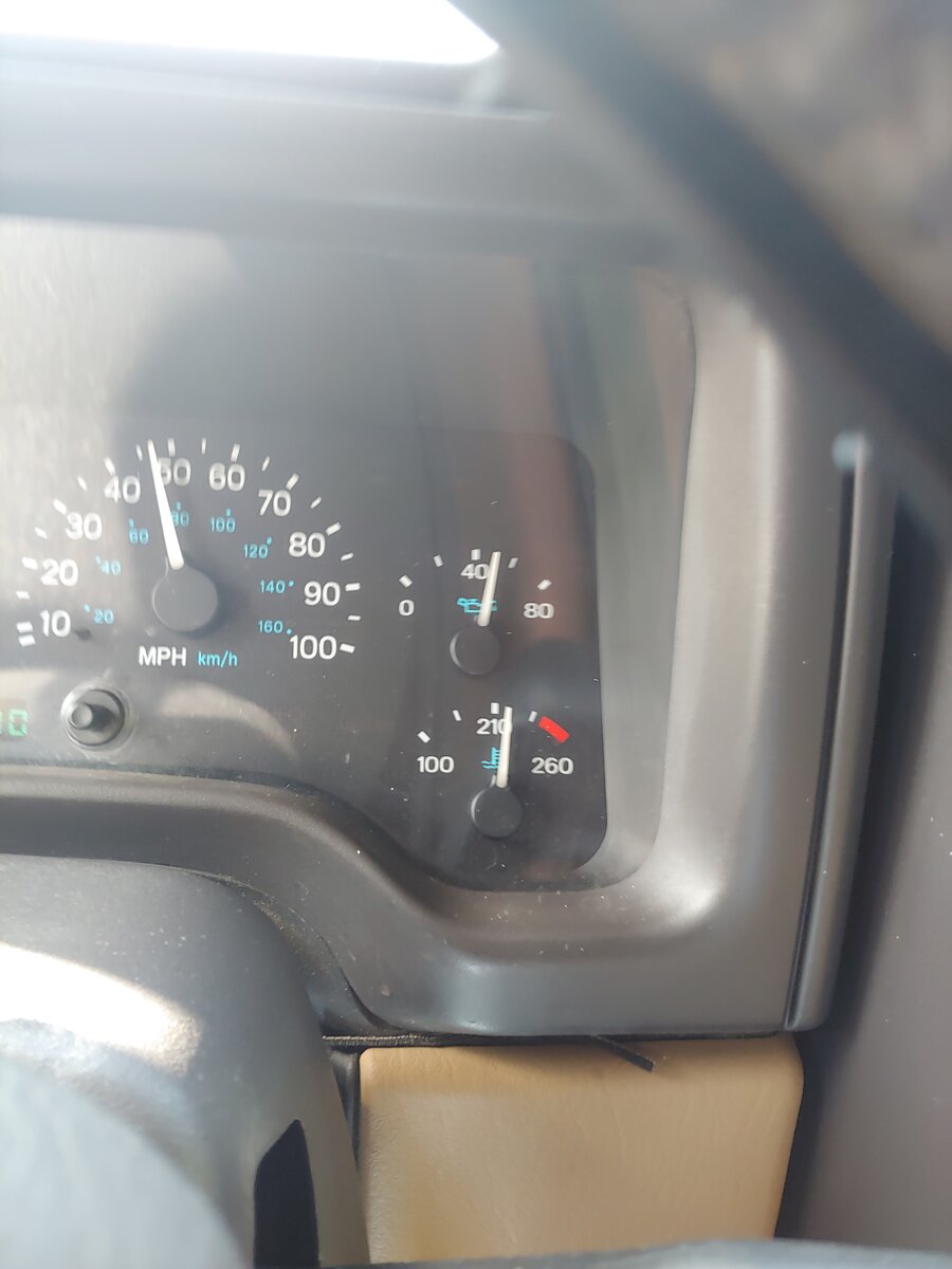

Well I did not intend to start an OEM vs. non- OEM feud. All I wanted was my engine to run cooler. I have some good tips to work with. 195 thermostat will be here tomorrow. At this point, I have replaced everything but the fan clutch and water pump. Fan clutch has good resistance when warm so we will see how the thermostat does. I might just get a water pump too. Not gonna tell you if OEM. 🤐 At 165k miles, this engine runs exceptionally well and I do not want to hurt it.

A cooler thermostat can actually make an engine run warmer in hot ambient conditions. The water actually needs time to cool in the radiator, if the thermostat stays open longer which is what a lower temp thermostat would do, it doesn't allow the water to stay in the radiator as long as a warmer thermostat and that can cause temps to creep up.
Installed a 195 thermostat and it has dropped the running temp by 10.
