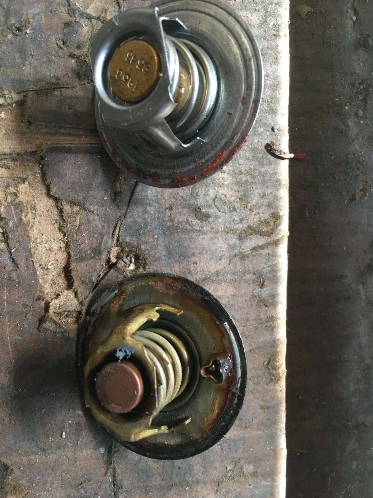

So, for all you Stant stray guys, ordered one online & put it in. OEM tstat had “top labeled on it & I put the new tstat in with same orientation.
BUT, the Stant dome was slightly thicker and presented a clearance issue which wasn’t apparent until a nice stream of antifreeze began dribbling from the cracked housing after install! Cheap oreily one would have worked fine. New housing on order & Jeep down for another week!
85539
Stant tstat must be oriented at ten & four to clear housing.
85540
85541
I seriously doubt the Stant thermostat you installed had anything to do with the leak. It's by far the most popular thermostat recommended here and I've installed 4-5 myself without ever having a leak. You just have to make sure it doesn't slip down out of place as you place the thermostat housing over it.
Too many of us use Stants on our TJs without problem or leaks.
I tend to agree with Jerry. Wonder if the housing was dropped in the past compromising the integrity. Hard to believe torquing that bolt could crack a perfectly good housing.
Jerry, i take issue in your doubting my mechanical ability. My post was to inform that there was a clearance problem with the thermostat & housing if installed at 12 o'clock position. It was evident when I pulled the housing off and rotated thermostat in housing on bench. No, it didn't slip down on installation and this ain't my first rodeo! New Leprechan housing, stant tstat & felpro gasket--Jeep rides again.
