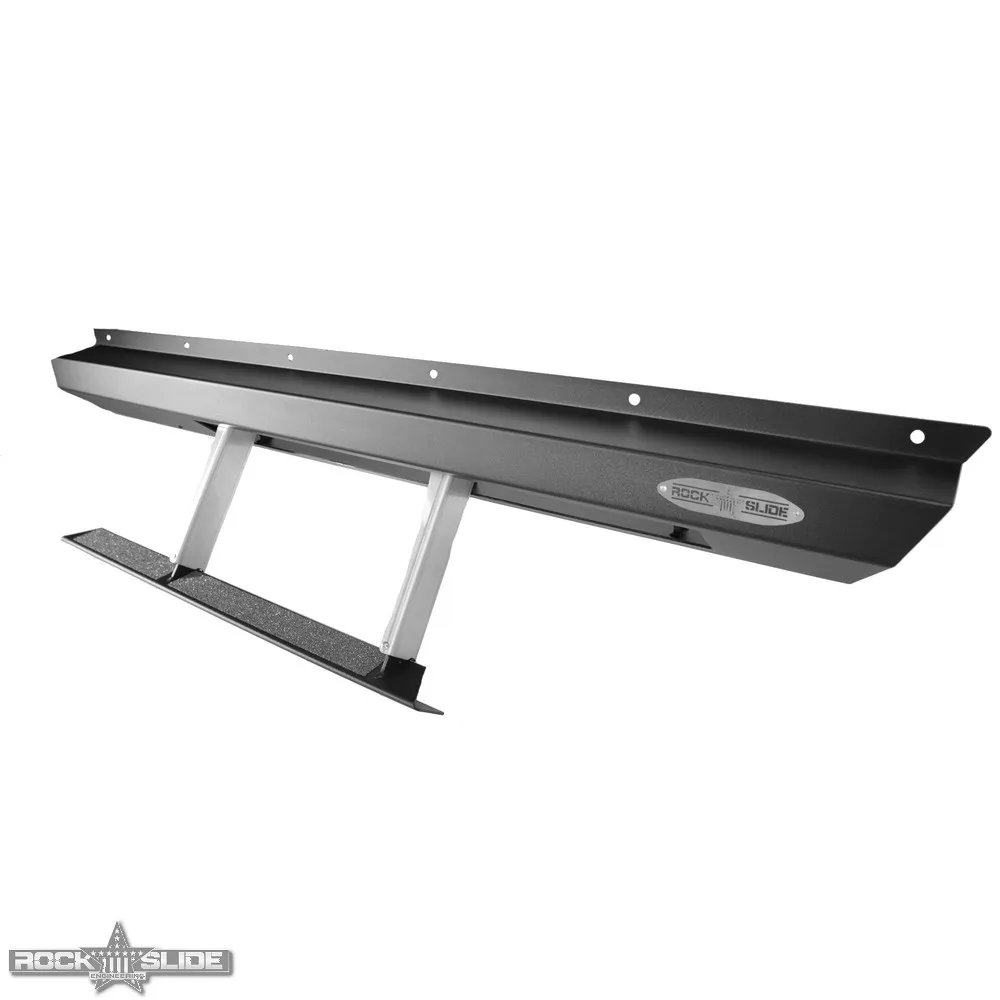

How about the $2000 powered drop rock sliders. Someone makes em.
Or MORE has a removable hitch pin step.
I could find ya a link but…

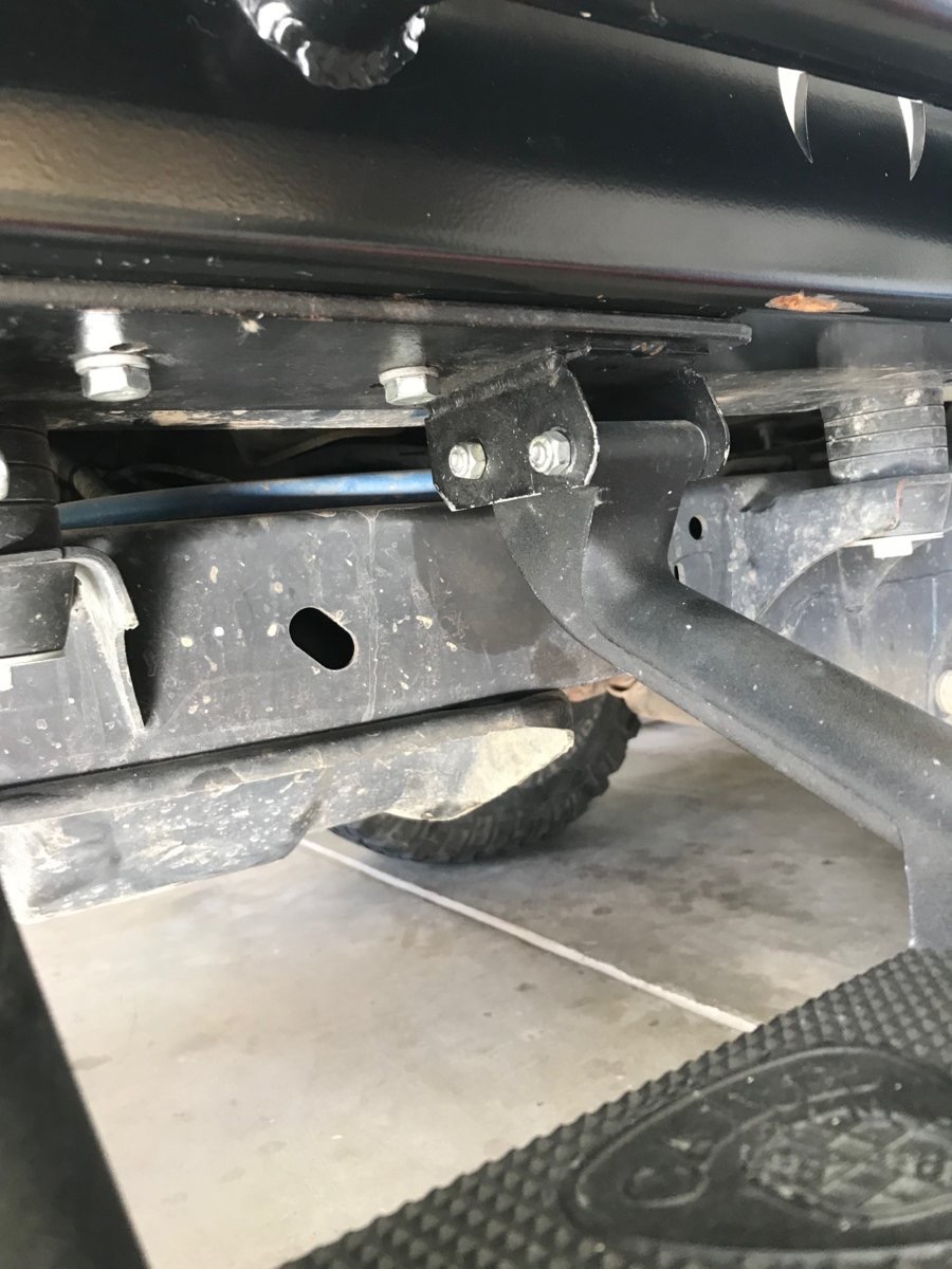

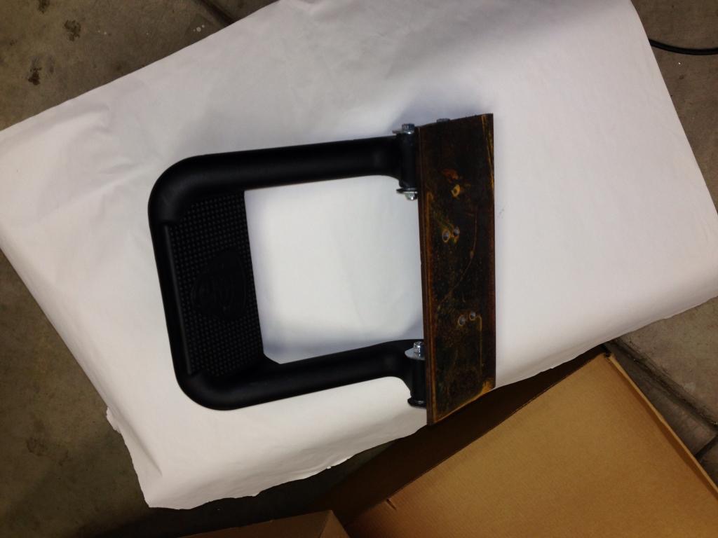

I stated out with some Carr steps and welded the brackets to some flat steel plate. Then drilled and tapped the underside of my sliders. Drilled some holes in the flat plate and use two 3/8" bolts to attach them. When off road just remove the bolts and the steps, and your ready to go in a couple of minutes
View attachment 562536View attachment 562537View attachment 562538View attachment 562539
Very nice. How sturdy does it feel?
I like the concept, it may need some reworking for my mini-boatsides, that move the flat bottom surface further inwards.
This is super nice setup. I have these Carr steps on my F-250 just for the wife. And they don’t looo horrible.
