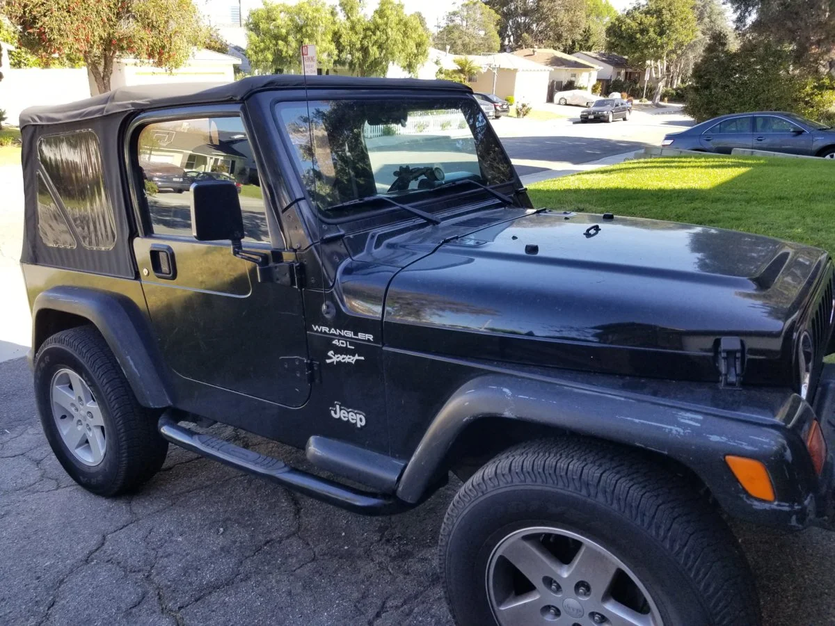

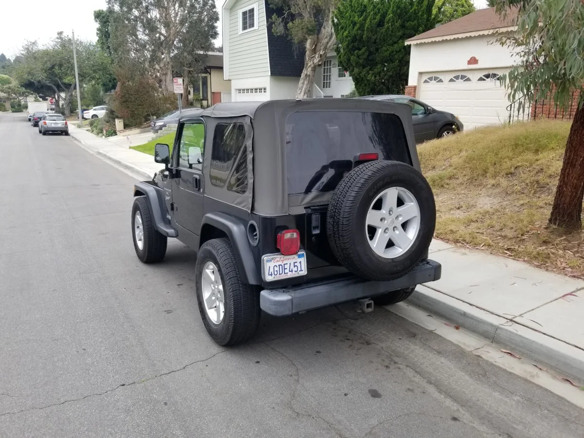

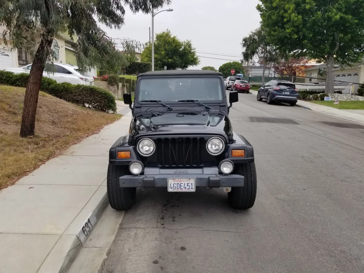

Started out as a 1999 Jeep Wrangler Sport, 4.0 6 cyl, 32rh auto trans, 140k, old Bestop soft top, half doors and sun baked fender flares. Old rims and tires. And lots of undercarriage parts needing to be replaced.
I dropped a grand on new undercarriage parts. I don't recall the entire list. But it included new control arms. And Rancho 5000x shocks. I also upgraded the tires and wheels to JK Moab take offs. JK Moab 5 spoke rims and new Goodyear Wrangler street tires.

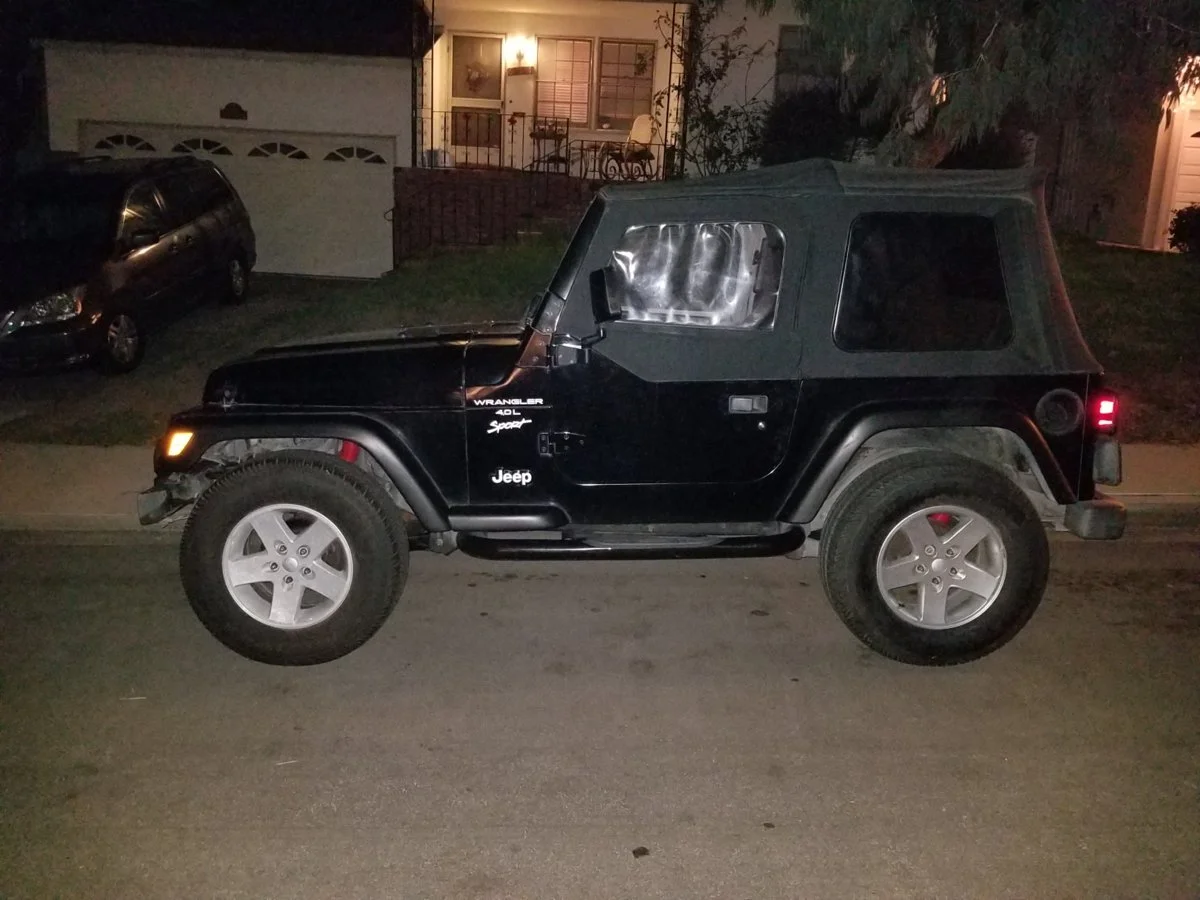

Then I upgraded to full doors and newer 03-06 seats. And Misch big boy seat brackets. For 4 more inches of space sliding the seats back. Got a Rampage Khaki soft top installed finally. Took a long time to realize I did not have the oem soft top frame for this soft top. But it's finally on. Also had to wait for a hot day. Doing it in the winter proved to be foolhardy.
I tried using Forever Black plastic dye on the flares. Didn't work. Just flaking off. Planning on removing the flares Monday. Stripping and painting them. And replacing them Tuesday. Using SEM plastic adhesion promoter. And SEM black trim paint. Also removing the old 80's side steps.
Have a Smittybilt rear bumper with tire carrier to go on. With a Smittybilt front tube frame bumper. And then hopefully some newer sidesteps. Then some Patagonia MT tires. Have sound deadener for entire tub and new ACC carpet. New LEDS for all the interior and exterior lights. Eventually would like to have an OME 2" lift.

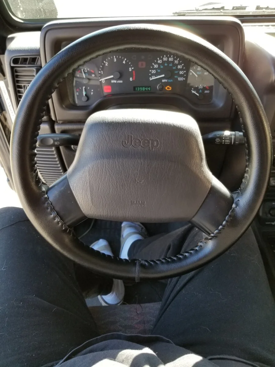

Also sewed a new leather cover on my steering wheel.

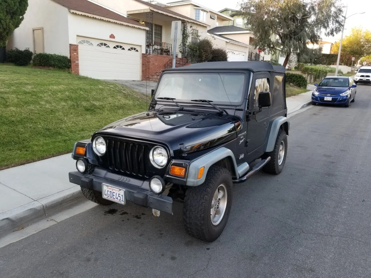

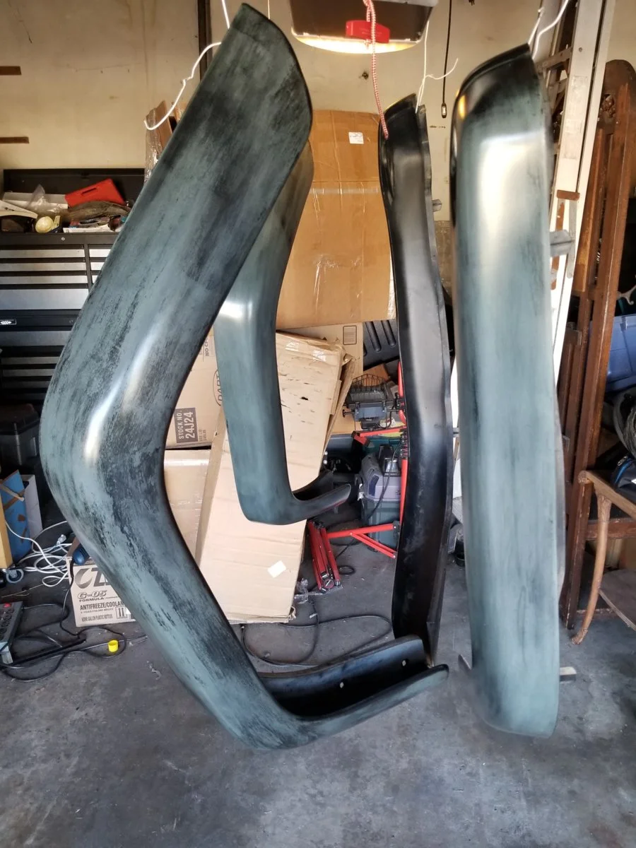

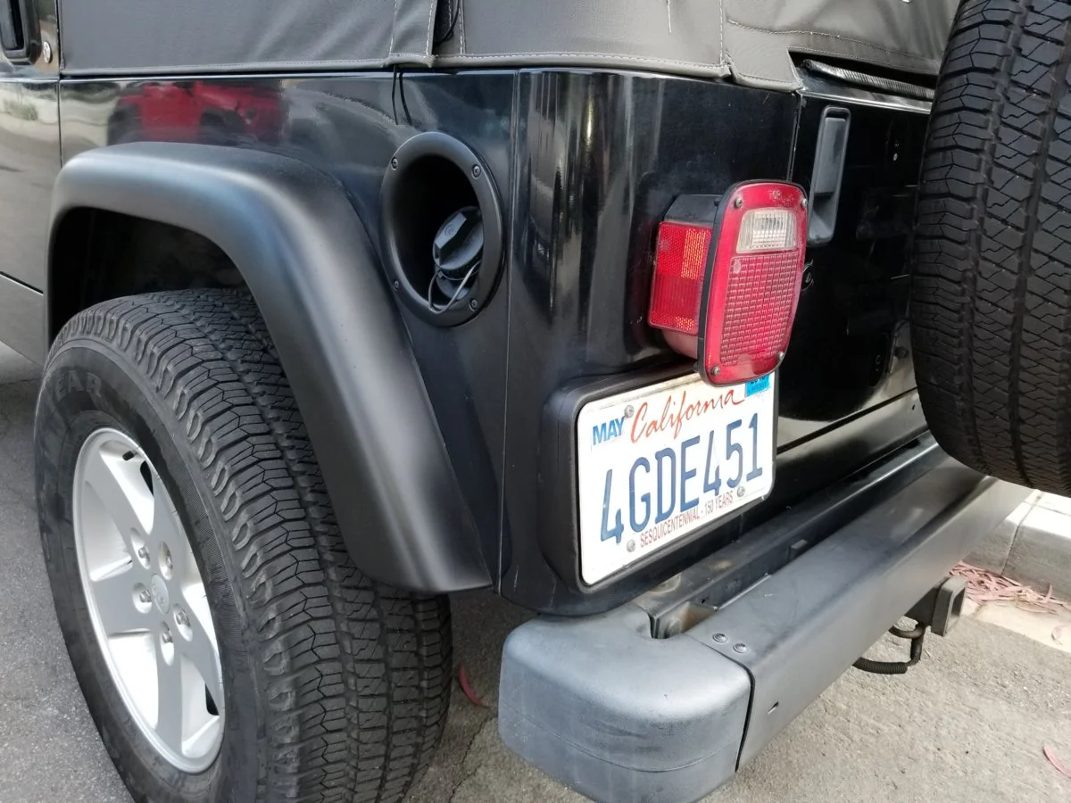

Finally got around to painting the fender flares. The biggest flaw in my Jeep at the moment. They look hideous. They started out that way. All of them were sun faded to the point they were grey/blue. I tried using a plastic dye called Forever Black that had done wonders on every other vehicle I've tried it on. But it does not like Jeep fender flares. The stuff never soaked into the plastic. And just flaked off all over the surface. Making them look like a bad antique-ing job!
@06TJ35's was nice enough to help me out. As my 3 back surgeries hold me back in repairs that require alot of back bending.
We got the flares off on a monday. And I immediately hit them with dawn soap and water, grey automotive scotch brite pads and water. Luckily the plastic dye came right off. I then hit them with adhesion promoter.
I then put 3 to 4 coats of SEM trim black on each flare. This is at a couple coats. Only took one can to do all 6 flares. Biggest advice here is to replacement nozzles for your spray paint cans. The stock nozzles suck. And the replacements (normally used for art) send the spray in a more even flow. And lays more paint on the thing your painting. So you use less paint as well. They also have adjustable fan tips. Just like the ones on the SEM paint cans. But for whatever reason the aftermarket ones are way better.

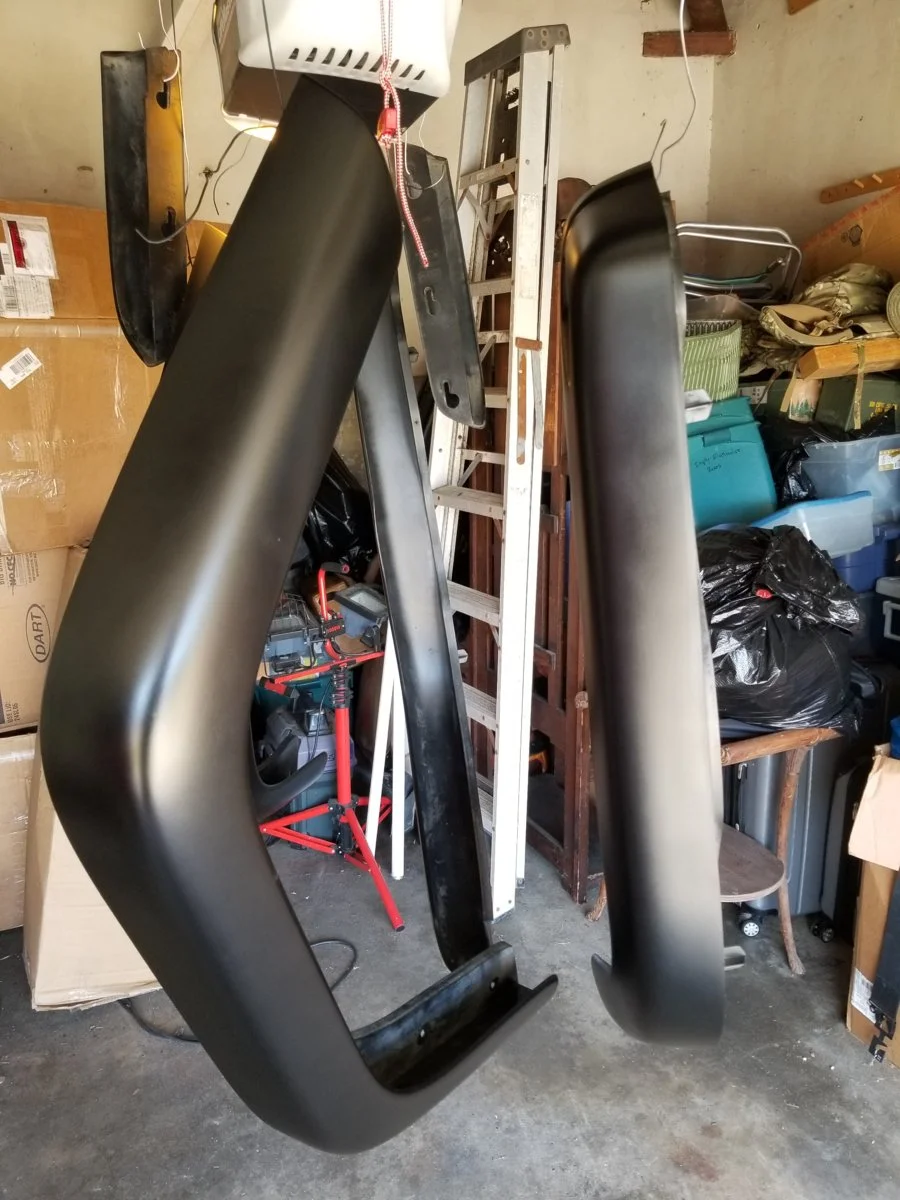

Here they are after a couple coats:
They turned out GREAT! More pics of them on the Jeep tomorrow.

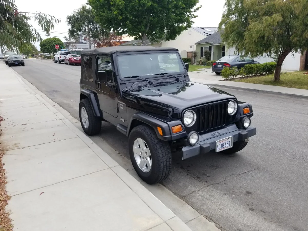

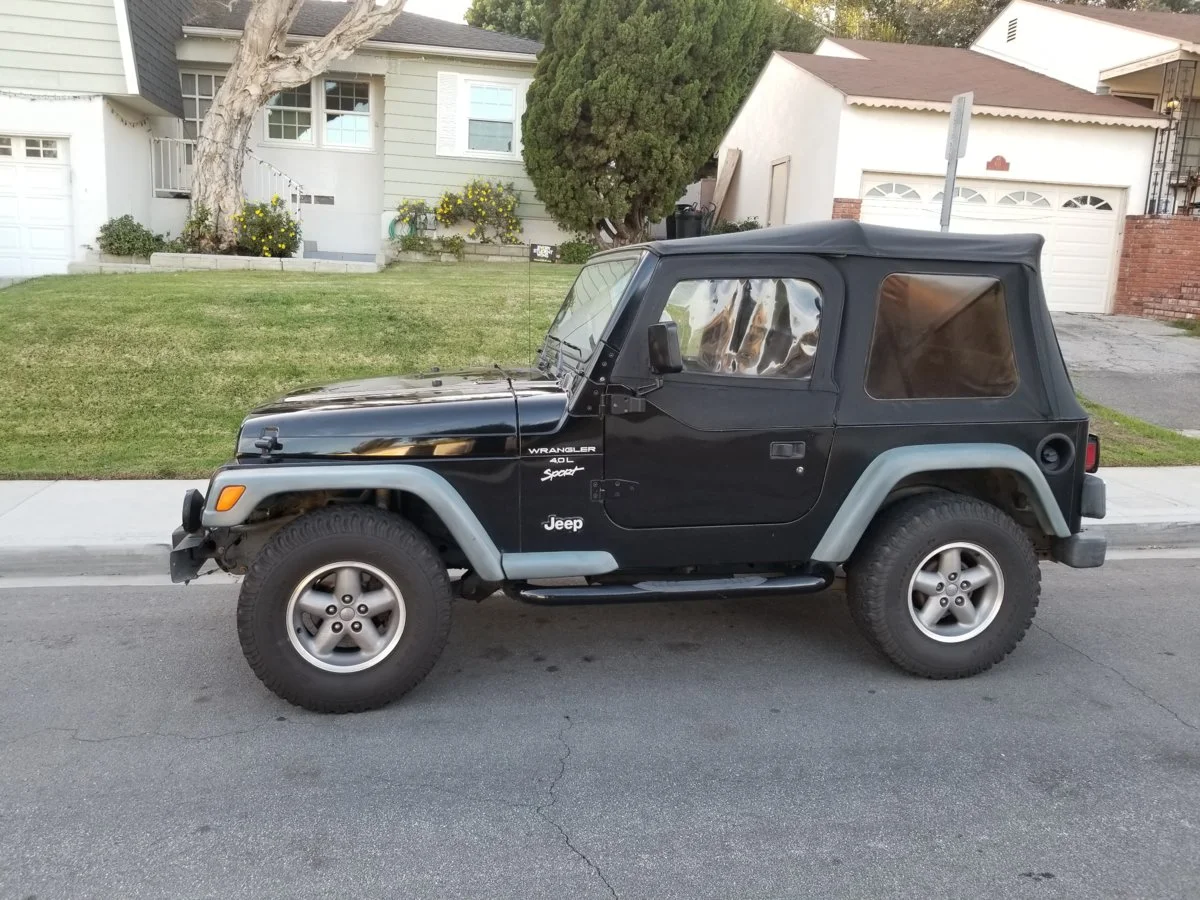

So I got the ugly ass flares painted. And the 80's fat side steps removed. Before and after pics below.
I used less than one can of SEM adhesion promoter and one can of SEM trim black. I prepped them with Dawn, then hit them with grey automotive scotch brite pads and water to get the black dye I tried to use on them off. Then wiped them down with acetone. One coat of adhesion promoter. And 3 to 4 light coats of the SEM trim black. They turned out beautiful. And being in Socal none of the fittings or nutserts were a problem. Not a single spinning bolt.
I'm so happy to have these done. This was the one major thing bothering me about the Jeep since day one. Those blue/grey sun bleached flares just made the whole Jeep look like crap imho. Very happy to have it done.

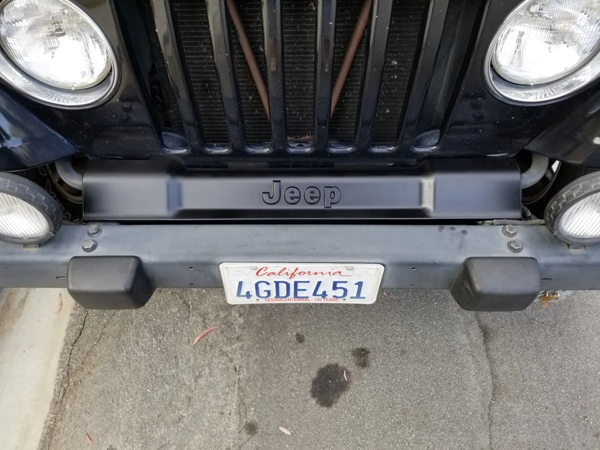

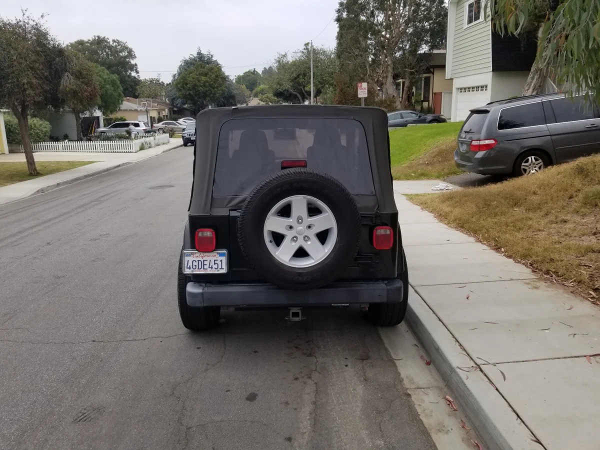

Next up is to replace or repaint the front and rear bumpers. I have a tubular rear bumper with spare tire carrier. But not the matching front tubular bumper yet. If I had both I would just remove the stock bumpers and put the new ones on. But in the meantime I may just paint the old ones. Until I can get the new front bumper.
It's pretty amazing how it's turning out. It was an ugly dog when I started. Sun bleached. And outfitted with so many worn out parts. And sun bleached top, flares and exterior. I think the three best upgrades were - full doors, late model 03-06 seats, and the new Rampage soft top in Khaki.

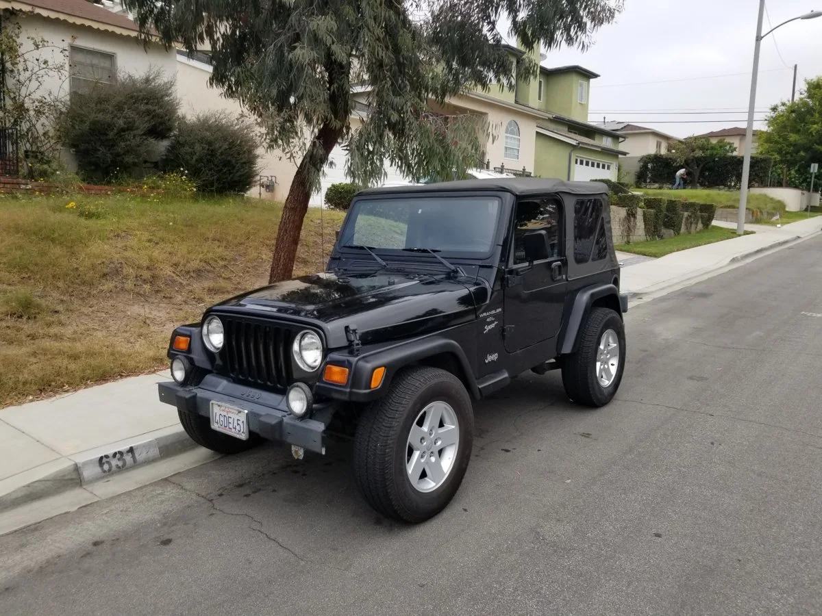

Before all of my improvements to date:
After:
If you didn't know any better, you'd think those flares were brand new!

So today I removed and painted my gas cap ring, license plate holder in the rear and the Jeep cover thing above the front bumper. Hit them with Dawn, acetone and SEM adhesion promoter. This time I actually followed the directions. 15-30 minute dry time for the adhesion promoter. You have to paint within that 15-30 minute window. Then I hit them with three light coats of SEM trim black. 5 Minutes apart.
I think they turned out pretty good. They don't look as good against my faded paint. But once I get it buffed out the whole thing will look very good. I don't know what those white marks are in the pics. But those aren't really there on the license plate holder. Just from lighting I guess. But they looked like complete faded sh*t before. lol.
