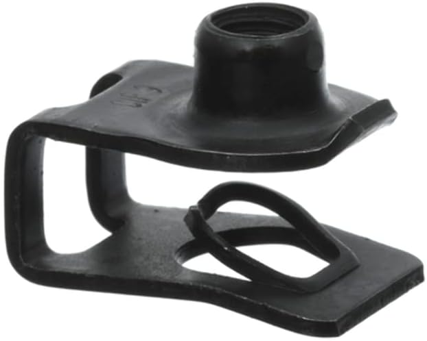

I have sockets like those sunex mentioned above, but i guess they are too fat or the cat is too fat for them to fit around. I was able to find a combo that worked with a short 3/8" wobble extension. Seems the nut on the other side isn't welded to the manifold it's using something like i have pictured here. I applied significant torque in alternating directions but didn't budge. I'm going to break those tabs off before anything. Who thought this design was a good idea?
I'm thinking next step might be to take fenders off for better access and apply heat.
The nuts work just fine.
