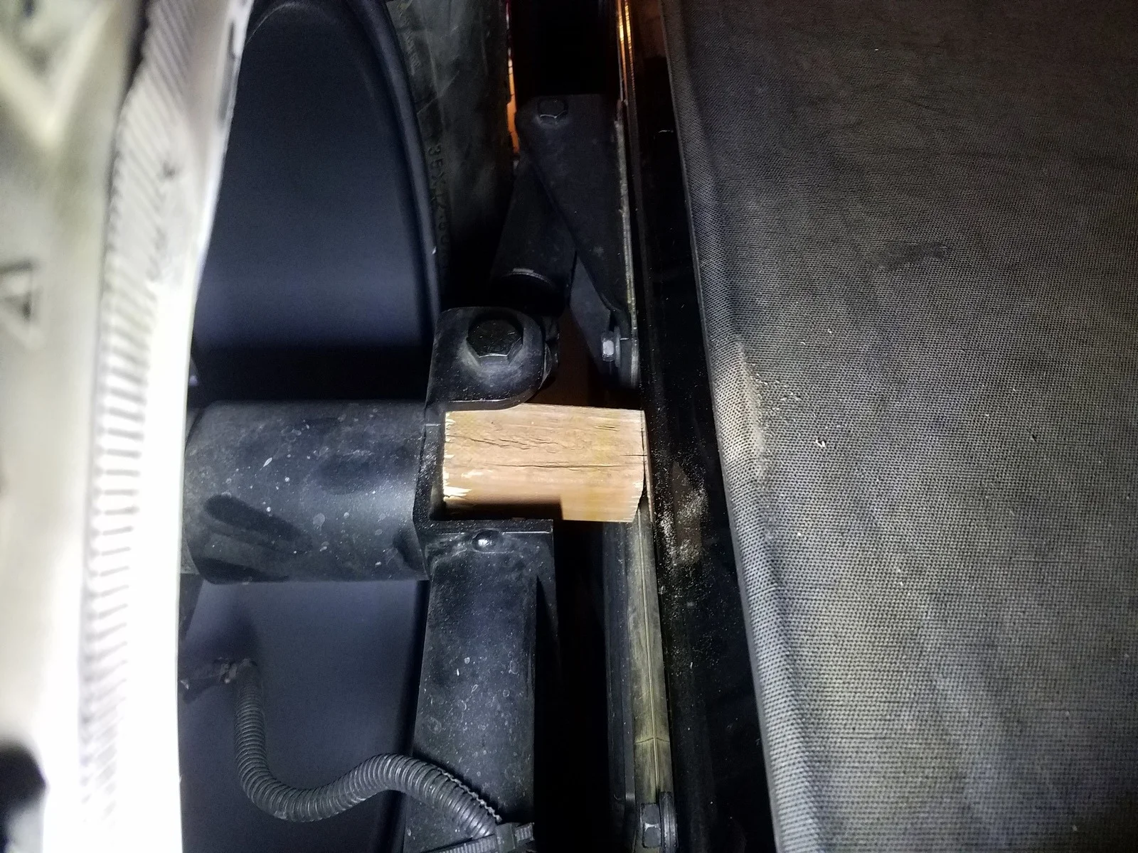

I just swapped wheels on my TJ. They were different enough that I had to readjust the slide mount thingy. Once that is set/tightened to where the tire sits firmly against the carrier, leave it. I never had to adjust that slide mount for years with the previous wheel. I have tightened up on the other carrier adjustment just a couple times to pull it tight against the rubber snubbers.

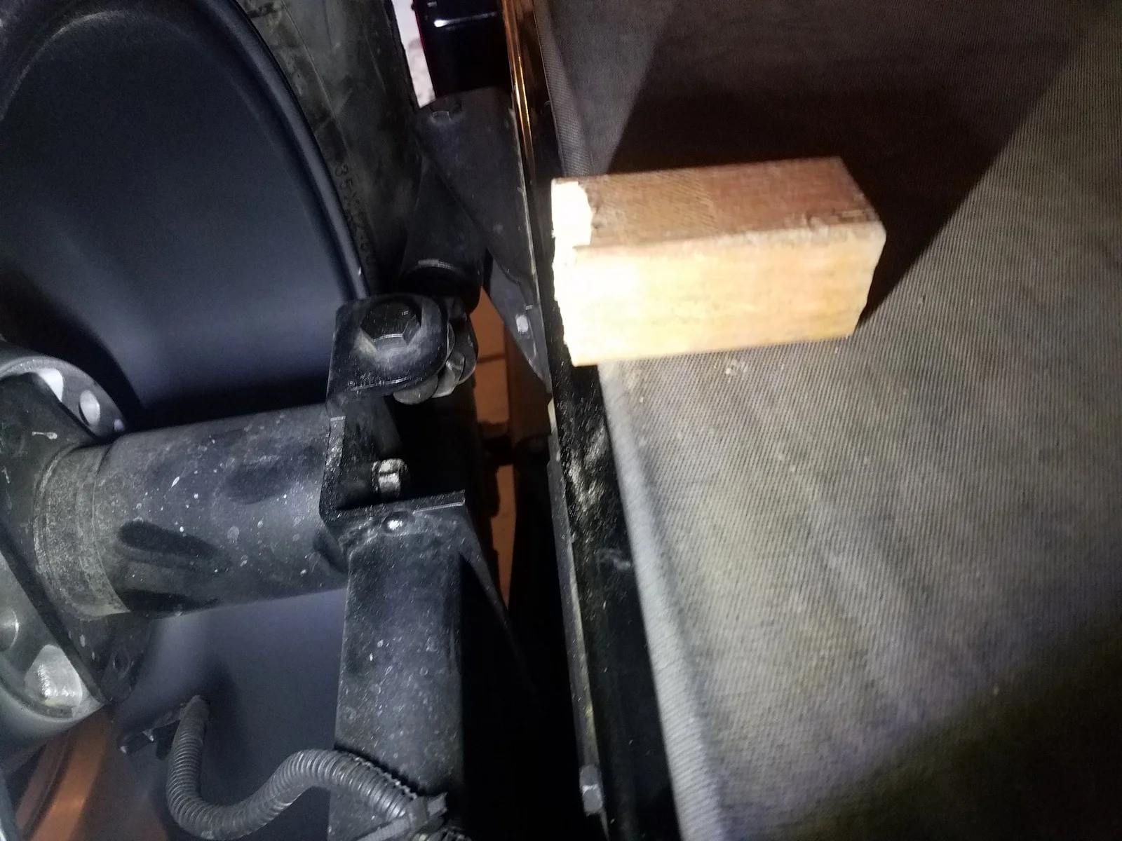

With the tailgate/carrier closed, I use a small piece of 2x2 wood wedged against the tailgate and the slider adjustment bolt to keep it in place while lifting the tire/wheel back on the carrier. Cut a small notch on one end for the bolt to sit in. Those that own the Bestop will know what I'm talking about. I have to make a new one because the one I have is a little short now that I changed that adjustment. I just carry it in the Jeep. Still liking my Bestop carrier after many years.

With the tailgate/carrier closed, I use a small piece of 2x4 wood wedged against the tailgate and the slider adjustment bolt to keep it in place while lifting the tire/wheel back on the carrier. Cut a small notch on one end for the bolt to sit in. Those that own the Bestop will know what I'm talking about. I have to make a new one because the one I have is a little short now that I changed that adjustment. I just carry it in the Jeep. Still liking my Bestop carrier after many years.

An extra set of hands getting it on and all adjusted is a big help. Once it's all set, the wood block works getting the tire on, if you are by yourself.
This is what I use when lifting the tire back on to keep the slider out, so I can start the lug nuts.
2x2, not 2x4. Just made a new one!

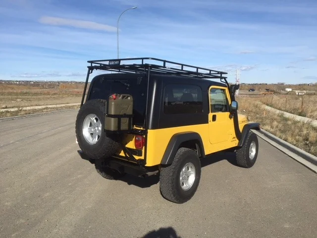

One reason I like the Bestop is that I want to add a mount to carry one 5 gallon jerry can for water. From what I can see, the Bestop is better able to accommodate this than the Exogate is. The can would sit on the top bar near the hinges.
