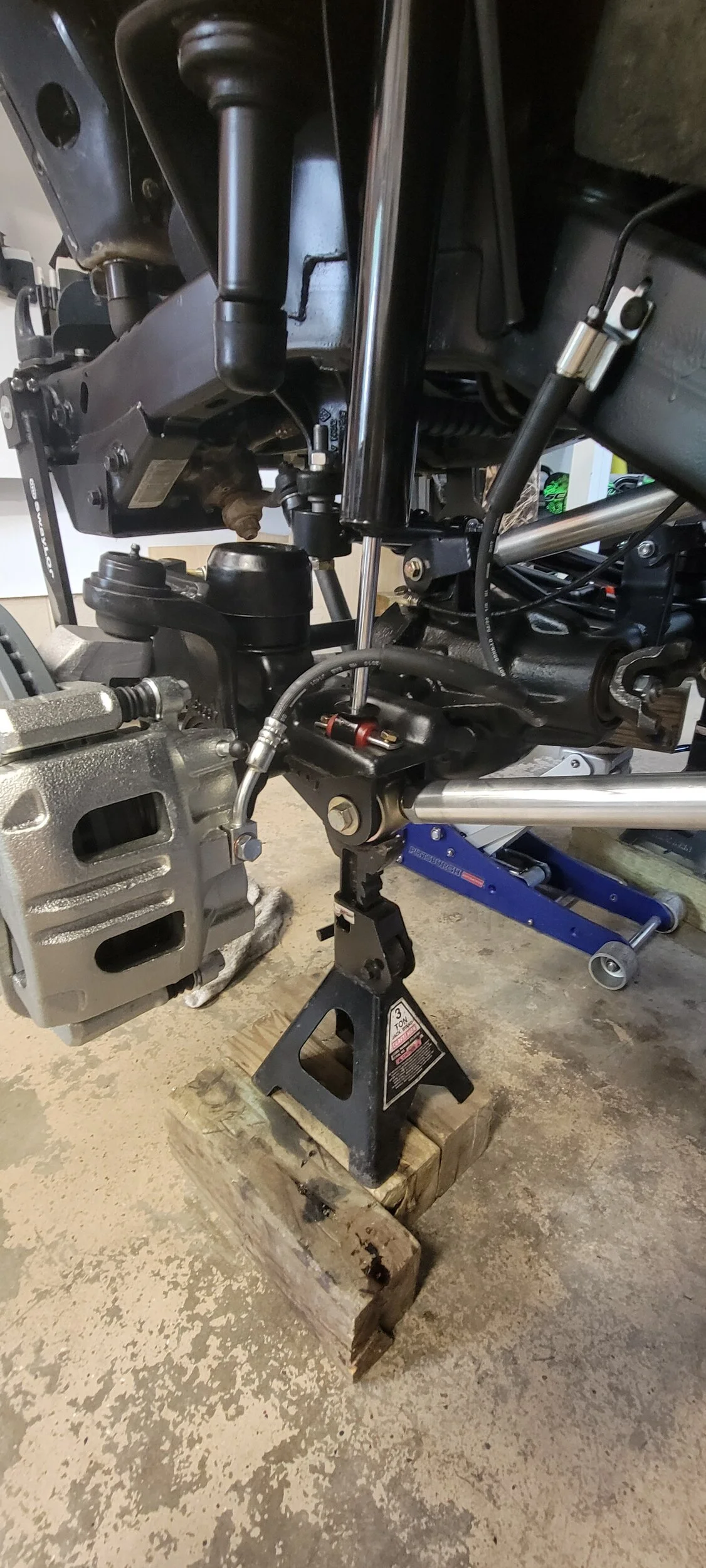

They come with a pair of copper washers. It uses a banjo bolt so you need one on each side of the block the banjo bolt runs through.
Pic below shows it installed, you can see one washer. There is another under that block.
