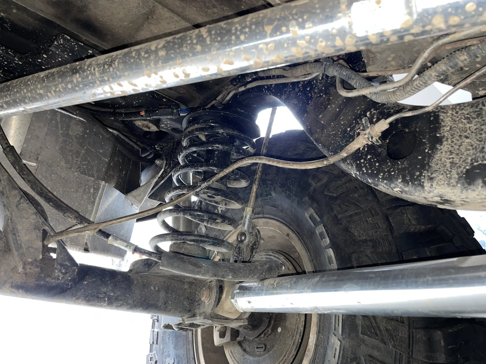

well.. I took it to a shop and they made me this.. not sure if it helps since it is not a "kit" but they have been good for more than one year and I do wheel my TJ..
Reactions: sideproject

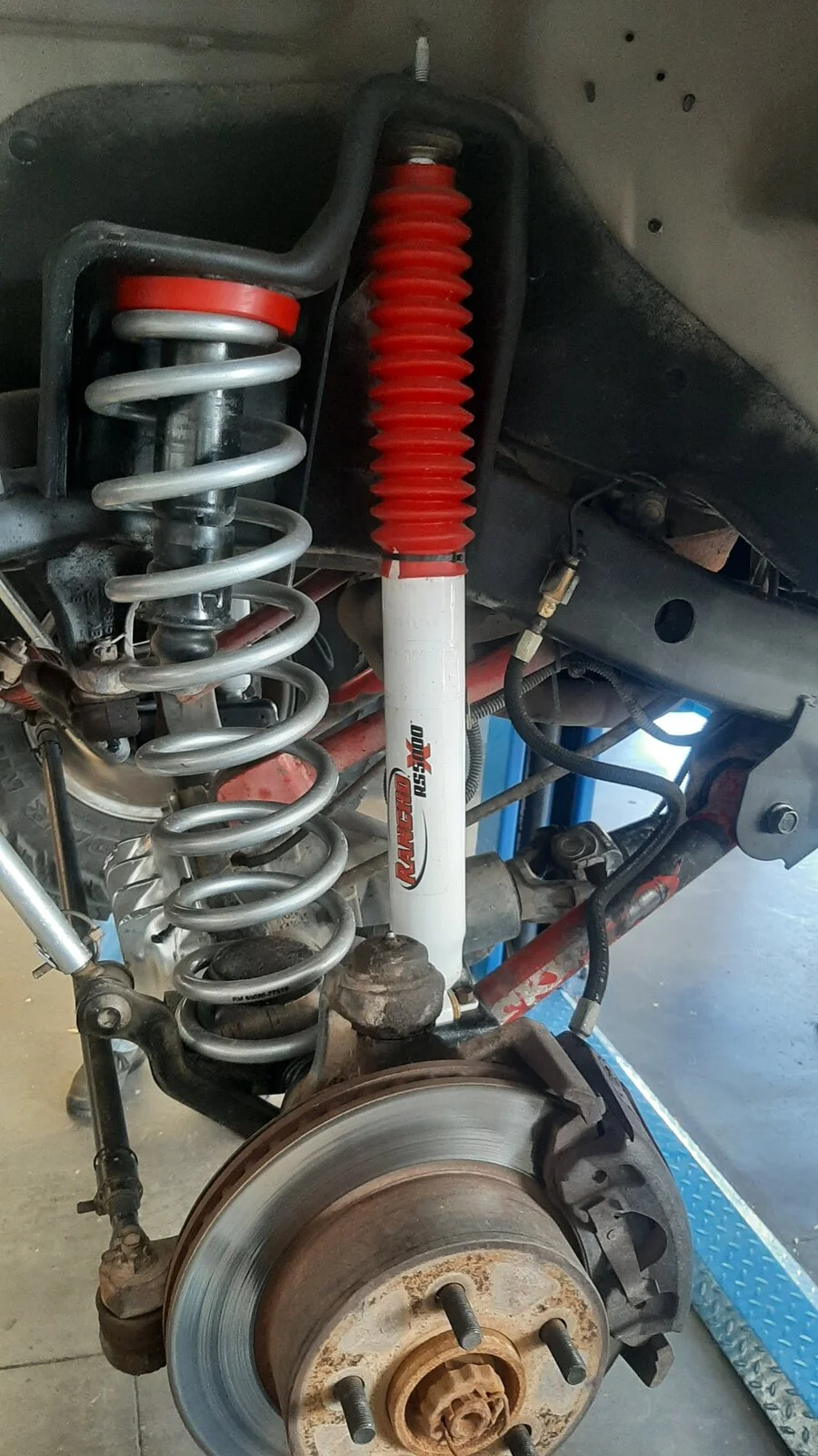

I don't have a picture at the moment, but what I did was straighten out the hard line and welded a new tab closer to the rear axle on my 5" stretch. The extended soft line I already had on there provided plenty of slack for full stuff and full droop. I'll look to get a picture here shortly.
Reactions: 02GreenTJ
Thanks I ended up ordering an extended soft line the other day to do the exact same thing. Your Jeep is good inspiration for my project. I have my stretch tank and am waiting on JJ's for my links then it'll be ready to go.
