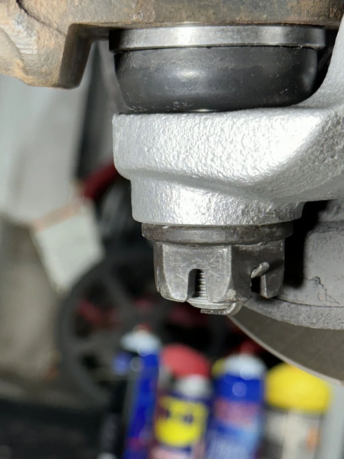

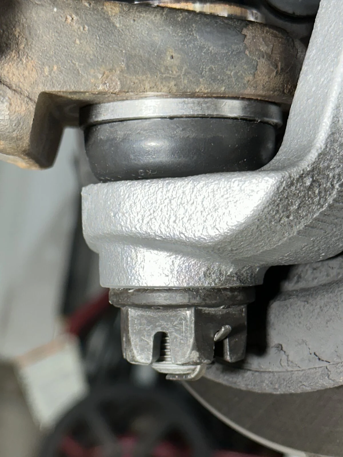

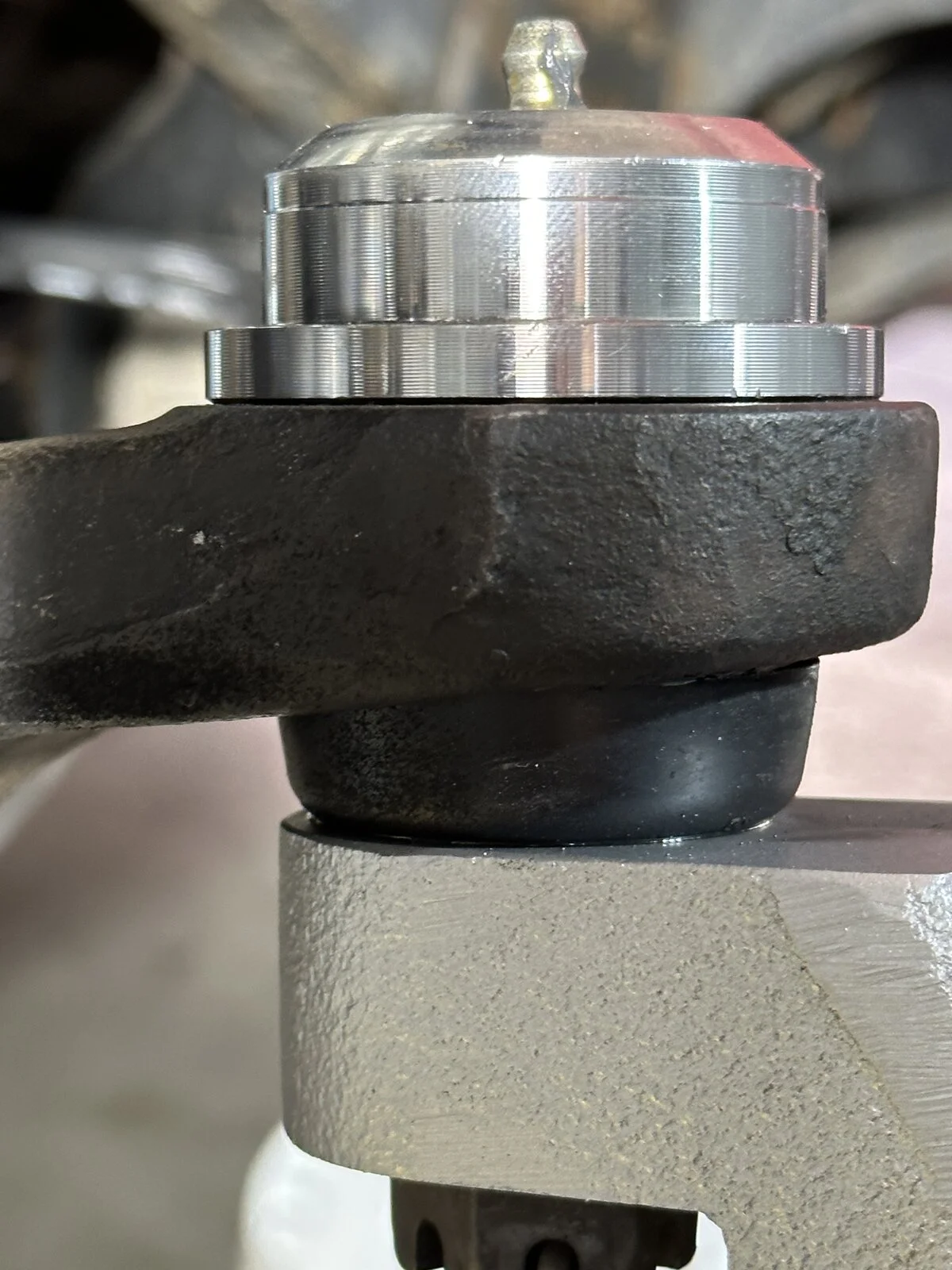

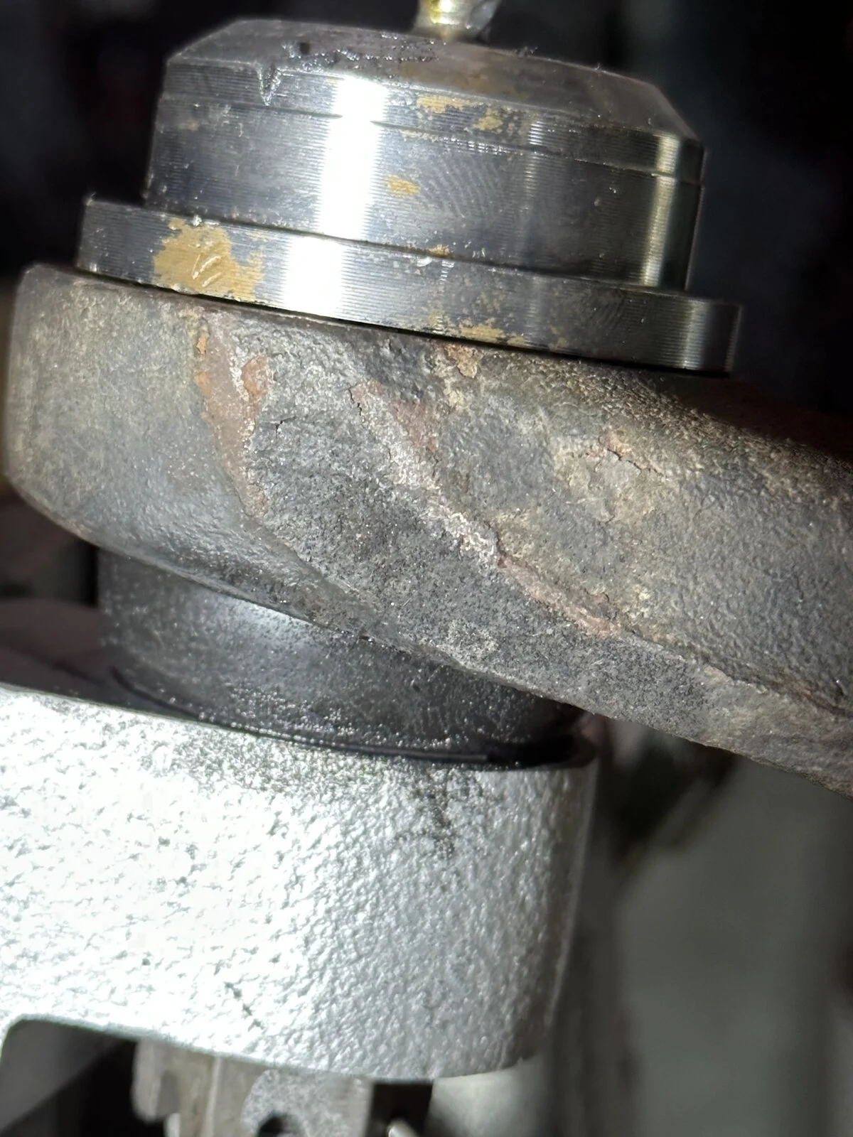

What we need is a good clear pic of the lower showing the shoulder seated all the way around the machined surface it butts up against.
This all makes sense, as soon as I am back at the Jeep tomorrow I will get pictures of the old ball joints and how the new ones are installed. And start checking angles
The ball joints “popped” in further with each crank of the press, until it firmly bottomed out and the press noticeably got very tough to turn. Any further and it felt like I was going to break the press. I was also aware of the shoulders being flush with the C. I really don’t think this is the problem but I will triple check.

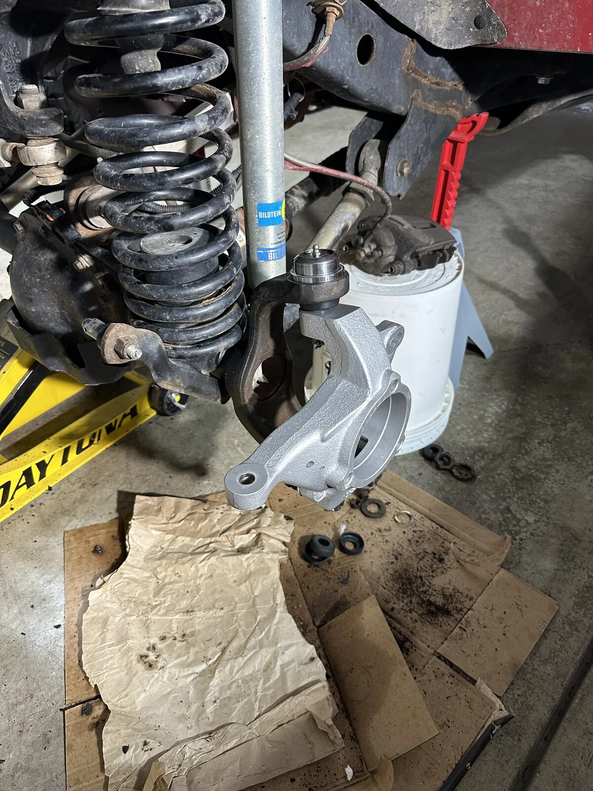

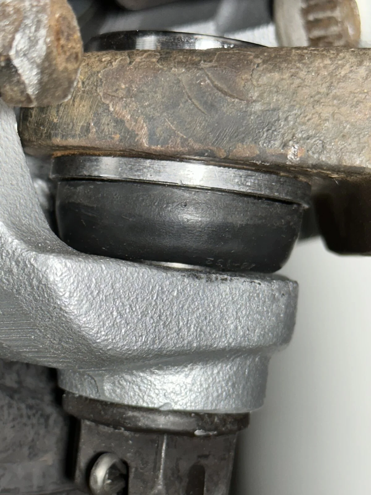

Something is definitely askew but when you look at this pic you can see that the inner C and the knuckle appear to be correctly oriented. Almost like the ball joints are being dumb once weight is being applied to them.
That looks as in appears to be exactly how it should look at that point in the installation. With as much camber shift as we are seeing, I would expect it to show up here and I just don't see it. Not even remotely saying it isn't there, it just doesn't look like it.

We need a clear picture of the shoulder on the lower where it is next to the notch they machine. Or the inner part.

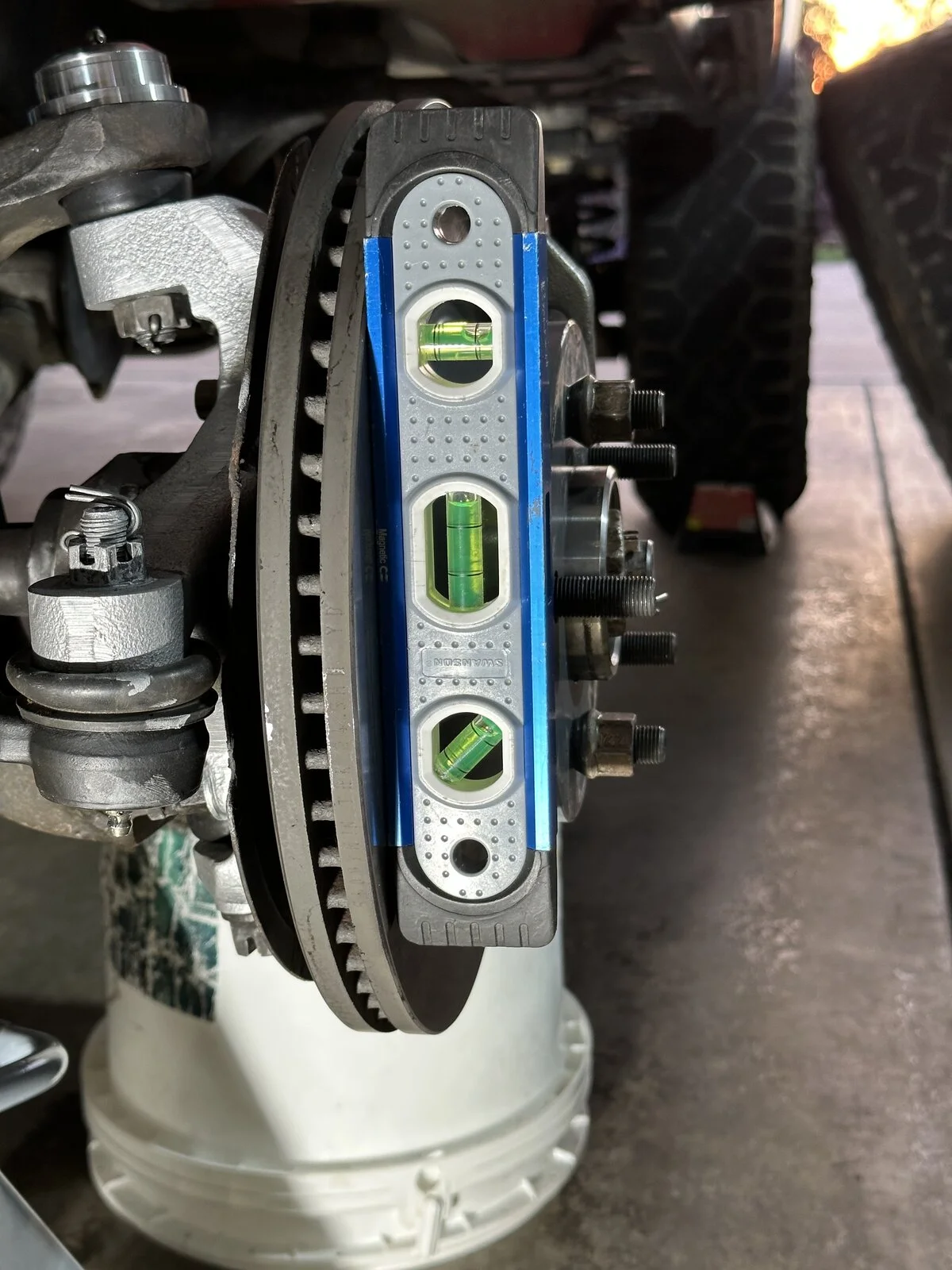

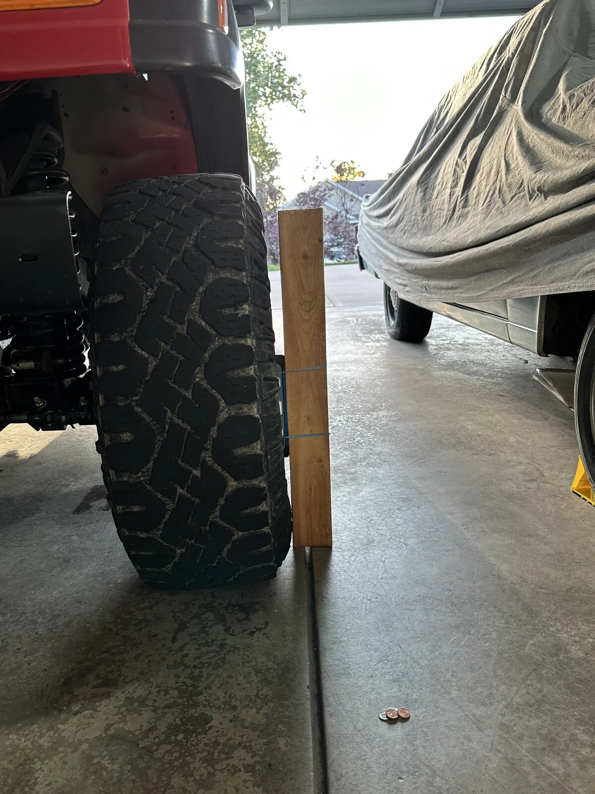

Leveled and straight 2x4 next to tire.
Axle tube dead level with disc seated.

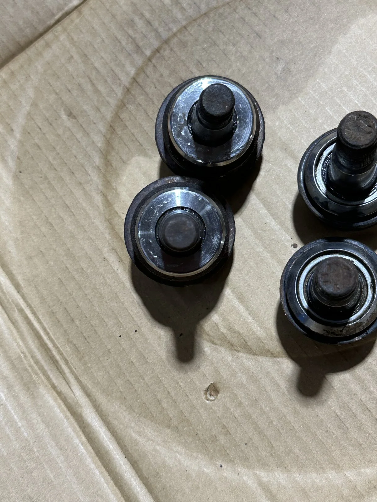

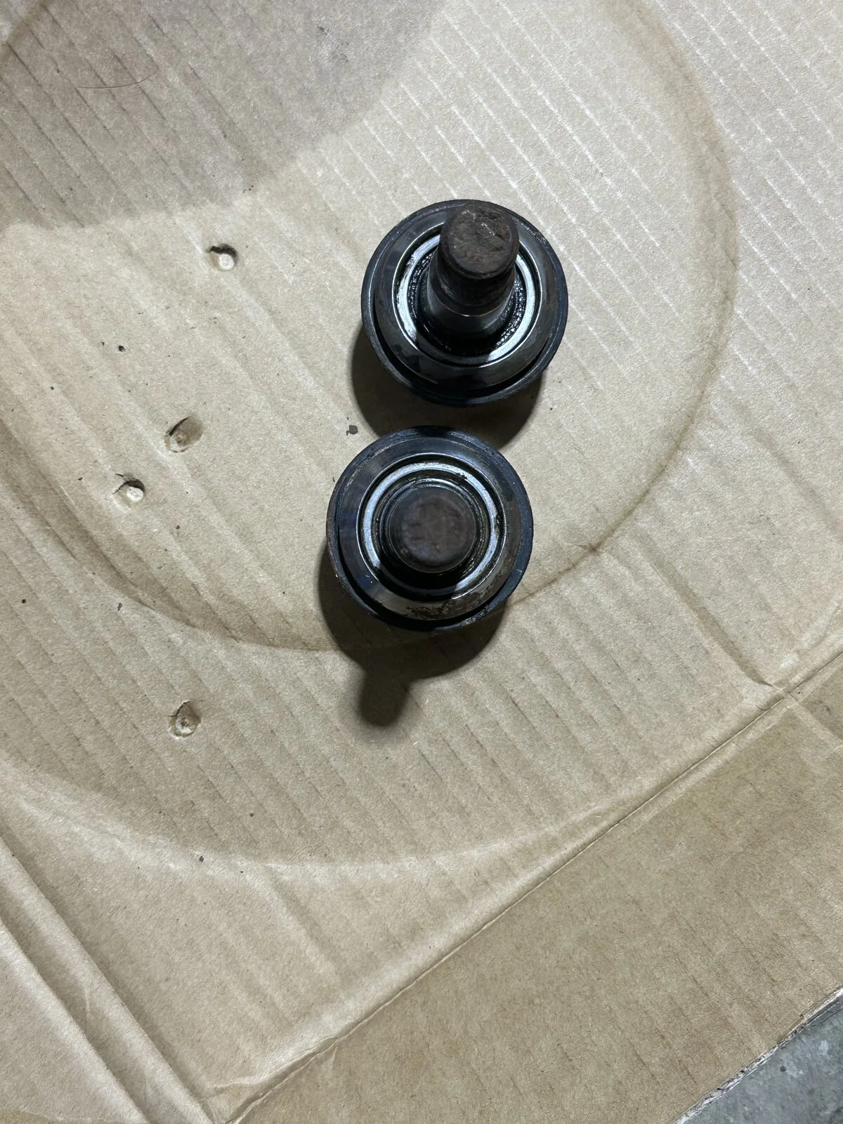

Various pictures of each ball joints

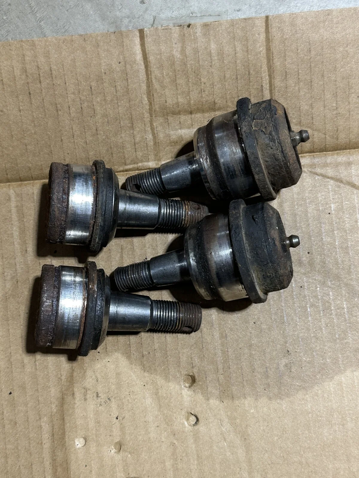

Pictures of old ball joints
Also the brake kit was ordered march of this year. Standing by to take things apart further, but with how far out that tire is, I feel like something would blatantly stand out here.
