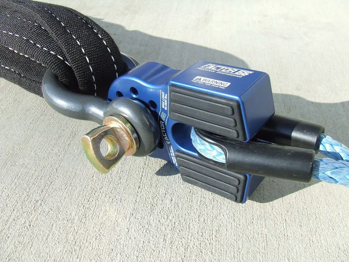

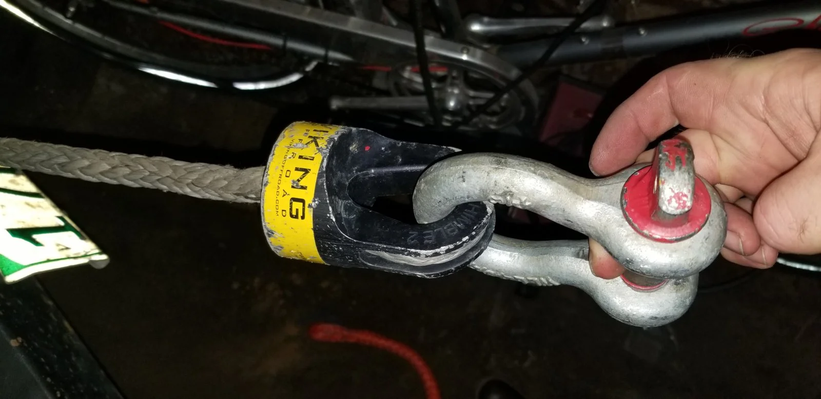

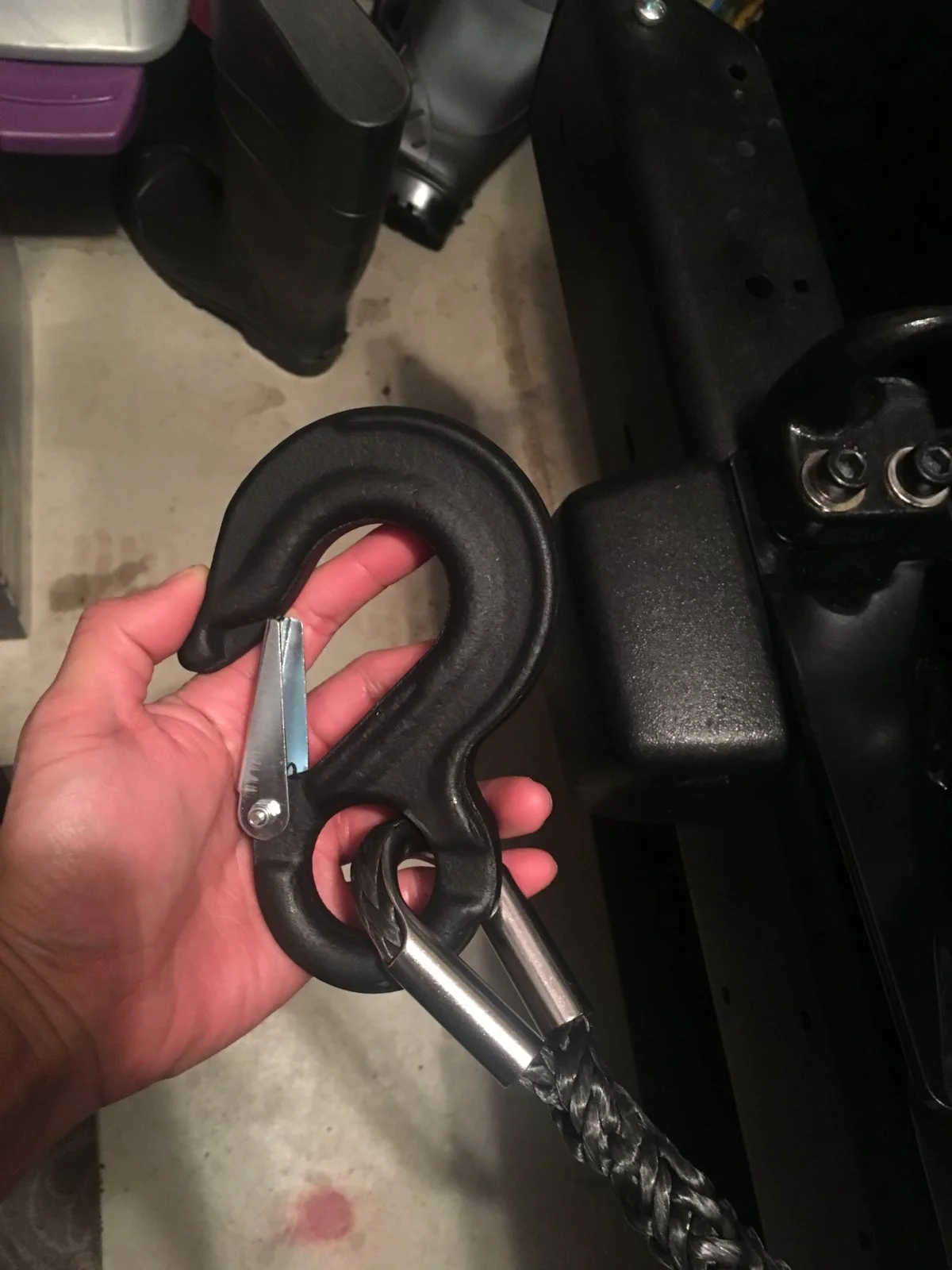

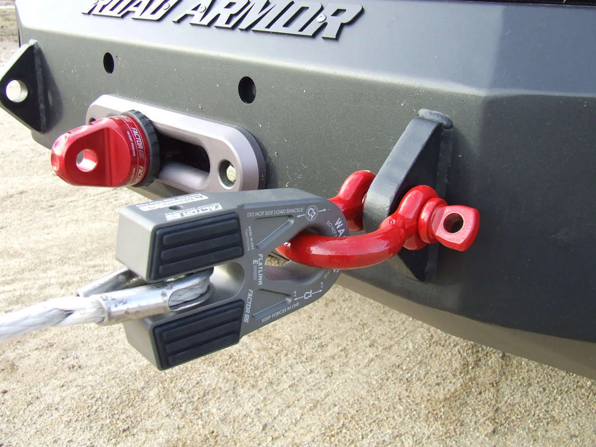

One of the goals of safe rigging is to have only as many connections as is needed to do the job. Is that happening here?
78799
78800
78801
M'kay, good...now it's Quiz Time: explain what you understand about it.
It’s a “closed loop system”.....eliminates rattling....holds snug against fairlead....so forth. Amazon reviews can be sketchy but it got plenty of positive reviews. So I figured I’d ask real opinions.

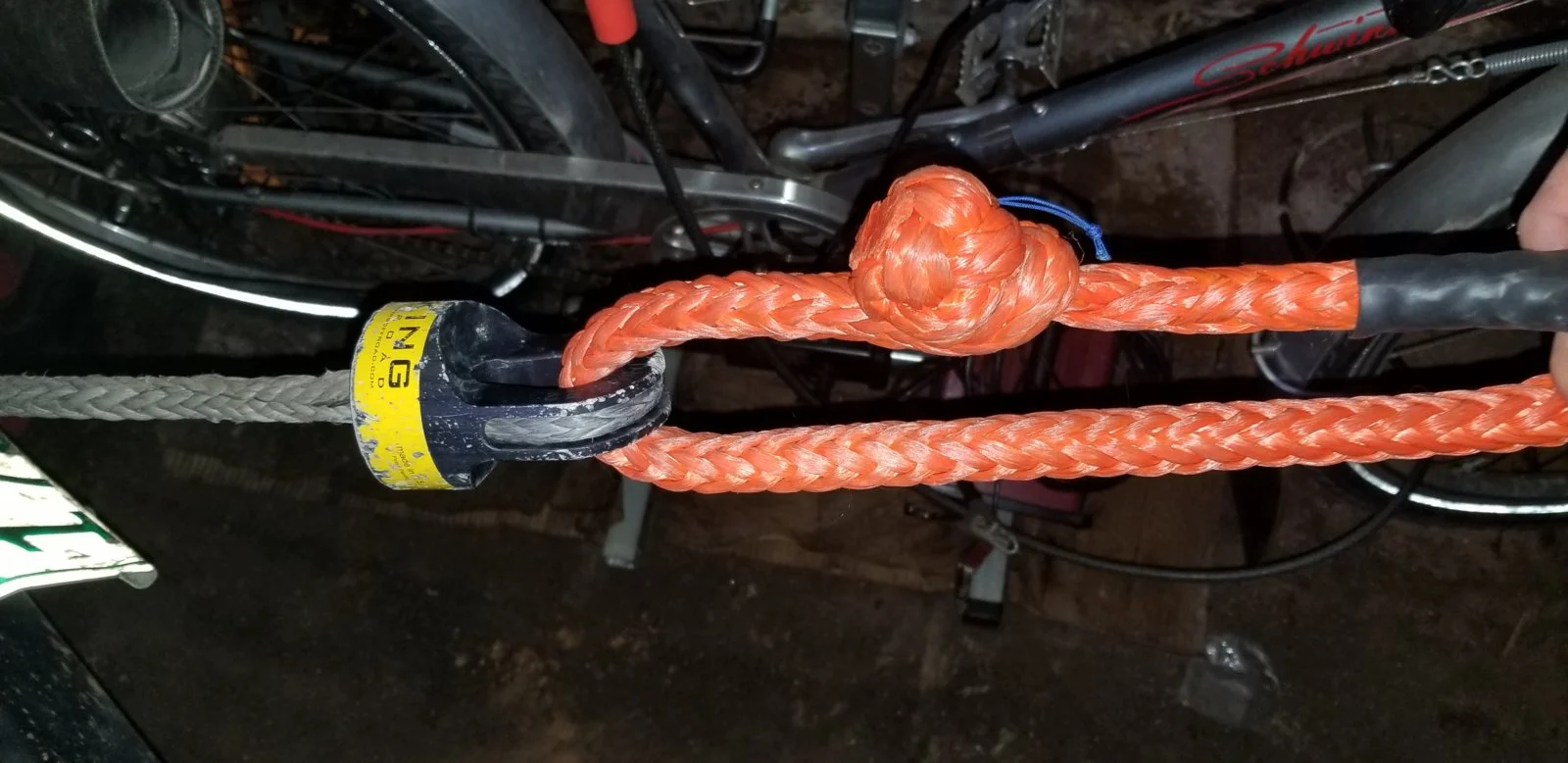

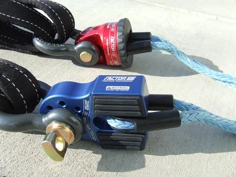

Good. Here are a couple pics to think about. In addition to reducing connections, what if we could make some of those connections soft?

My winch connection looks like this. I guess I don’t have a thimble? I’ve seen those soft shackles. They’re “supposed to” be safer? Or is that just nonsense as well?
You have a thimble. It's the supporting metal loop at the end of the rope. I also have a thimble. And its a thimble that does what F55 pretends to do.
My soft shackles have a breaking strength of 30k lbs. I trust that they are safe for my use.
