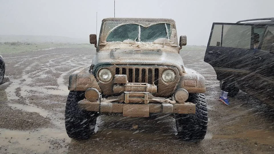

I have steel line and the typical roller fairlead. While not the most glamorous looking, I use a shackle and some big ass washers. The washers keep the shackle snug and protect the rollers and my hand. Also keeps it out of the way so I can mount my license plate to the rollers. Any problems with this setup?
I would ditch the heavy metal shackle and just get a few soft shackles. TRE sells them in sorts of sizes. Just run the soft shackle through the thimble and go from there. You can attach a strap as need be. I'm not sure how well this would work with your specific thimble, but I've looked the one on my old Warn steel cable and it appeared to me as if ditching the hook for a soft shackle through the thimble would work just fine.

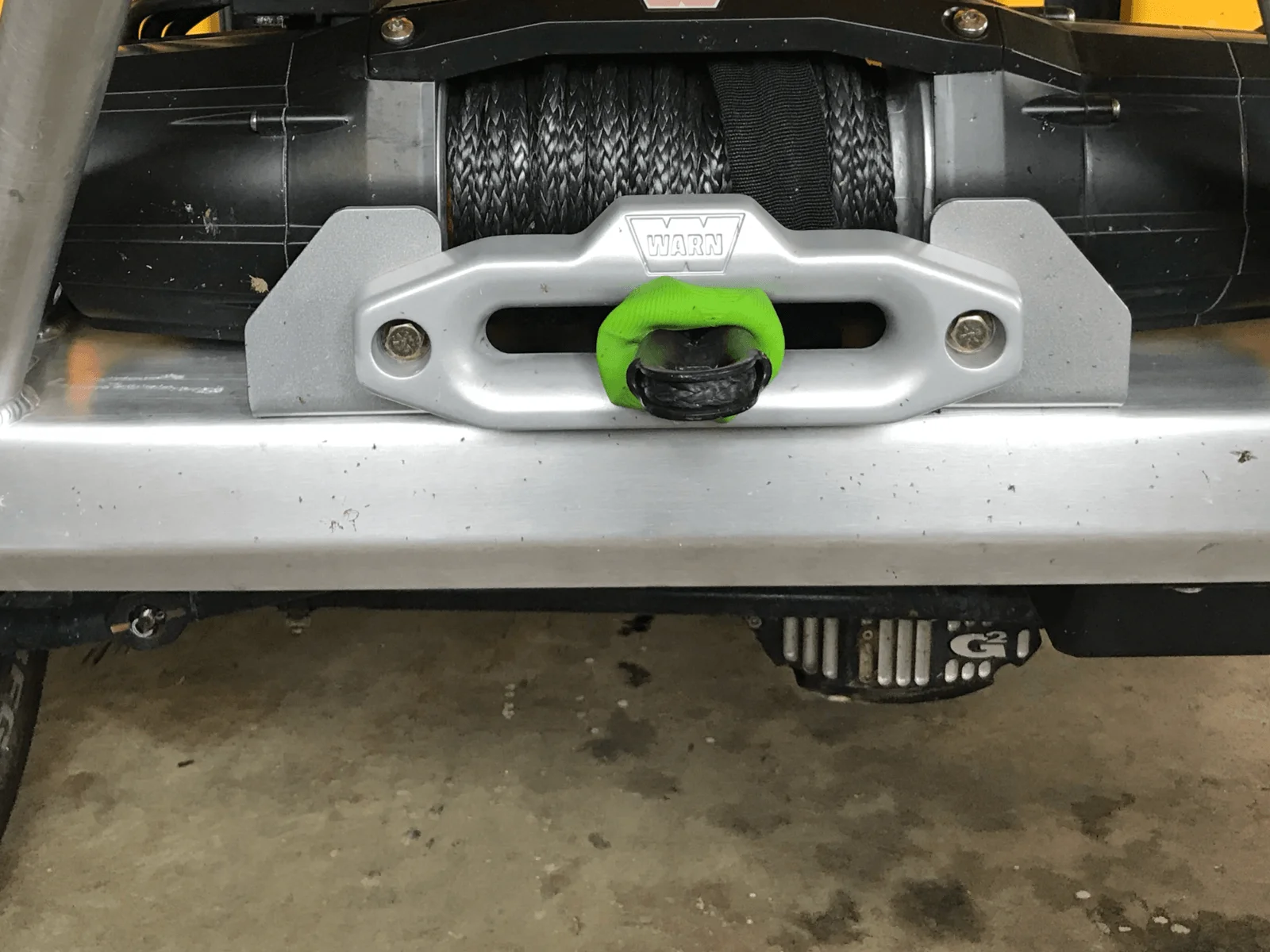

I would need to fashion a way to keep the cable taught while stowed. If one could fashion a backer that butts up against the thimble crimp and acts as a stop to the rollers? I'm picturing drilling a hole thru a hockey puck and feeding thru the length of cable to the thimble.
ftgiles over on JF has posted pics several times of what you are describing.
Get a stock front bumper tow hook, mount it through the two bolts in the photo, and just hook the thimble around it. The hockey puck method would probably work as well, just seems like a lot of effort.
I did something similar when I had a hook. Imagine it would work just as well as a thimble.

Put a HD washer in front of the puck with a ID big enough to slide the cable thru and small enough to make it difficult for the washer to get past the crimped ferrule of the thimble. If you have to toss a line to your helper, you aren't tossing a heavy hook or shackle and the puck could help protect the thimble if line catch gets iffy.

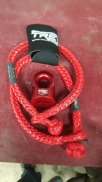

My stuff came in today...
TRE does a nice job with packaging, using a coozie to protect the safety thimble and all. Nice way to give away swag. They also included a plastic Fid...though its not as long as a "normal" fid. It will make the splice easier and I thought it was a nice touch.
79496
